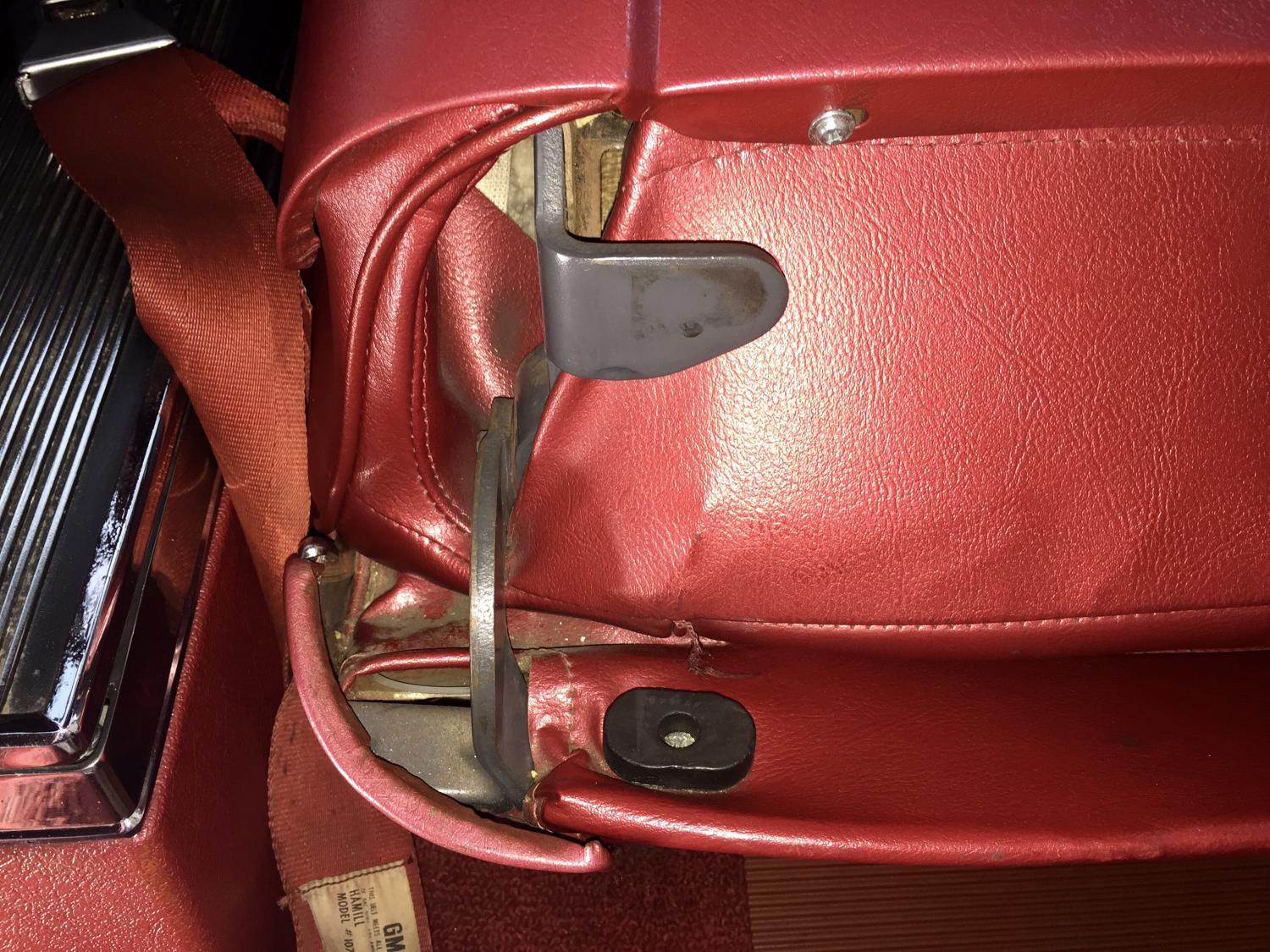

Hey Bruce,
I have a question on the RH bucket seat back in your ‘66.
When you fold the upper seat back forward is there a odd bumper with a spring steel catch device?
My ‘66 GTO Survivor has this item.
Some type of safety feature (won’t allow the seat back to fold forward when unoccupied in a panic stop) before the 67 seat back lock came out.
It seems not all the 66 GM cars have this.
LMK, thanks, Chris.

Originally Posted by 60sStuff View Post
Hey Bruce,
LMK, thanks, Chris.
Yes mine has that clip on passenger bucket seat.
