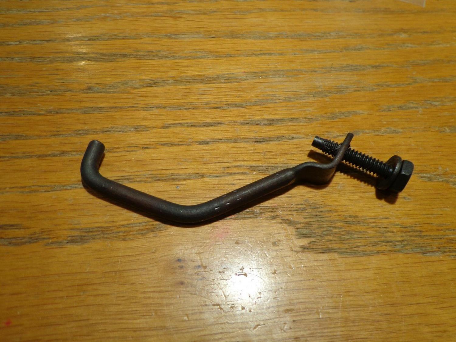

Dave, do you recall ever seeing this J-hook contraption anywhere in the parts or did the heater box come in pieces? It's the J-hook that holds it up into the cowl. (Before I order a new one, I figured I'd ask since I don't see it anywhere.)
It goes where the arrow is.

Good catch Steve!
People never seem to put those back in after removing the box.

Nope... no J-hook Steve. Never saw one when I removed the box.

No problem. Got one on the way.
