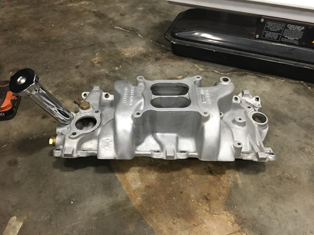

Here is the intake before and after on my survivor LT1.
~JAG~
NCRS#65120
NUMEROUS Lemans blue Camaros,
& a Chevelle or two...
The Following 2 Users Say Thank You to firstgenaddict For This Useful Post:
cook_dw (11-25-2020), SeattleCarGuy (11-25-2020)
