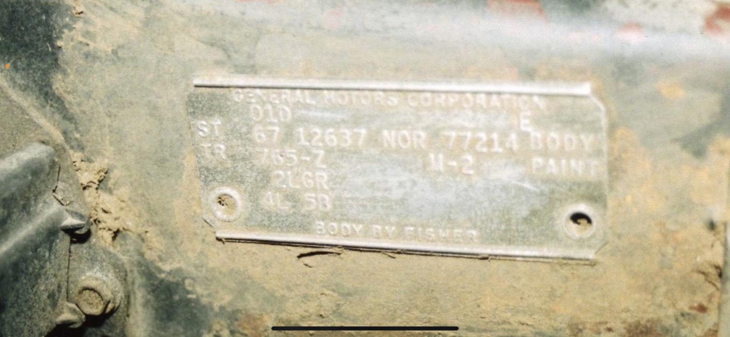

*BUYER BEWARE: There have been accusations that this car was not born a Royal Plum car and that it was not born an original Z28

I got a email from Ken Boje last night explaining that he bought this car years ago after he sold Lil Hoss. Discovered vin welded in and a bunch of other stuff and returned it. Included screen shots of when it sold on Ebay as a old drag car with no engine or trans.

Yep, there's a very sketchy past to this car. My client hired me to inspect the car last month and the report was very revealing about the car being bogus. My report listed the car as a rebodied recreation of a 67 Z28 with a fake trim tag and re-stamped drivetrain. Along with that the hidden Vin stamping in the cowl being cut out of the original car and installed in this body.
A total train wreck. The seller told the current owner to sell it at Mecum and whatever the difference in money is he will reimburse him. No need to contact Mecum.

I was told this was the trim tag and the car when it was initially found in a field.

Bottom line is Boje owned it and documented it as a fake. He notified Mecum and Mecum added the language. Not sure how Jerry telling him he doesn't need to tell Mecum helps the hobby.
