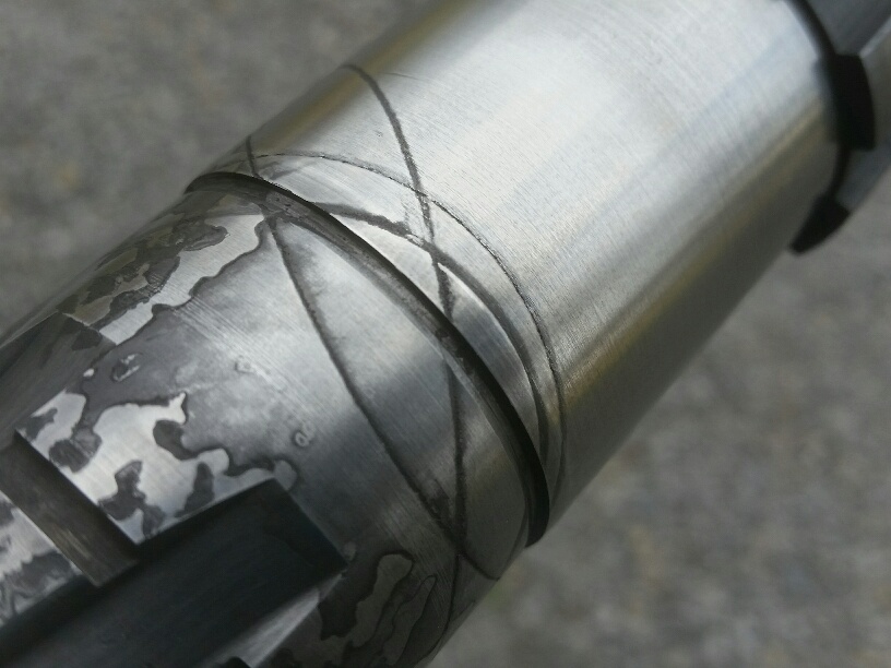

  #50
Old 12-13-2020, 02:34 PM
big gear head's Avatar
Join Date: Mar 2012
Location: KY
Posts: 3,373
Thanks: 5,621
Thanked 1,451 Times in 763 Posts
This Muncie main shaft was not completely submerged, and the Evaporust cut into it at the surface. You can see where I took it out a few times to look at it and put it back in in a different position.
