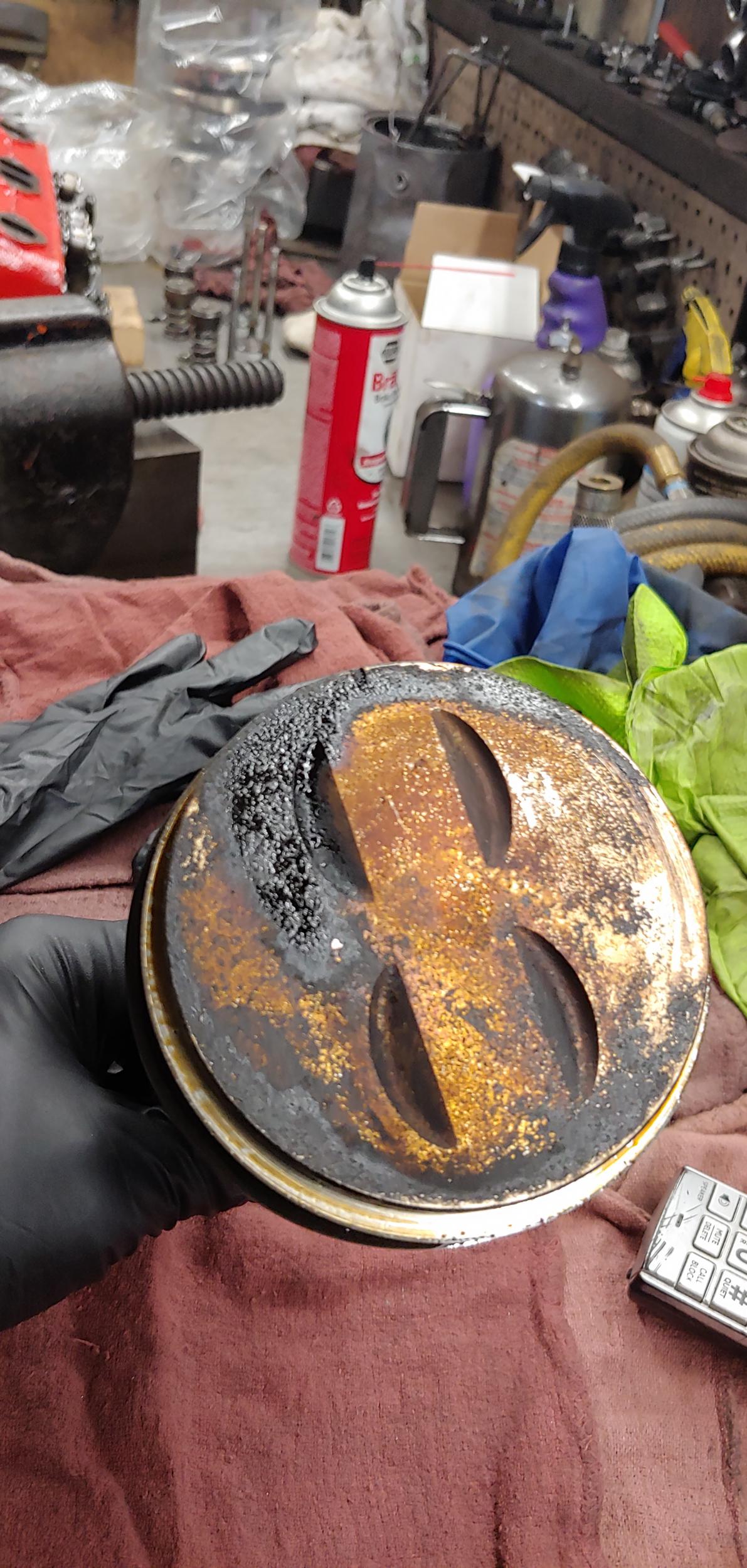

This is a stock rebuild of a 250hp 327 (owned by a friend). The engine only has 100mi on it and it was pulled due to a severe vibration. I can see that the exhaust valves show signs of over heating, but I'm not sure what the deposits are on the pistons. Maybe it's running so lean that it's melting the aluminum? He says the plugs are "clean". He was using Sta-Bil in the gas.
Any ideas anyone?
Verne

The vibration might have been severe detonation, but that should have cracked the ceramic in the plugs. It does look lean, but I'm no expert.

I can ask for a pic of the plugs. He said the vibration starts at about 1200rpm and gets worst up to about 35-40mph. He can feel it in the seat and it's bad. He said all the normal suspects have been checked, ie: tire balance, driveshaft, pulleys. The mechanic said he checked the crank and its good.
Right now my question is what caused the appearance on the piston?? The mechanic says the problem is the gas and the carb and that's why he was referred to me. But I disagree that a carb problem would cause a vibration. Maybe a miss or hesitation, but not an actual vibration.

Catastrophic Engine destroying detonation can be heard from the roadside when occurring on a passing vehicle.
WOW those valves look overheated.
Piston looks like cooked on oil -
a flat top in a 250 hp 327 hard to believe there were detonation.

The black stuff looks like deposits from octane booster. You wouldn't think it would need octane booster with flat tops. Can't imagine he put enough Sta-bil in there to cause deposits.
Pretty easy to isolate engine vibrations from anything else. If it is in the engine, it will vibrate with the car sitting still. If you suspect driveline, turning the engine off while coasting in neutral will eliminate the engine.
