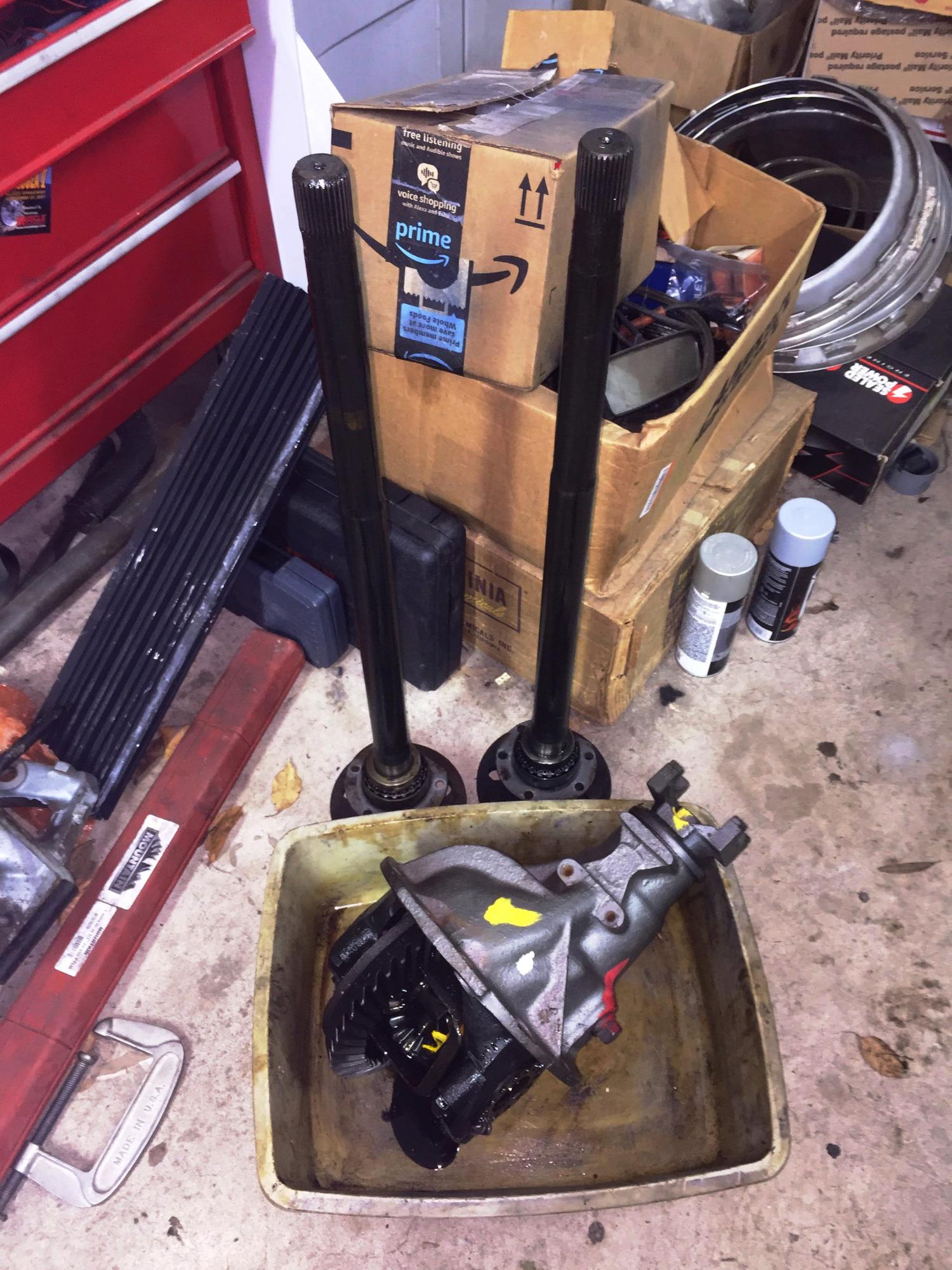

I started on the rear differential. It is a 3.23 open and I wanted to at least put in Sure-Grip unit and replace the half-century-old bearings. I was considering upping the ratio to a 3.55 but after discussing it with Cass at DoctorDiff.com he said to stick with the 3.23's. The amount of change would be negligable. The reasoning was that a 3.23 running relatively short 26.45" tall F70x14 tires will be running almost the same rpms as a set of 3.55's with a set of 28" 275/60x15 tires. A real gear change like a 3.73 or 3.90 would result in some actual seat of the pants gains but I am looking for a crusier not a quarter miler with this build.
So essentially I already have the actual performance of a 3.55 with the shorter 14" tires.
So I am ordering a new Sure-Grip "Powr-Lok" unit and the install kit and axle bearings as well. https://www.doctordiff.com/8-3-4-clu...-powr-lok.html

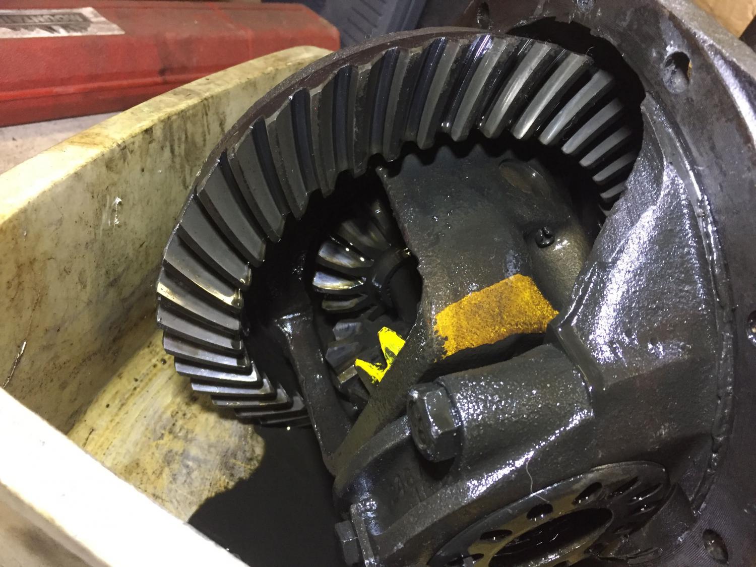

Here's the smelly parts after I got eveything out today. The gear lube was dark but smooth. I had a piquant bouquet with thankfully, no metallic notes. The pattern looked nice.
Looks like the gear set is dated 5/21/1970 and a 1971 casting date on the housing. It appears to be a 29 spline pinion - it takes a 1-1/4 socket on the pinion nut.

Be sure to measure the backlash BEFORE you disassemble it so you will know how to set it when you put it back together. Also do a pattern check with gear marking compound before you take it apart, and take pictures of the pattern. That way you will know if the pinion depth changed when you installed the new bearings.

Setting up rear end gears is a magic that I don't have the skill (or tools) for. I will bring them to the local guys in town that set up my other rear ends. They did a great job with the Pontiac 10-bolts I had them do.

Turns out the guys that I was going to have set up the gears closed up shop and retired earlier this year. So I will be bring the parts to Bontempo Brothers Competition (BBC) Speed Shop in Linden, NJ. Great shop, right out of the 1970’s. It’s just a much longer drive than my earlier choice. I had them do the 10-bolt from my 1972 Trans Am, fifteen years ago.
