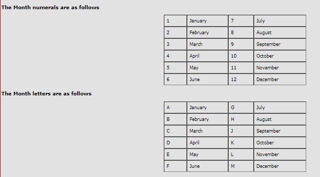

Isn't "C" the month date code for March when it comes to casting dates?
"C" would be December on a fender tag, though. (My old hemi Charger was built on "C08" - Monday, Decmber 8th, 1969)

Chrysler uses a finite-but-numerous variety of date coding scenarios, in combination, or, alone. Some use the letters exactly as you have listed. Others use numerals:
1-January
2-February
3-March
4-April
5-May
6-June
7-July
8-August
9-September
10-October
11-November
12-December
SPDs (Scheduled Production Dates) use:
1-January
2-February
3-March
4-April
5-May
6-June
7-July
8-August
9-September
A-October
B-November
C-December
I know that Dana rear ends list numerical dates on the axle tubes (i.e.: 4 15 70 = April 15, 1970), but, having not had a car with an 8-¾" in a while, I'm not absolutely certain what the casting date protocol for the carrier assembly is. (Further research may turn up an answer, or, perhaps, someone on the Forum may know!) That's why I said "MAY," and, "truly tentative." It would seem logical that that first character should be a numeral, and, not a letter. I put "C" because that's what it appeared to be to me in the photo, as well as I could ascertain.
Month/Year date codes, as you mentioned, re: the jack, are definitely common, so as you stated "C 0" (or, 0 C?) is March 1970! Perfect! …But, usually, they appear as in you example. I don't recall having seen any Alpha/Numeric (such as "C 0") utilized in lengthier ways (such as "C 9 70"), which is why I went "out on a limb" (axle tube?), so to speak, and, translated it into the "other" alpha possibility. If you are able to tell what that first character is, we may arrive at a better (and, more accurate) answer.

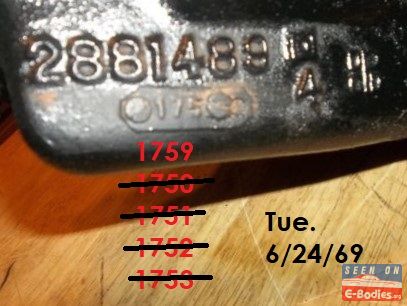

It looks like my 8-3/4 carrier has an alternate casting date location in a different spot than the traditional version, which used a julian calender number right alongside the "489" casting number line.
