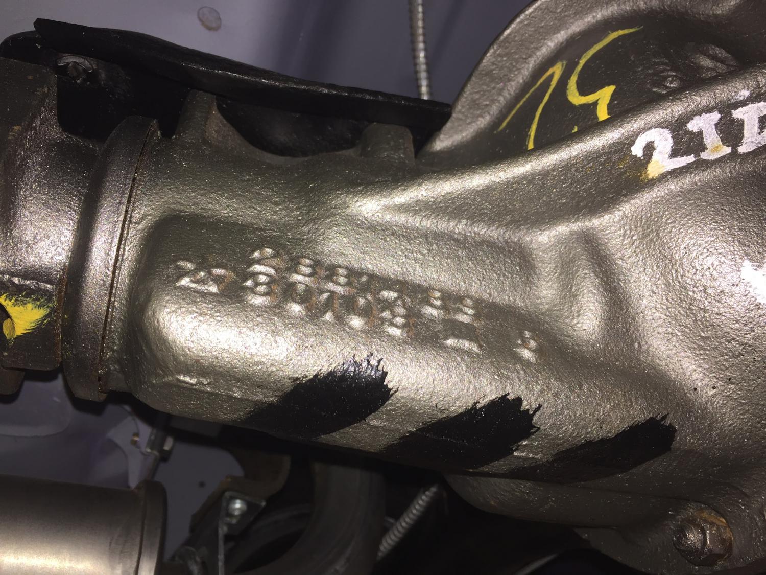

In your post #902 on p. 91, you mentioned, and, posted a pic of, the rear ring gear date (5-21-70), as well as showing the carrier (“pumpkin”) casting date, which is, as is sometimes the case (pun intended), rather indistinct. At the time, ya thought that it showed a ’71 date code, however, after playing with a photo you posted, and, running it through several filters (as well as adjusting the size), it appears that it MAY say “C 9 70,” ‘cause that final digit looks much more like an incomplete zero, than a one. Since the casting dates can be indistinct smooshes (either in whole, or, in part) I’m truly tentative about the “C” part! (That could translate to December 9, 1970.) If you can locate an axle housing date code, that may be helpful, as well, however, unless there’s date code “harmony,” they still may not agree, ‘cause of the mix ’n’ match nature of the separate pieces.

I know that Dana rear ends list numerical dates on the axle tubes (i.e.: 4 15 70 = April 15, 1970), but, having not had a car with an 8-¾" in a while, I'm not absolutely certain what the casting date protocol for the carrier assembly is. (Further research may turn up an answer, or, perhaps, someone on the Forum may know!) That's why I said "MAY," and, "truly tentative." It would seem logical that that first character should be a numeral, and, not a letter. I put "C" because that's what it appeared to be to me in the photo, as well as I could ascertain.
Month/Year date codes, as you mentioned, re: the jack, are definitely common, so as you stated "C 0" (or, 0 C?) is March 1970! Perfect! …But, usually, they appear as in you example. I don't recall having seen any Alpha/Numeric (such as "C 0") utilized in lengthier ways (such as "C 9 70"), which is why I went "out on a limb" (axle tube?), so to speak, and, translated it into the "other" alpha possibility. If you are able to tell what that first character is, we may arrive at a better (and, more accurate) answer.

It looks like my 8-3/4 carrier has an alternate casting date location in a different spot than the traditional version, which used a julian calender number right alongside the "489" casting number line.

You know me. “Mr. Dogged Determination.” (Woof!) I looked at the photos of the carrier assembly again, and, in the FWIW Dept., it looks like there MAY be a Casting Date Code Pad immediately below the horizontal casting rib, and, above the “81489” in the p.n. 2881489 on the side. Does that appear to be true, and, if so, is there anything distinguishable on it?
…And, regarding that “C” in my 2 immediately previous posts, I probably shoulda’ said, “It doesn’t seem like it should be a “C,” however if it is, the Alpha Date Code for C = March, is the more likely, rather than the Alpha Date Code C = December,” ‘cause, in light of conventional/typical Chrysler Corp. date coding trends, I should have gone with the less unconventional, rather than the truly unconventional! (Doh!)
I rechecked and it's smooth there. No other numbers.

I was hopeful that what I noticed in that area in your photo of the post-hot-tanked carrier (which you included in Post #912, p. 92) was another potential date pad (rather than just the mottled appearance of the cast iron, following the cleaning process). In that photo, the area above the 9 (in "489") gave the appearance of a telltale screw head in the casting, however, maybe not so much IRL. Ah, well…
