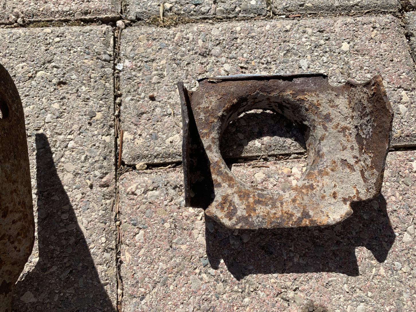

Started cutting the perches off today.
The welds are tough to get to, but free is worth a lot of tough!!!
Ryan W31

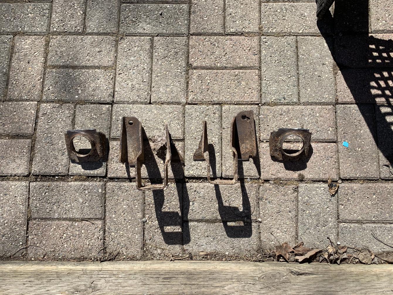

These perches are difficult to cut off without damaging them, but I did it.
Now I need to dress them up, sandblast, and primer.
Now I know why I never hear about GM A-Body rear end perches getting ripped off at the drag strip. (Solid!!!)
One step closer to 13.999
Ryan W31

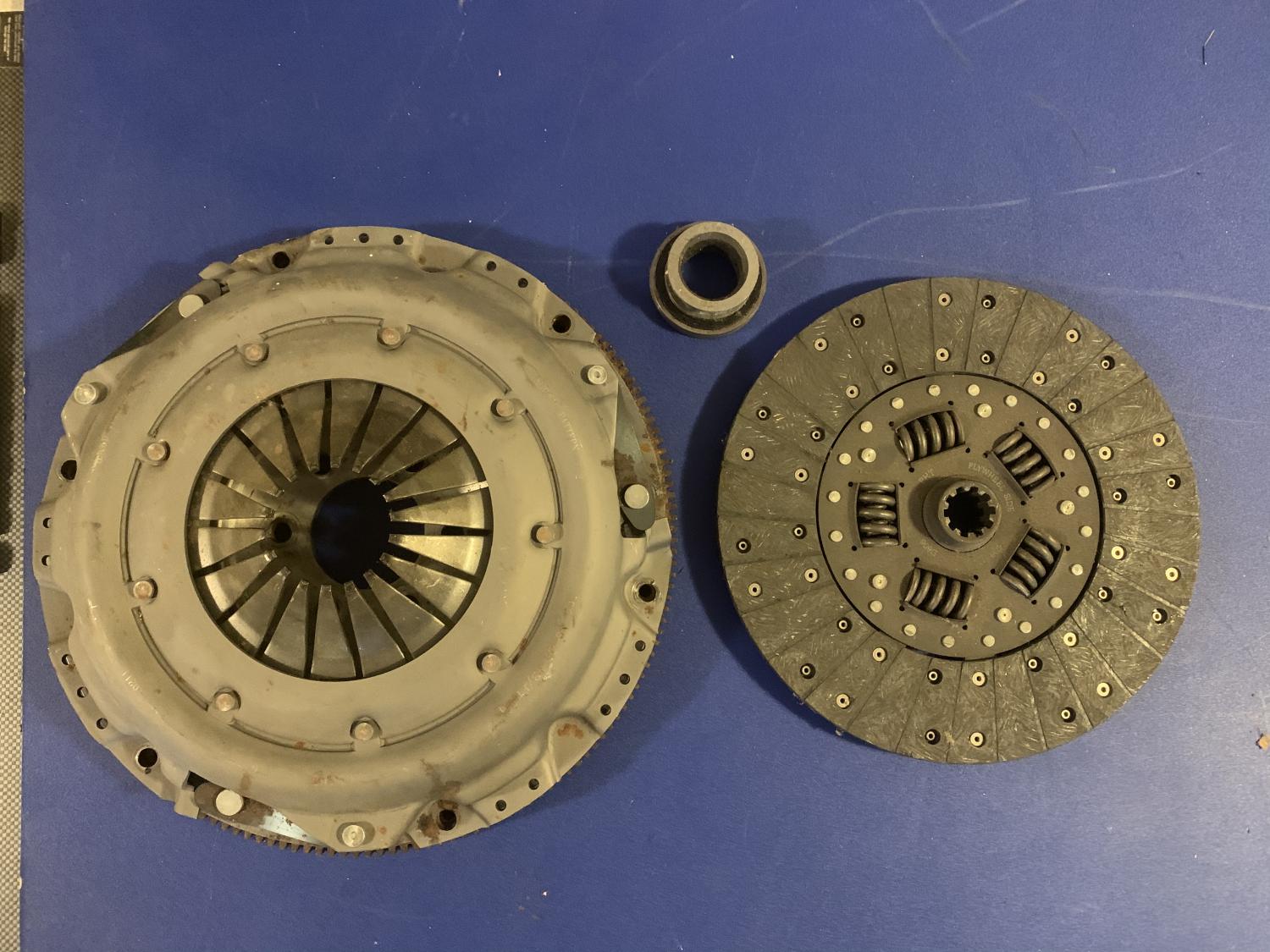

Thanks to Albert Galdi I have a new clutch to abuse.
11” 10 spline GM replacement
Now if it will warm up, I’ll get at it!!
Ryan W31

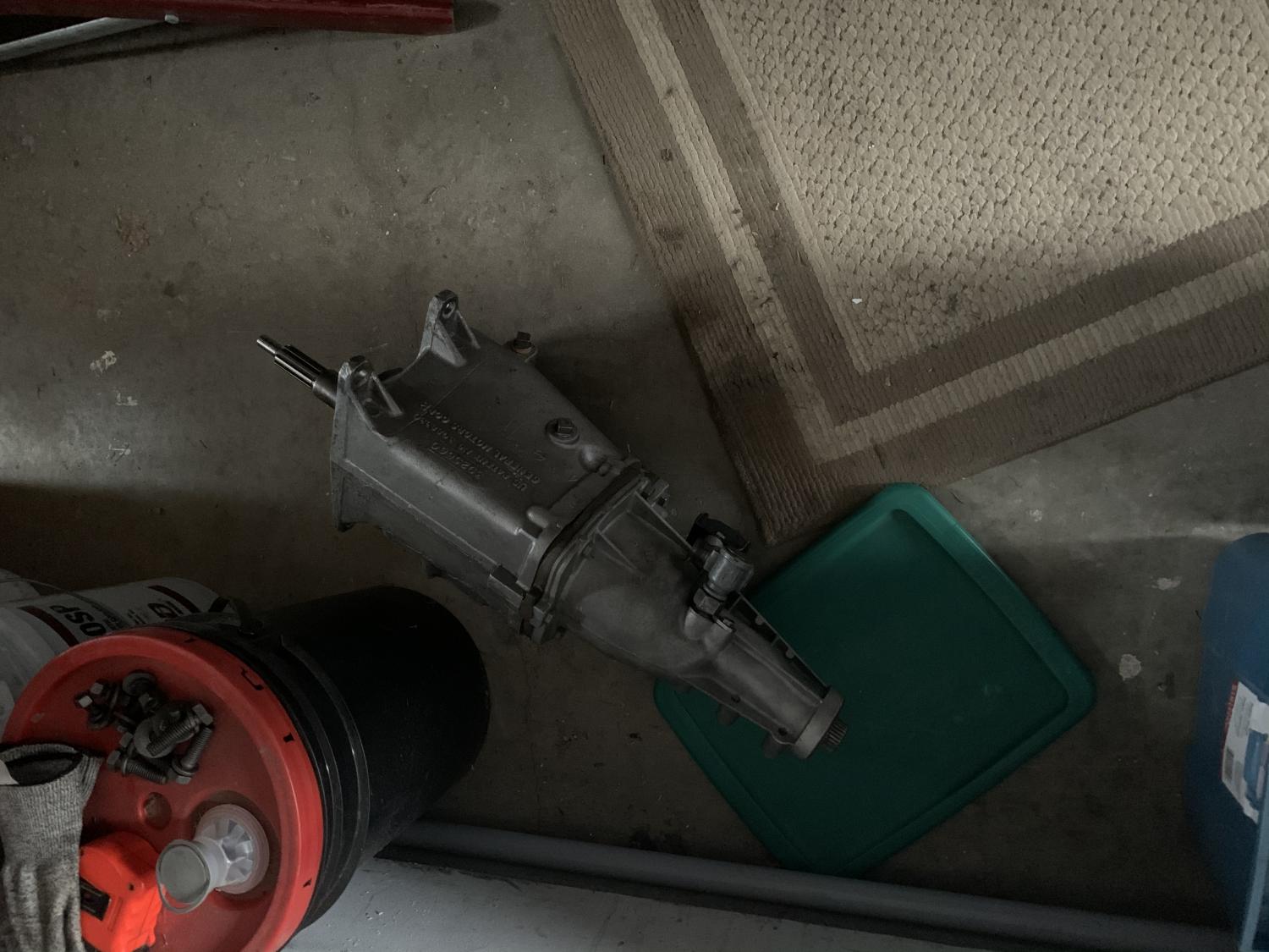

Weather has finally warmed up enough to work in the garage!!!
I pulled the driveshaft and transmission. (Heavy F@&$er!!) I took the pad off my floor jack so I can make a trans jack adapter. (The trans looks so light as the case is aluminum.... but there are a lot of heavy guts in there)
I am committed now :-)
Ryan W31
