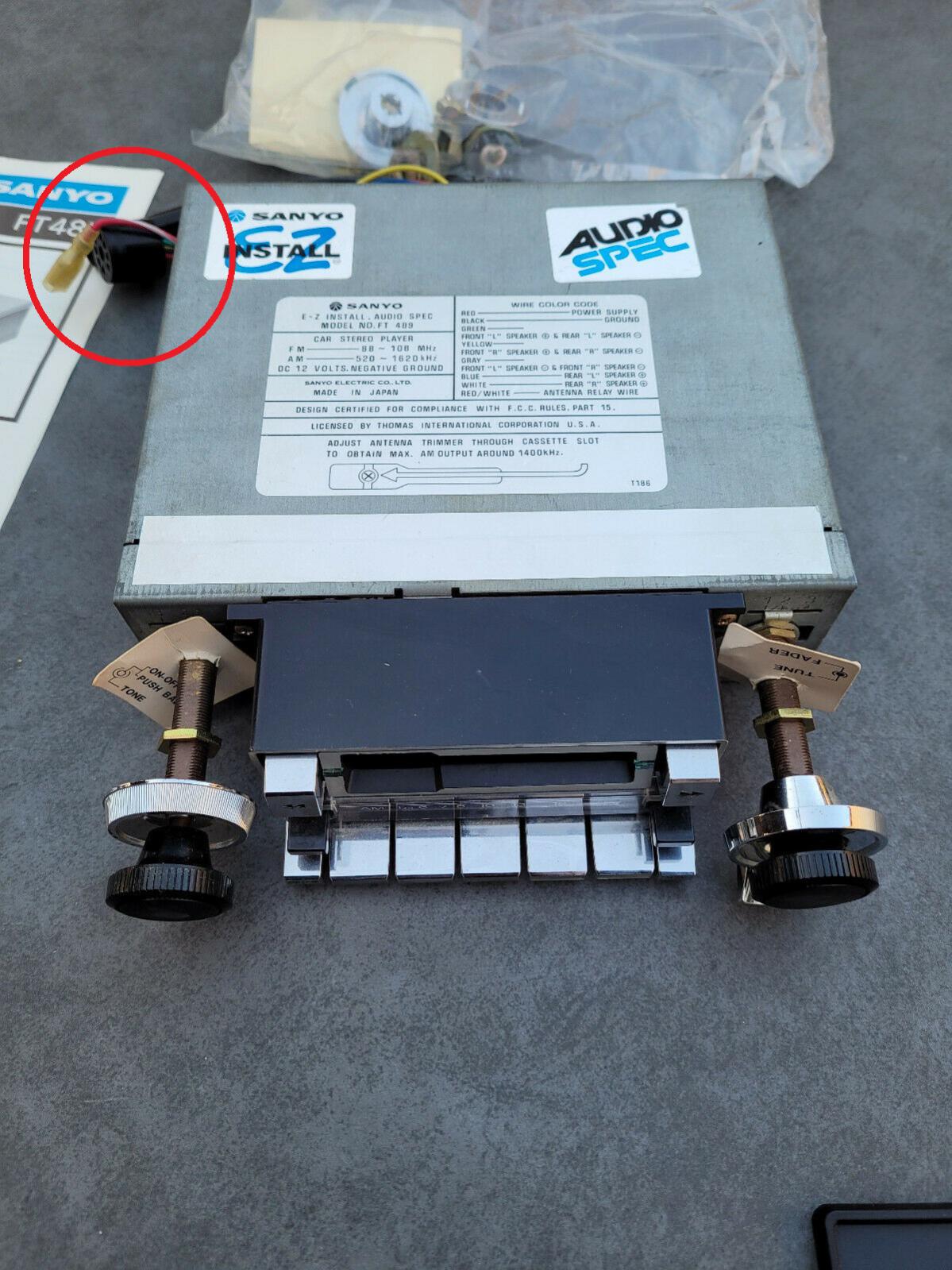

I just found an NOS Sanyo FT489 (circa early 1970's) for the purple Cuda. It is missing the male half of the quick disconnect harness attachment that you would splice your power/ground/speaker wires into.
Does anyone have any idea what precisely this barrell-shaped, male section of the connection is called and where I could locate one? I believe it has 8 or 9 prongs.
The first photo is the Sanyo I bought, The second photo is off the internet of a complete harness with the section I am looking for.
Thanks for any help.

Hey, Steve! Nice find!
To address your inquiry, it's called a "multi-pin connector." (It appears to be way too big to be a DIN connector, which is a kind of multi-pin connector, an example of which is the connecting cable on the Chrysler cassette player/recorder, circa '71, as was in your hemicuda convertible.)
As far as sources are concerned, perhaps try contacting Parts Express, as they may be a source for what you need, or, if not, be able to provide a helpful suggestion. https://www.parts-express.com
My only other thought, if the above is not viable, is to search for a complete non-working unit which you may be able to acquire on-the-cheap, simply for it's parts. (I hope that this helps.)

So the Sanyo arrived and I did a quick swap in to see if it all works. The AM/FM sounded great but the cassette wouldn't load properly and when it did you could hear a motor whining inside but no tape movement. So the belt is probably gone after almost 50 years. I have it packaged up to go out tomorrow to a guy out in California who specializes in refurbishing old car stereos. So stay tuned! (pun fully intended).
