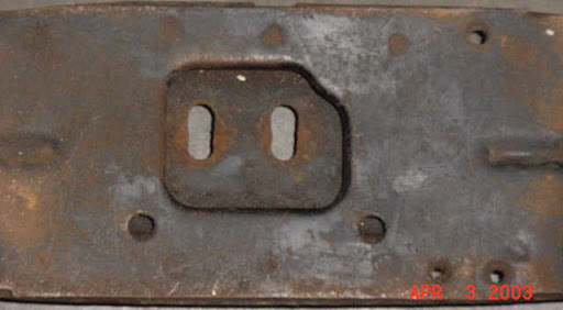

This is a FIREBIRD crossmember, which I now have two of
Notice the holes are more in the center. The square shaped hole where the tranny mount goes is the same as a big block Camaro piece.

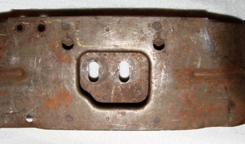

This is a big block Camaro piece. The mounting holes are further forward in the "notched out" section of the large access hole. They're also offset to the passenger side 1/2" Notice the comparison drawing as well.
VERY similar but NOT the same!!!

Wow, very subtle, not certain I'd recognize that easily.

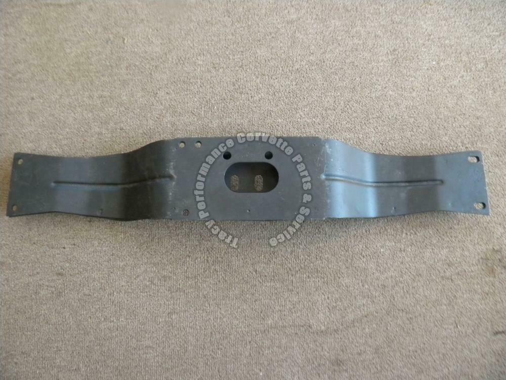

Good question. The small block has a perfectly oval shaped hole and the mounting holes are centered, no offset to the passenger side. The big block is offset to the passenger side for the exhaust to clear the steering box.

Here is the distinctive oval hole on the small block crossmember. I have two of these

The SB ones are fairly common and relatively cheap. I would have to fire up the plasma and make one for now. Could take a while and a "bit" of coin for an original BB one.
