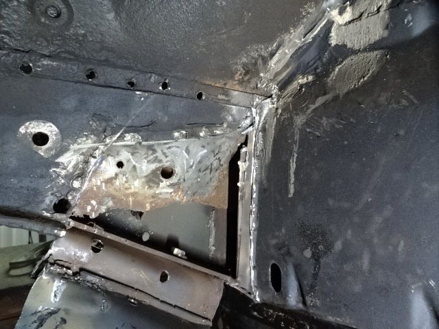

I then moved to the rear of the rail and analyzed the cobbled, patch job back there. Someone had been in there and replaced the torque box and toe board but only patched the rail and not all that well either.
I needed to get the patch out of the way to access the flange on the torque box to rail, so I cut that out.
Oh, yeah, nice patch job...
I cut the TB in half to access the rear of the rail that is SUPPOSED to have a weld flange at the toe board to drill out the spot welds, but the patch didn't have the flange... Oh well, the emplacement rail does, so I still needed to get in there to weld the new one in.

Finished drilling the rest of the spot welds and removed the debris. Any of you Mustang guys notice what else the previous patcher didn't do with the replacement frame extension ?
Did a test fit and tweak with the new rail and marked all the spot weld holes to remove the EDP.
THIS is the flange that should have been on the previous patch.
