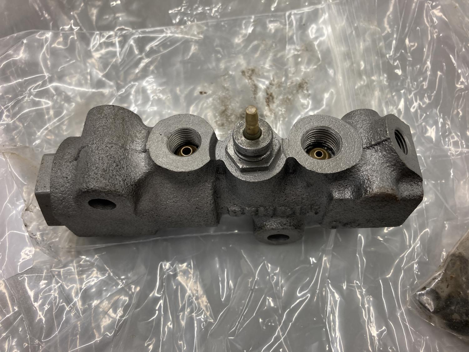

Joe's rebuilt valve finally showed up today.
Anyone know what finish it should be - natural cast, or black?
Will try and get painted tonight and install. Need to give the entire brake line replacement another go or learn how to use a flaring tool.........
Thanks again Joe - appreciate your generosity.

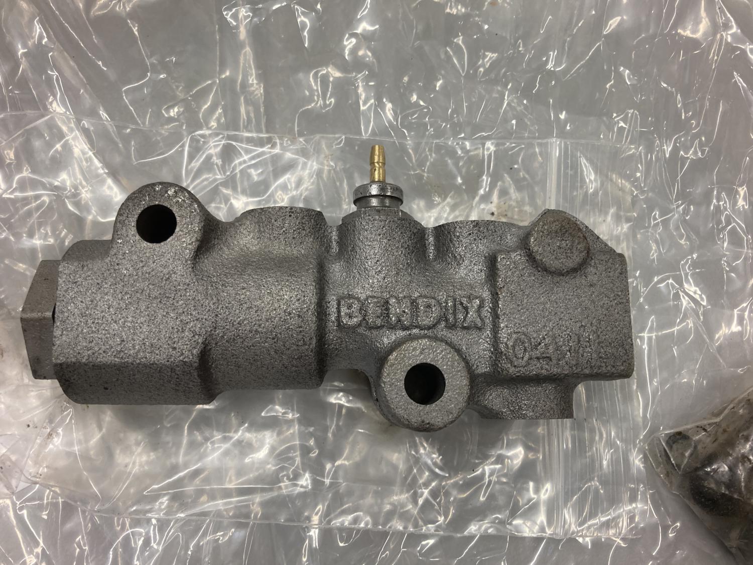

Jake glad it was useable. From what I can tell it was left "natural" not plated or painted.
Here is a pic from my 72 Convertible.

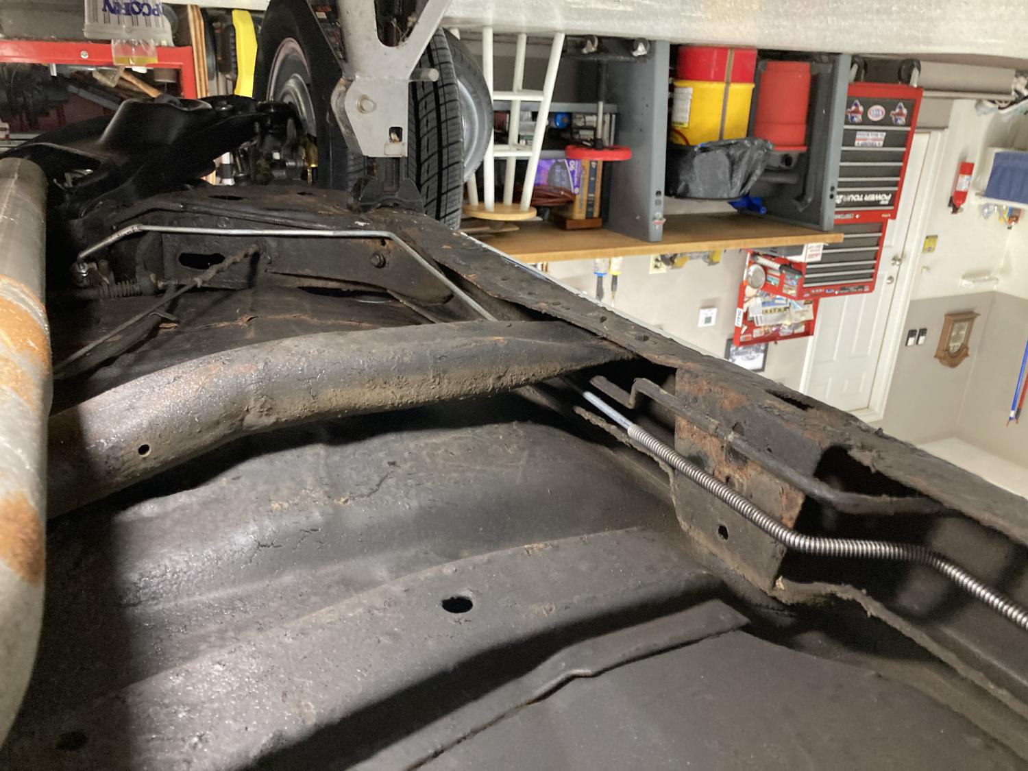

My brother borrowed me his fancy one back in July - but after much consternation and a couple dozen under the car strategy sessions I decided to try and replace the entire front to back line this evening. Not so much fun laying on my back with the car on jack stands and a welded exhaust system in the way, but 3 hours later the new line is installed along with the new flex line in the rear that everyone says should be replaced anyways. Glad I chose this route.
Need to button things up and make final connections/adjustments/etc. so I can bleed the entire system. Progress pics to follow tomorrow to show what I did with the one clamp that is bolted to the top of the frame above the lower control arm forward mount and not accessible.

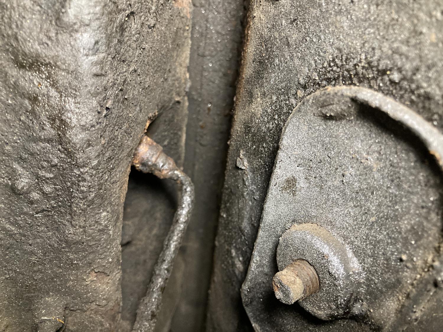

After bailing on the line replacement twice and realizing the flare/splice deal wasn't for me I decided that the only thing preventing me from replacing the entire line was the one clip attached to the top of the frame above the lower control arm mount - also right where the muffler resides. If I could deal with this then the whole thing would work. I was able to take a small Dremel-like cut off wheel and slice the end of the clip and pry it apart enough to remove the line. Not perfectly ideal but much better than having a line with a splice in it. In addition I didn't butcher the old clip so it will still work, albeit with an open end now. I also had to cut off the hard line connection to the rear flex hose as it was not budging. After that the old line came right out. Fishing the new line back in is was a bit of a challenge but doable. Again, being on my back vs. a lift I wasn't doing myself any favors. One piece of advice - leave the new line loose until the connection to the rear line and front distribution valve are made. I now need to make the line connections to the distribution valve, tighten the 2 bolts holding he valve to the frame and re-install the line clips before I bleed everything.
