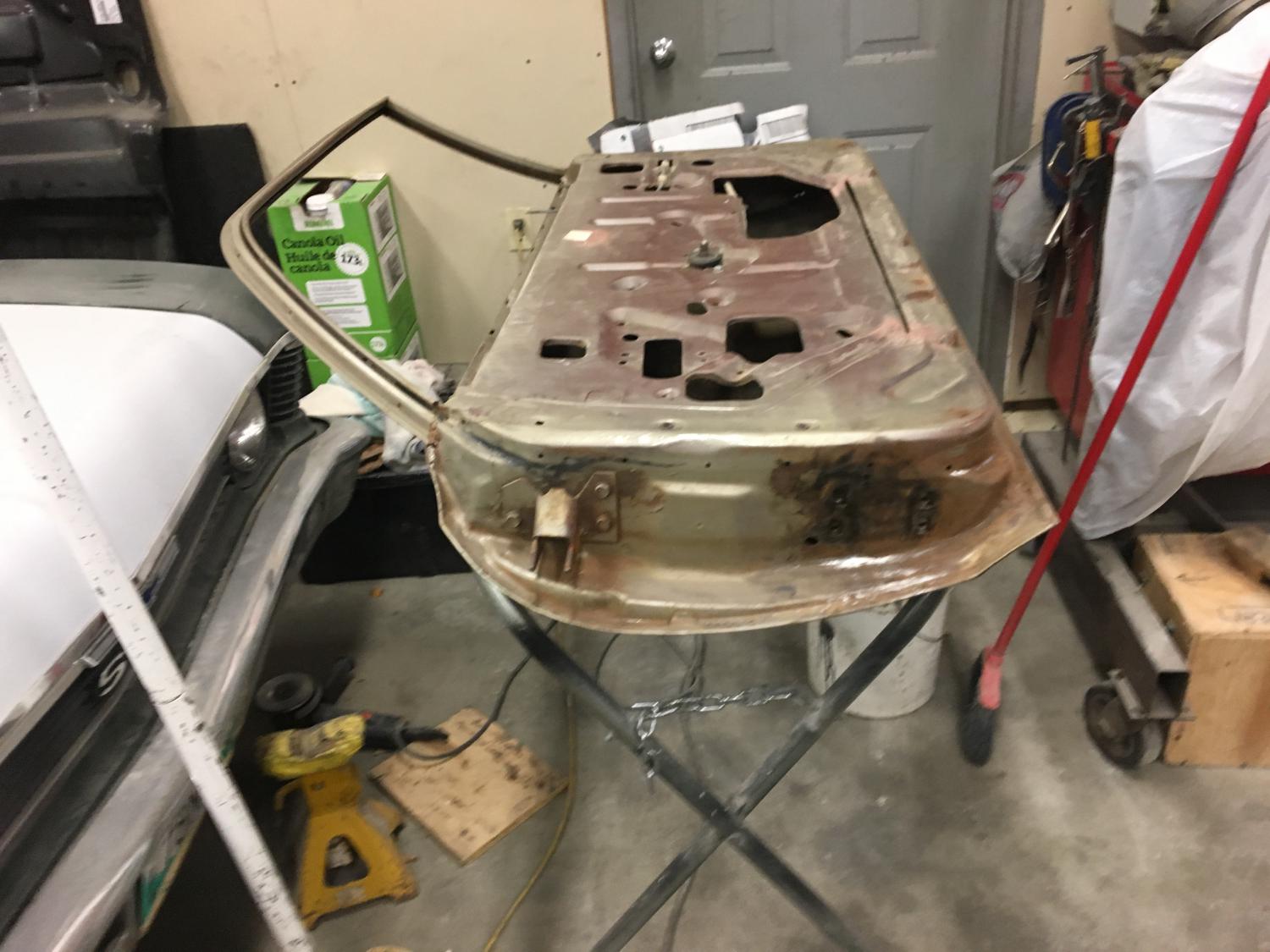

First step rebuilding hinges, strip and hanging doors easy peasy right ? Maybe not. I had purchased a VERY nice pair of 69 doors out of Nebraska hella years ago to use for this car. Somewhere along the way a friend needed hinges for his Nova restoration so I offered up (no problem Green Bastard has it’s own hinges). Here’s where things become a little more complicated. 69 Nova hinges bolt on, 70 hinges weld on (body and door). I had fully intended to use the bolt on half for the doors to provide some adjustability but… gave away one of the parts I needed. Long story, had to source some pieces and section in the tab for the spring lever (which was broken off on both originals) to repair the hinges. Sorry no real hinge pics.

Rough hang the door which really exposes the previous poor ¼ panel repair I had mentioned

This really wasn't a Green bastard issue because I did know about this going in.

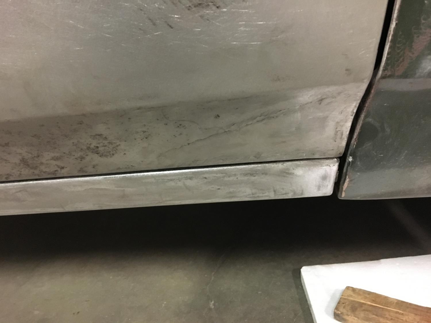

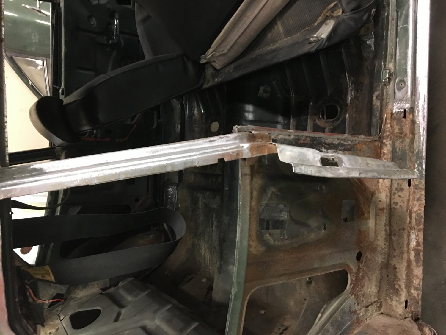

Hanging the replacement door provided reference for where the jamb and pillar (and replacement quarter) should be, clearly there was a lot more investigation required here! Removal of the old panels could now begin.

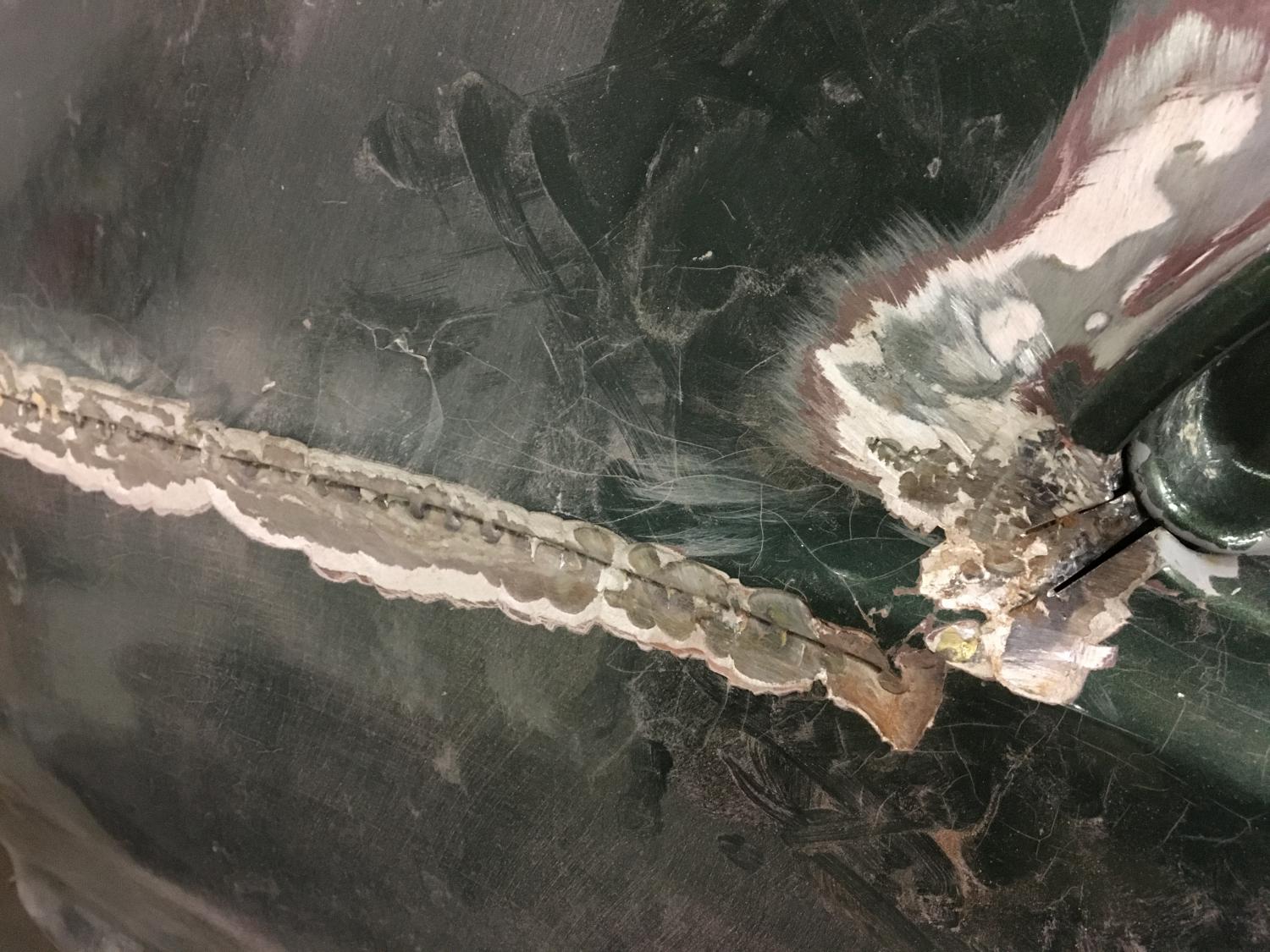

I suspect the replacement panel was trimmed below the sail panel to simplify/shortcut the repair. The entire bodyline was formed in Bondo.

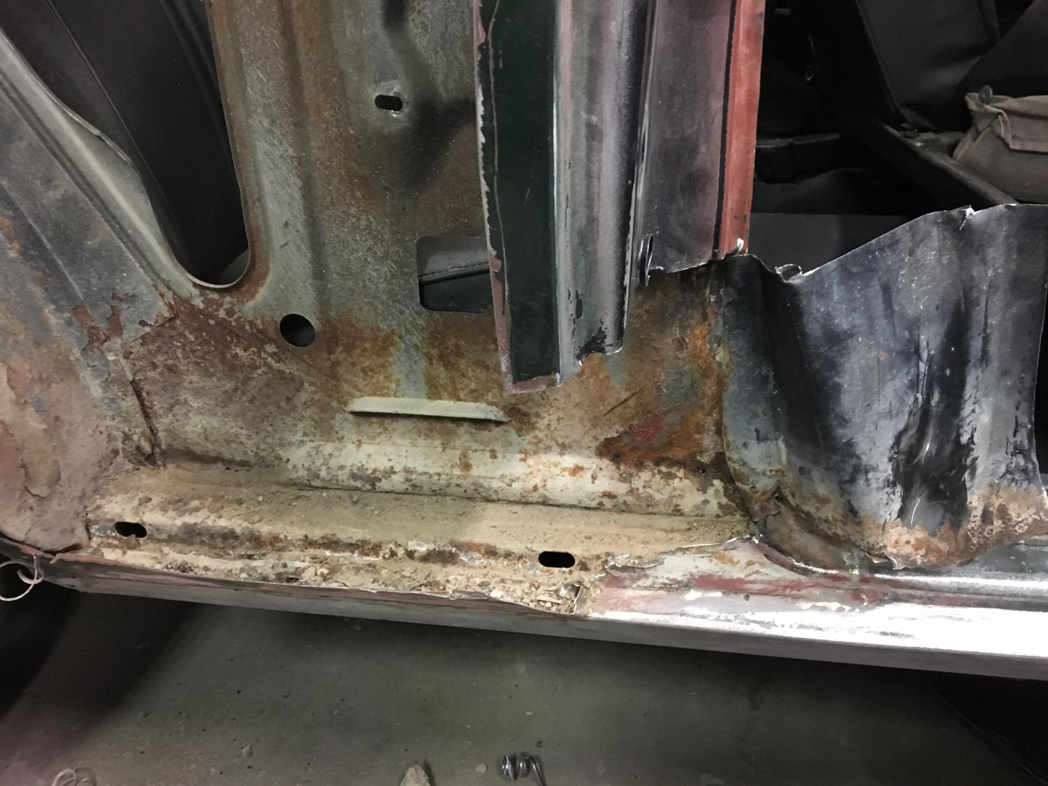

Inside Panel was obviously damaged as well.

Looks like the body person that did yours, learned from the guy that did my '67 Camaro, except my quarter was brazed on the entire length from the tail light to the door pillar. And then the body line was formed from filler too.

Cutting this open uncovered a couple significant (Green Bastard) issues.
The replacement 1/4 was only welded to the rocker at the front and rear edges. The seam at the roccker was essentially loose. The inside of the panel was then filled with an entire caulking tube (or two) of silicone type sealant. This plugged the drain holes into the rocker, trapping water and rusting through both the lower edge of the inside door panel and the top of the ROCKER
There is enough left that this could be covered over but that's not me !!
So.... A piece of rocker will have to be repaired and an inner panel will be required.
