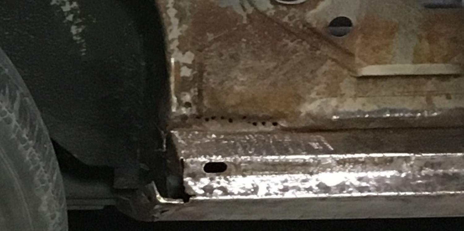

Close up of the rusted area. Top of rocker is badly pitted.

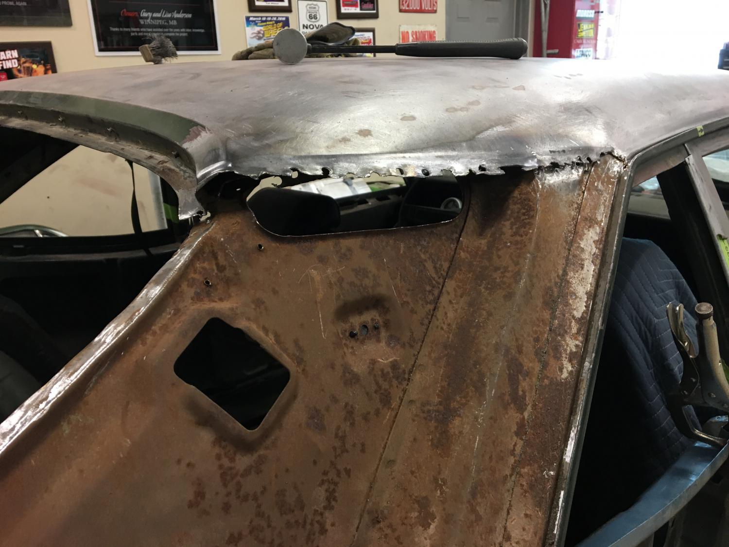

While waiting for the replacement rocker piece and required trip to the wrecker in Fargo for the interior panel (fingers crossed), continued with stripping the roof and melting out the lead. Previous paint at some point included a very aggressive stripping job... lots of coarse gouges which will add some work later (If I only knew ).
Name:  Sail Panel 0.jpg
Carefully pulled apart the roof seam and drip rail. Anyone that has done this job knows it is quite difficult to release what are a few layers of sandwiched and spot welded pieces. Including drilling out welds and folding back some of the interior bracing to get the old panel loose (to be later coerced back into place and welded once the new panel is in position.

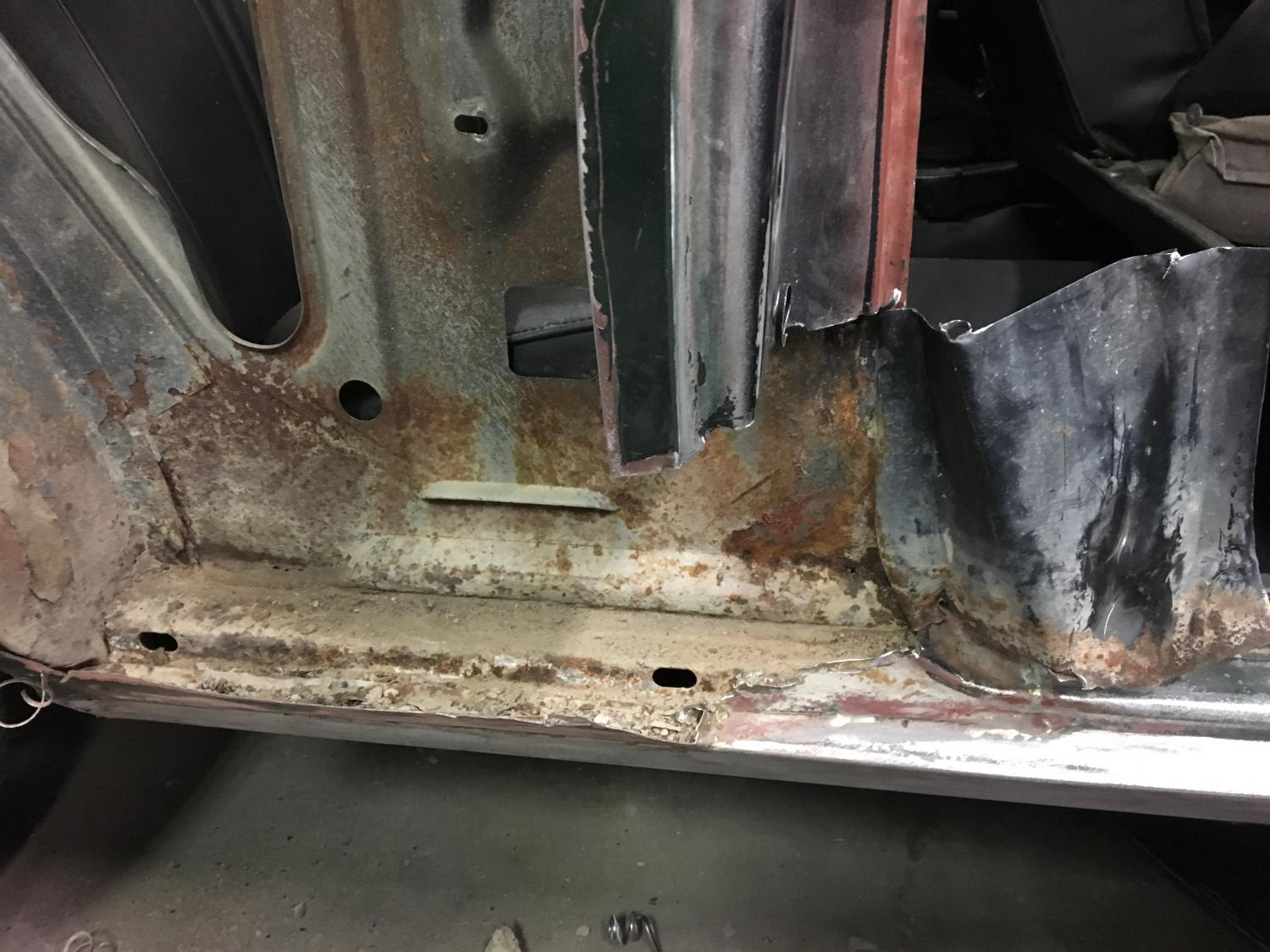

The Rocker was pitted badly at the rear section and also under the lower corner of the door jamb. So if I was cutting it this far apart, I might as well include that section as well. Plus it's easier to align the longer piece when installing. In this photo I had not yet cut out the lower half of the original.
Close up better shows how bad this was, particularly the front edge along the 1/4 panel to Rocker seam. It would have been impossible to spot weld repair that.

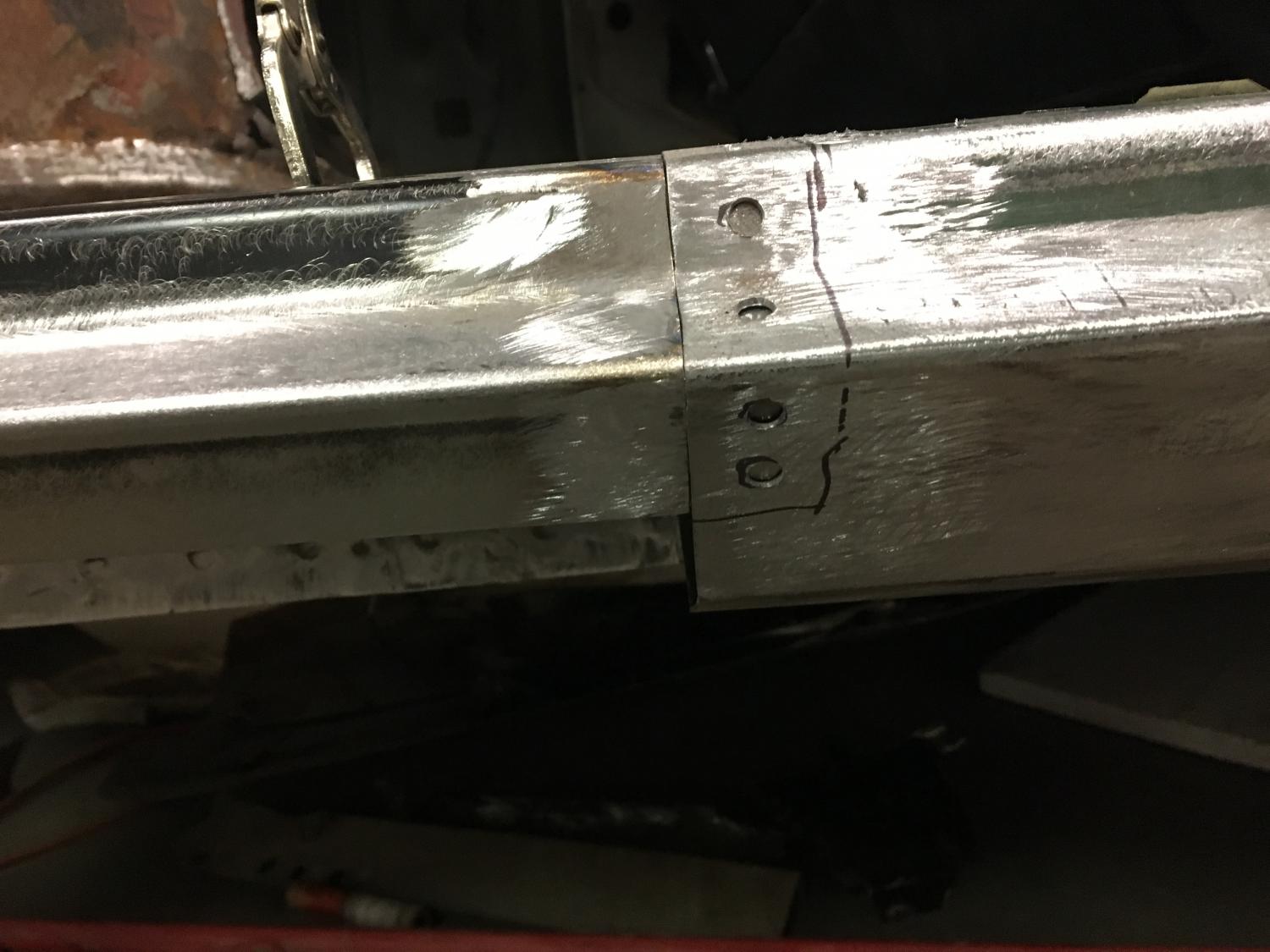

Here's the bottom half. Note the weld line, the lower face was also too wide and had to be sliced and cut down ! The cross section of the replacement panel would have nested over the original section... Way Off! The wheel opening end was also reworked.

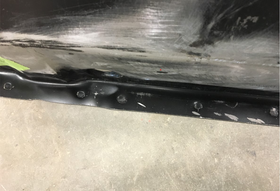

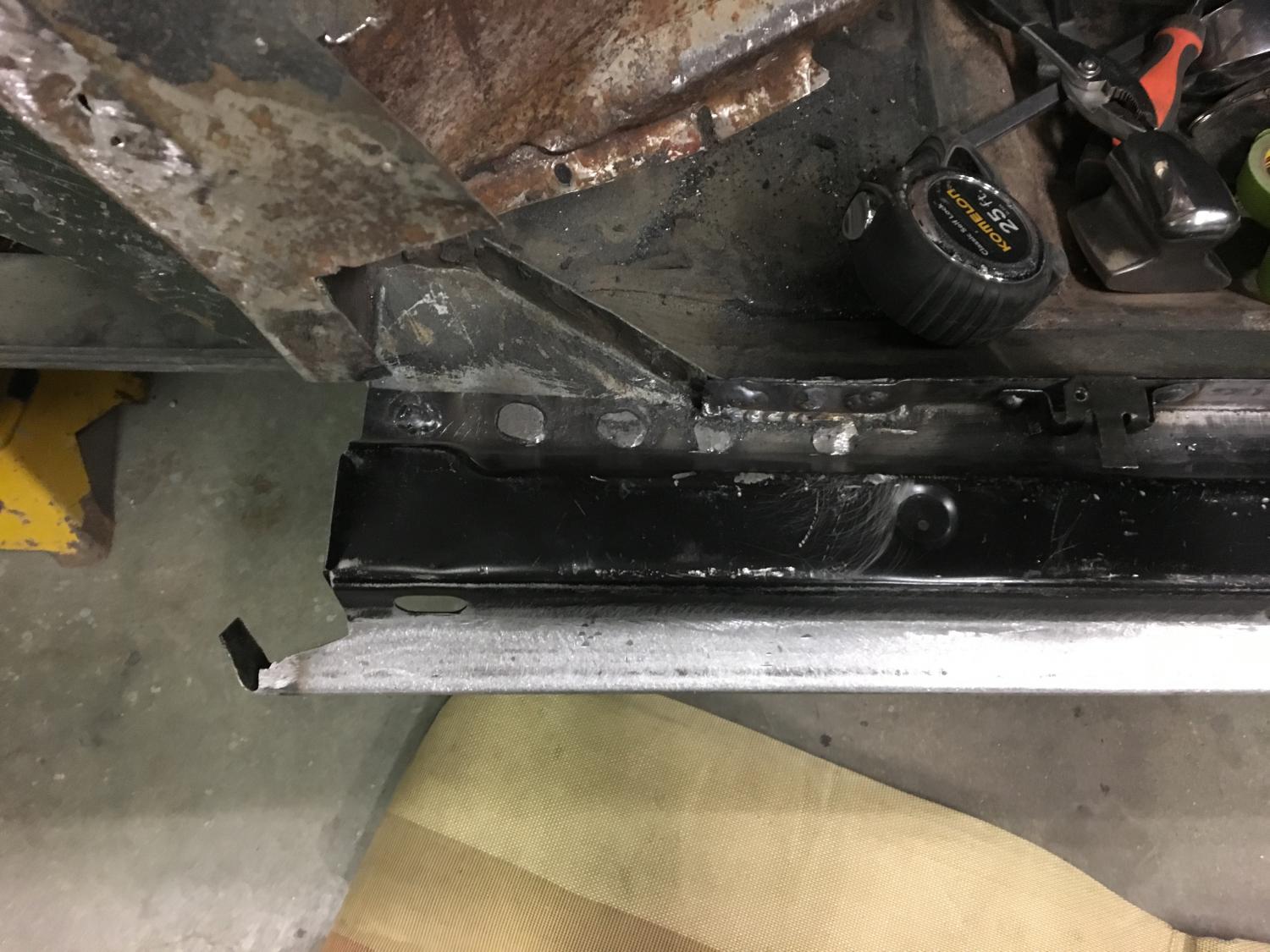

I fabbed a backer with plug welds to provide some extra strength to the rocker joint
Hard to see in the photo but a taught string line along the corner allowed for an easy alignment visual when tacking in place.

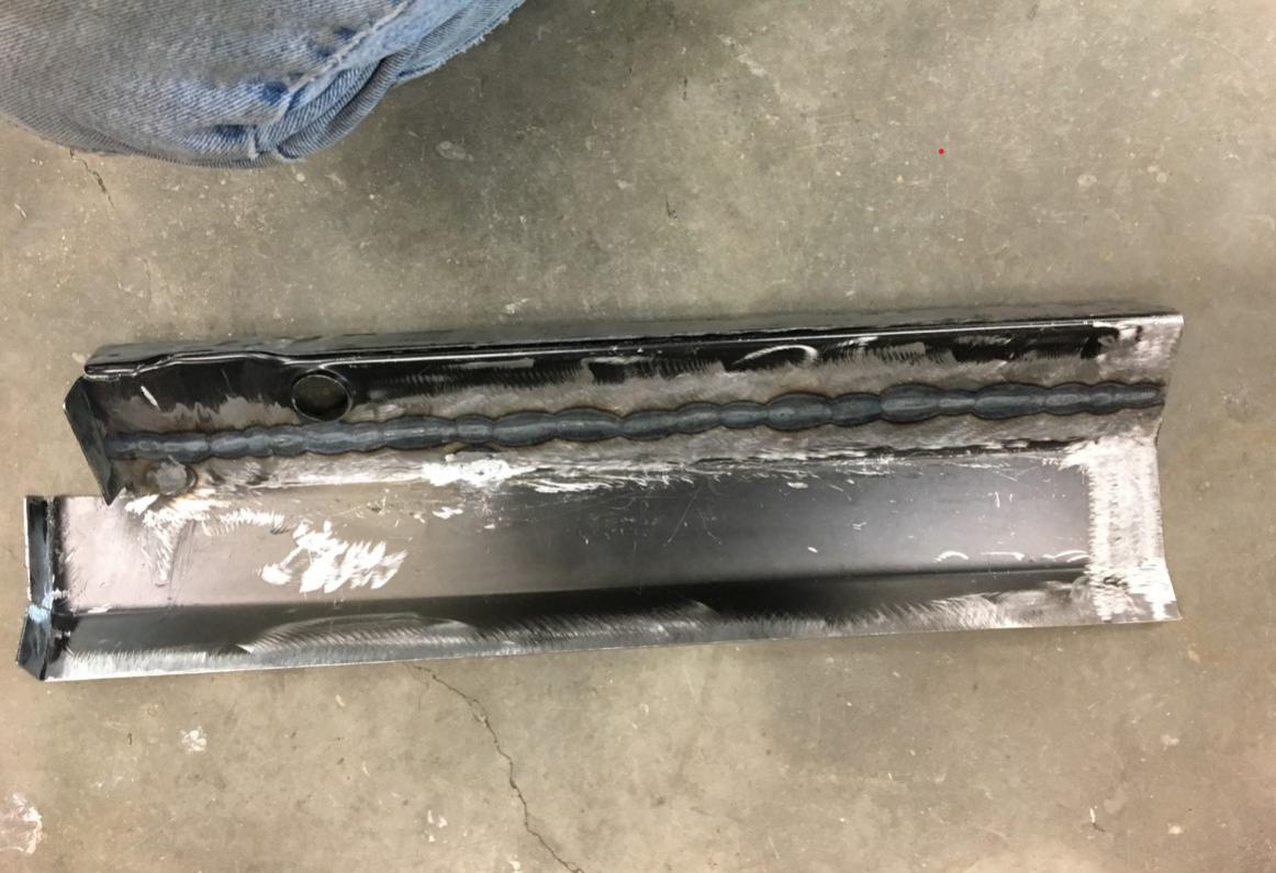

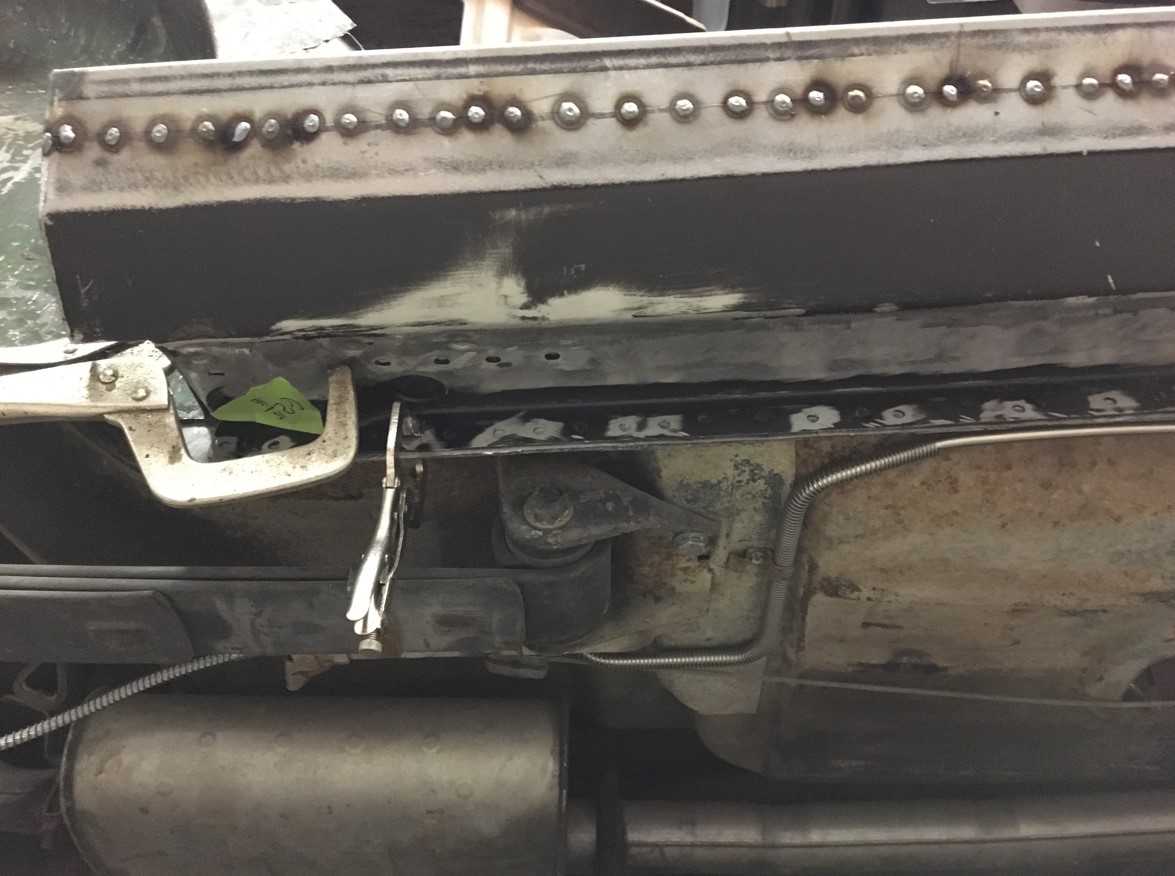

Lower half of replacement piece. I made a clamshell die to replicate spot weld dimples along the lower body flange. I then drilled holes in between the dimples for plug welding

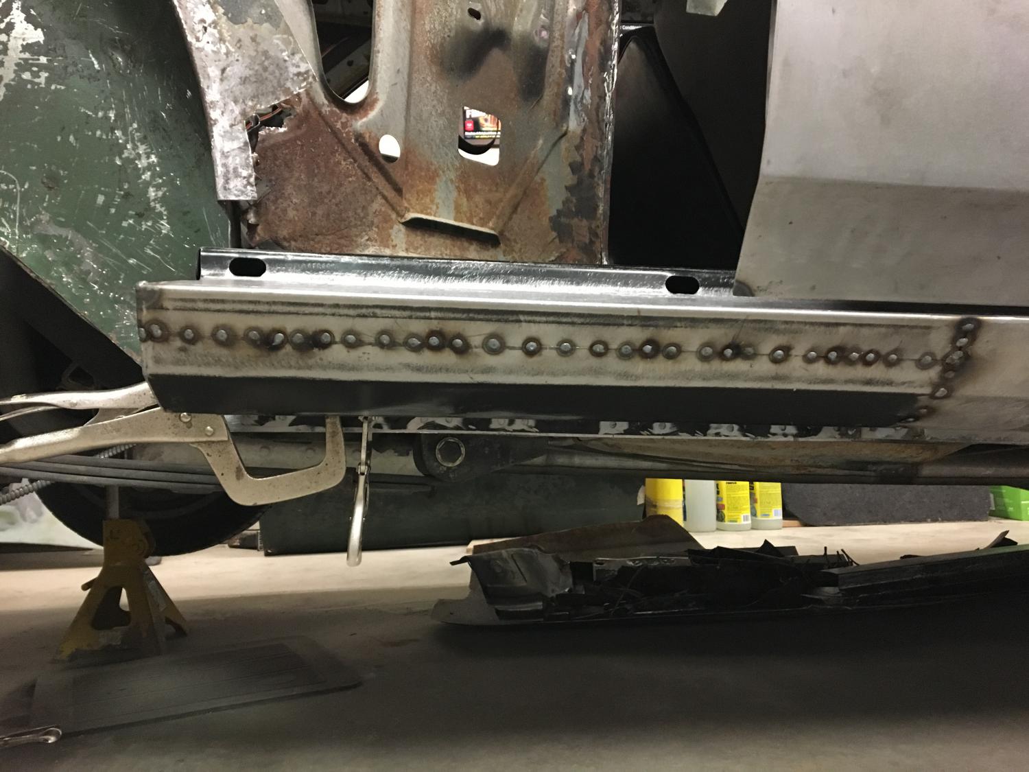

All tacked in place
Underside also shows holes for plug welding to the internal reinforcement bracket
Lots of careful grinding now required
