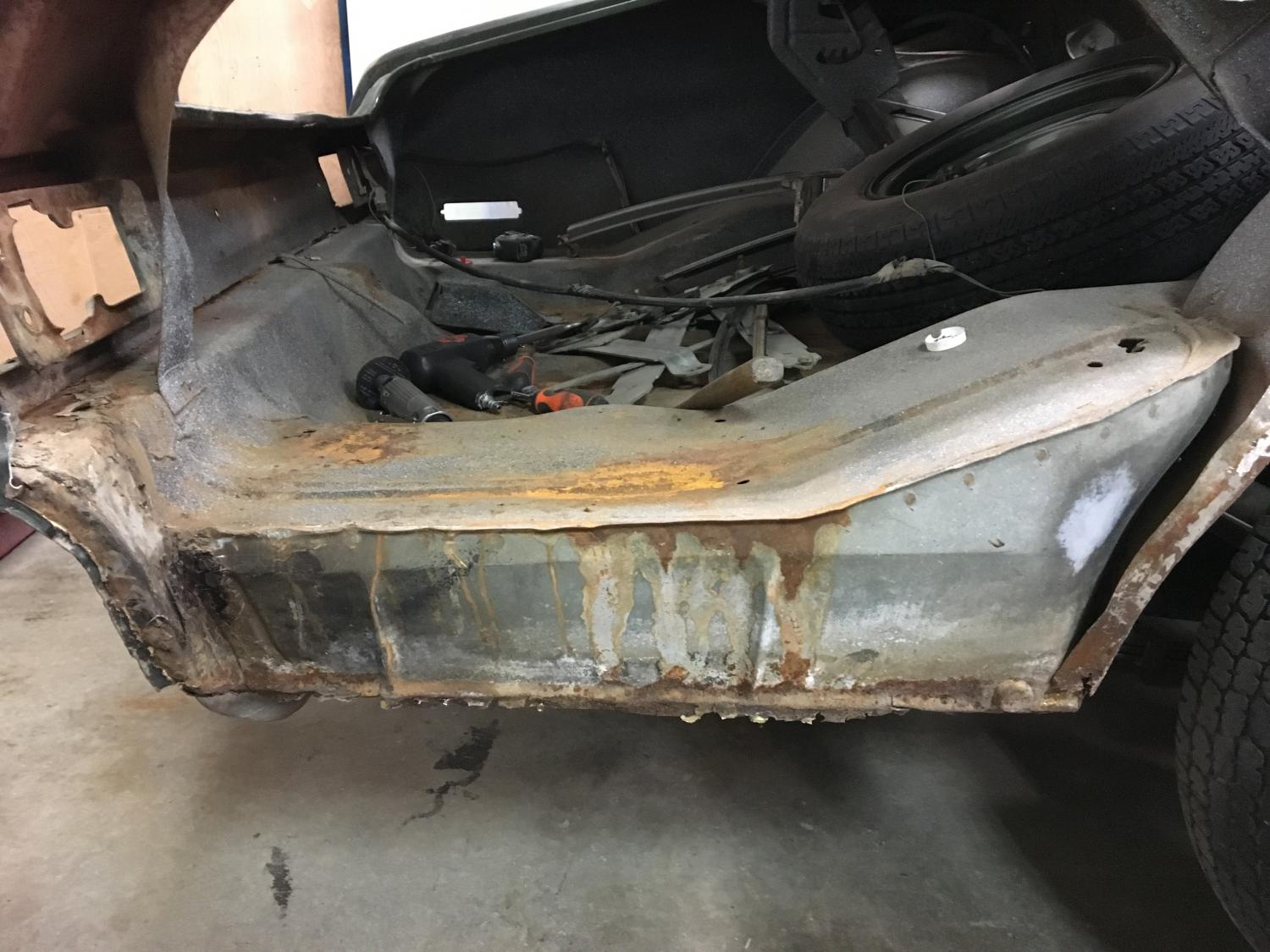

RH Trunk Drop
So the trunk drop looks terrible before cleaning up but really only the bottom flange was really rusted. I had an NOS piece to use but I was quite certain I could save this with some creative fitting and grinding. At worst I would waste some time trying. The NOS drops were dear $$... and I do have other Novas.

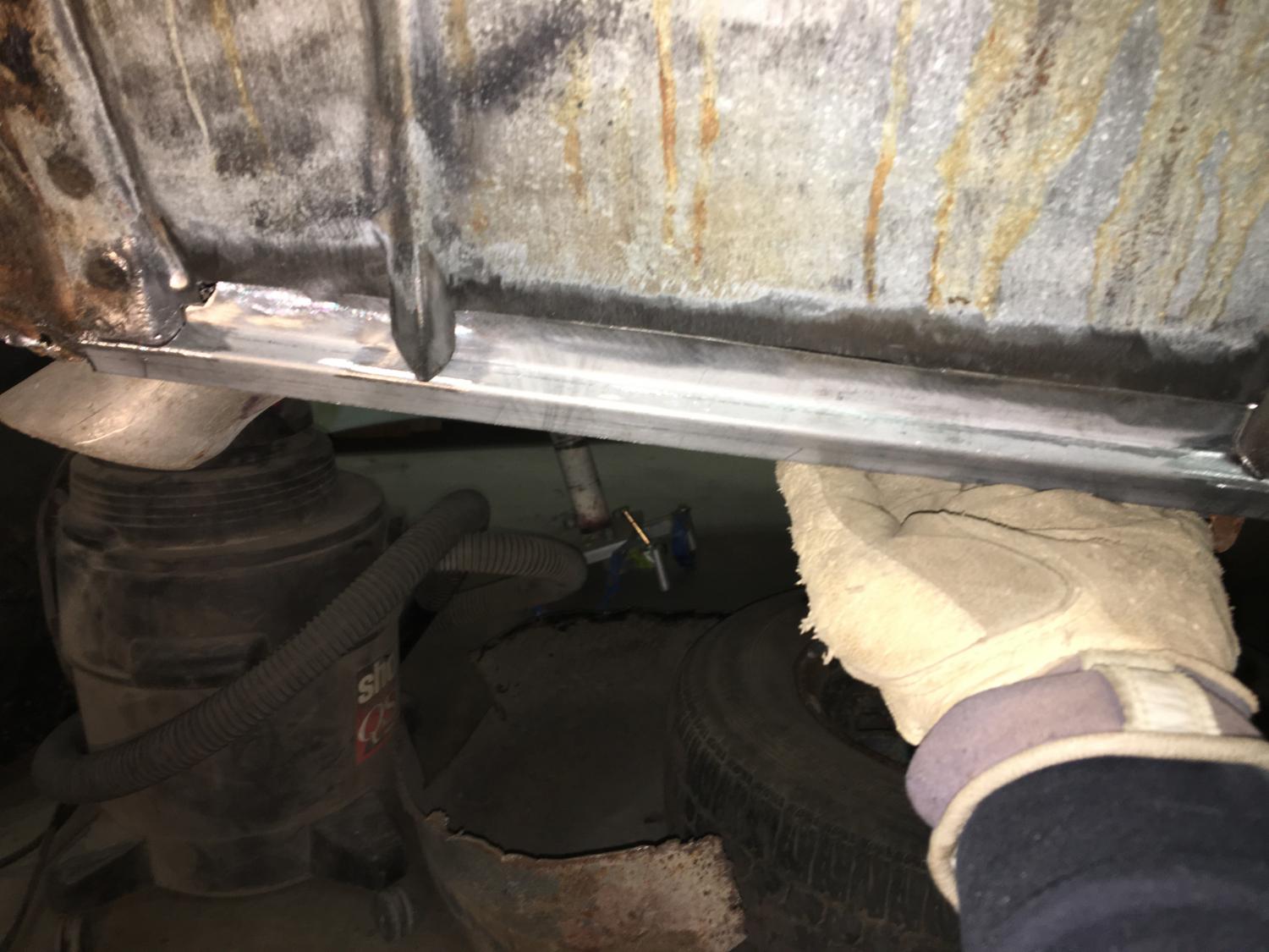

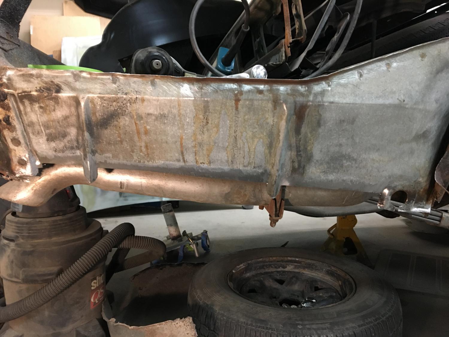

To save the beads, my plan was to weld in a replacement piece and grind out the backside where it overlapped the beads

Rough fit
Tacked in
The plan is to weld in solid from this side then grind open the formed beads from the underside (exhaust pipe side)

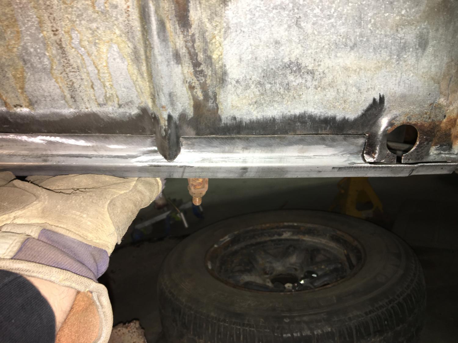

I cheated and Fast Forwarded to an underside shot so you can see how the trunk drop turned out from underneath. This side was finished up on the rotisserie.
Back to previous schedule
