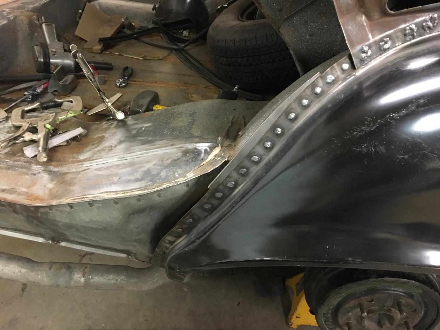

Tub time. The flange of the tub is sandwiched between two layers at the top. Getting the old metal out from in between was a challenge. The huge holes on the outermost flange were two-fold. 1) because it was so hard to separate, it required a larger drill size. 2) My game plan was to plug weld to the inside flange first (through the larger hole). Then finish welding the outer flange.

And getting welded... You can see I took the opportunity of no quarter to work on the trunk floor.. lots of old drilled holes (battery in trunk ?) and lots of hammer and dolly work. While things were opened up I was stripping the "to be painted" surfaces to bare metal and the "no show" surfaces were getting wire wheeled sanded and either Por-15 if surface rusted or DP90 if bare and clean.

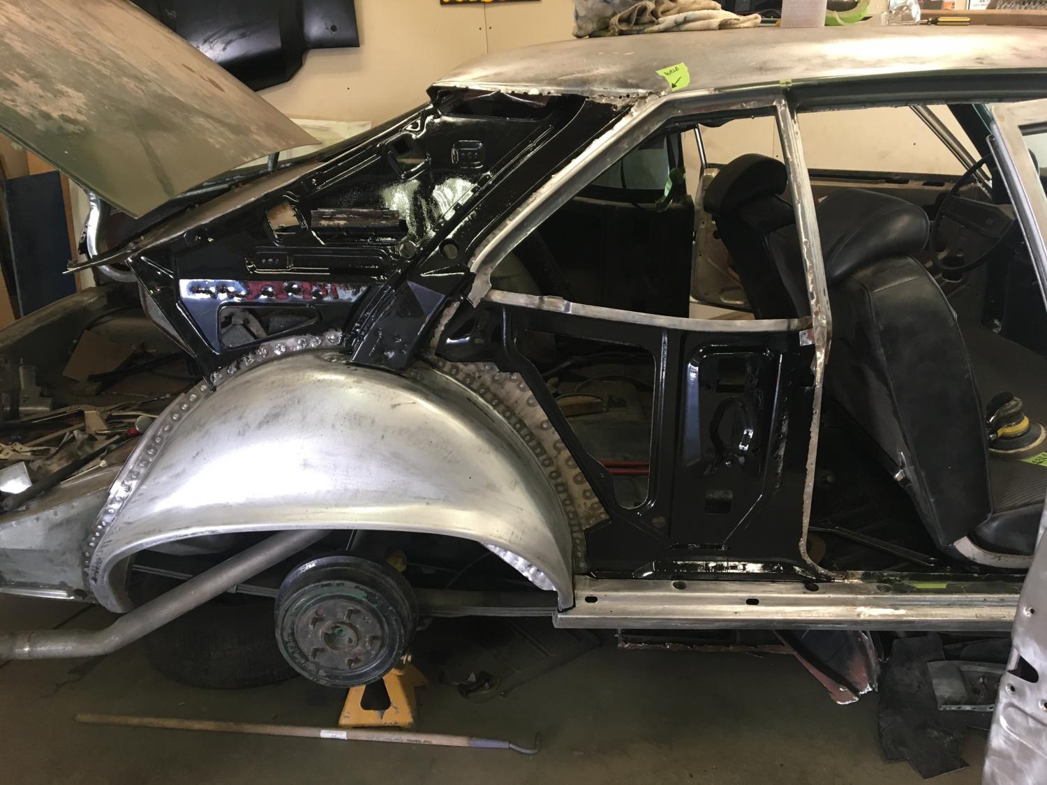

Continued welding

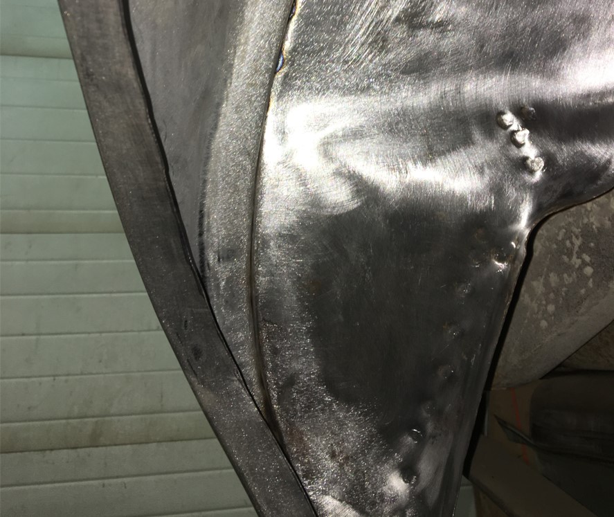

Front lower inside, with faux spot dimples... plug welded in between.

Rear Lower inside

Stripped out the old sandwiched quarter at base of rear window/trunk

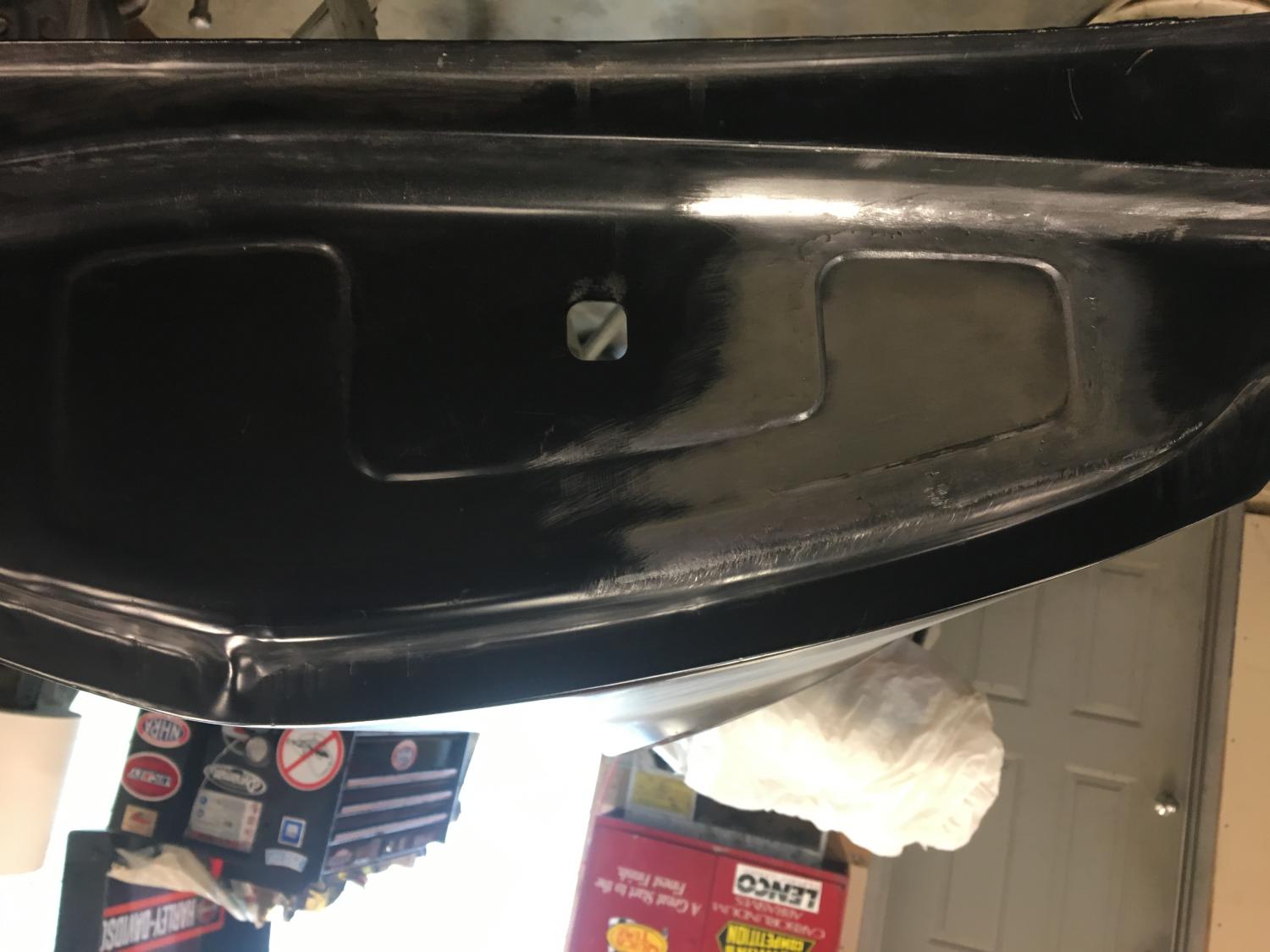

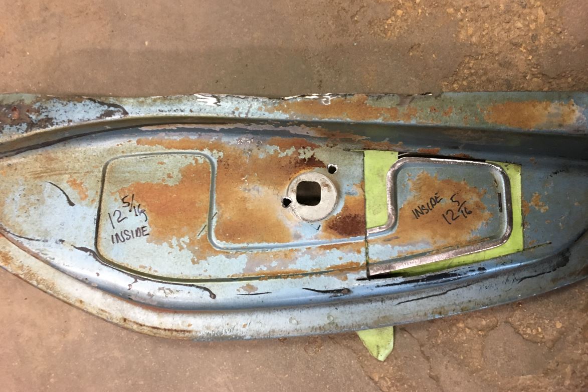

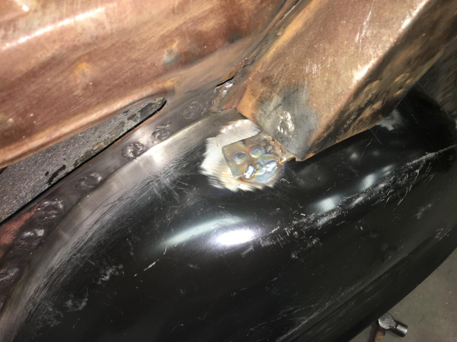

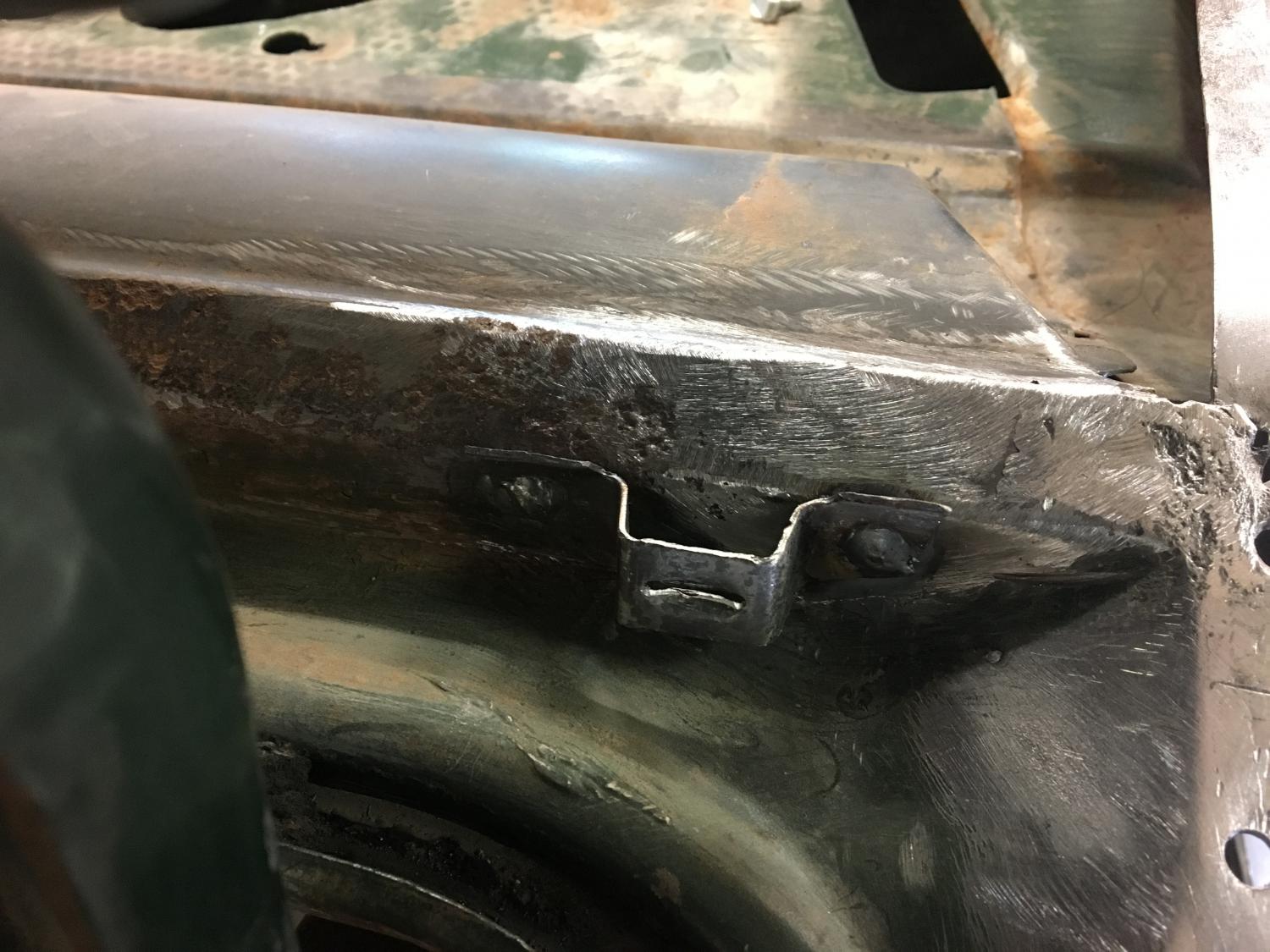

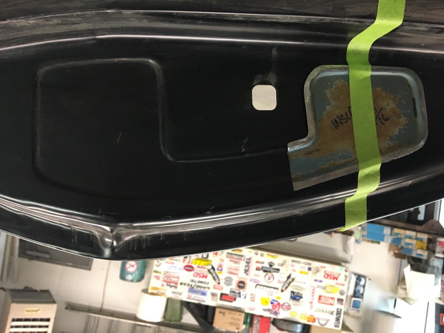

Old 02-01-2022, 10:35 PM
L78_Nova's Avatar
L78_Nova L78_Nova is offline
Join Date: Apr 2016
Location: Winnipeg
Posts: 607
Thanks: 10,426
Thanked 854 Times in 261 Posts
One advantage to having scavenged the replacement used inner door panel from the wrecker... I now had an original jamb to harvest the "telephone receiver". Recall the quarter which was cut off was a replacement GM panel with only half a receiver as with the replacement NOS GM panel I was now putting on. Well, we can fix that detail.
I tig welded the receiver in only because I wanted to practice with the tig.
Because of the previous jamb and inner door panel damage, It was best to also attach the jamb/striker reinforcement to the panel first. That way the quarter can be perfectly aligned and welded to the inner panel afterwards.

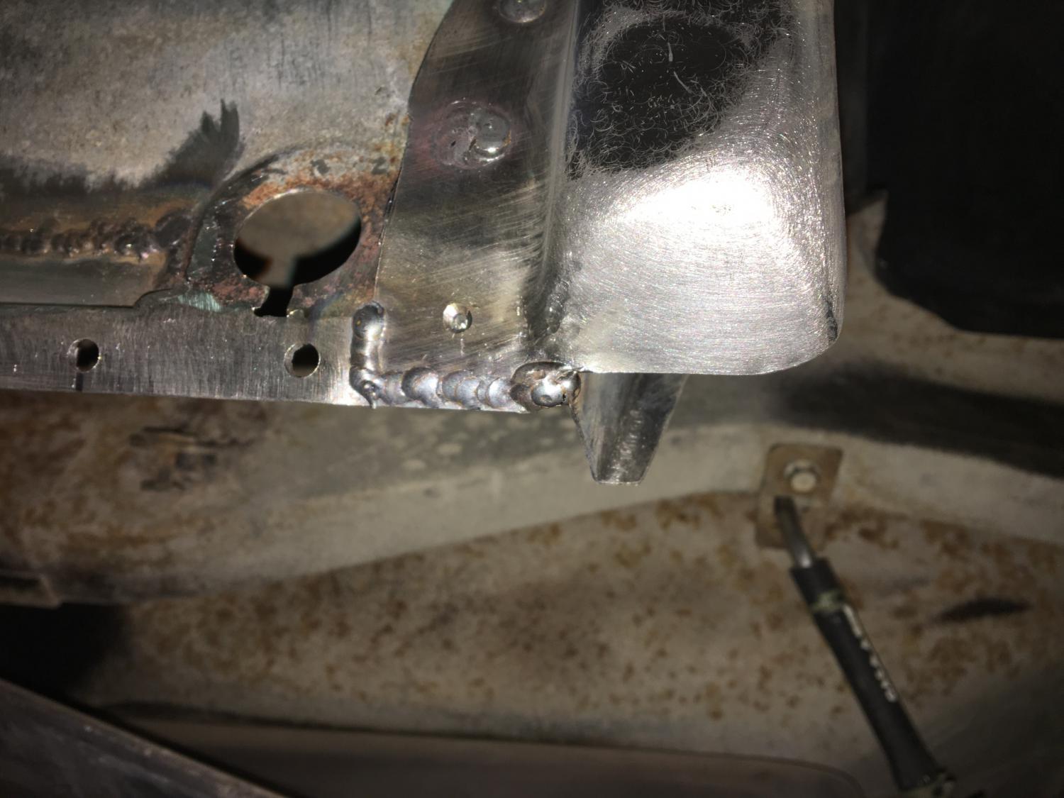

  #59
Old 02-01-2022, 10:57 PM
L78_Nova's Avatar
Join Date: Apr 2016
Location: Winnipeg
Posts: 607
Thanks: 10,426
Default 1970 L-78 Nova Restoration; Saga of The Green Bastard
Door side of jamb
There is a small reinforcement piece that goes in the corner of the quarter window. This piece was completely missing from the previous repair. Unfortunately I was not aware of it when I scavenged the repair piece from the wrecker. I did my best to get some phone pics of the LH side taping my phone to a stick and sliding it in there. Then fabbed a piece as close as I could from the pics
