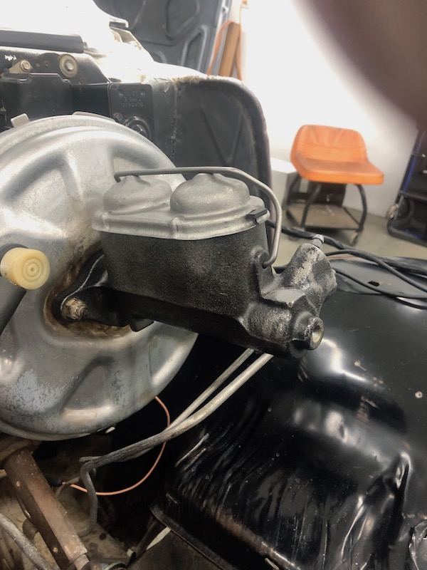

Masked off the machined areas on the clone master, light spray of semi gloss black, bench bled and install. Solid brake pedal, all good. A bit of wiping with DOT 3 on a towel to thin down paint and replicate years of spilled fluid. Mission accomplished, the lid is even starting to look OK, The later bail on an early car needs to be addressed though.

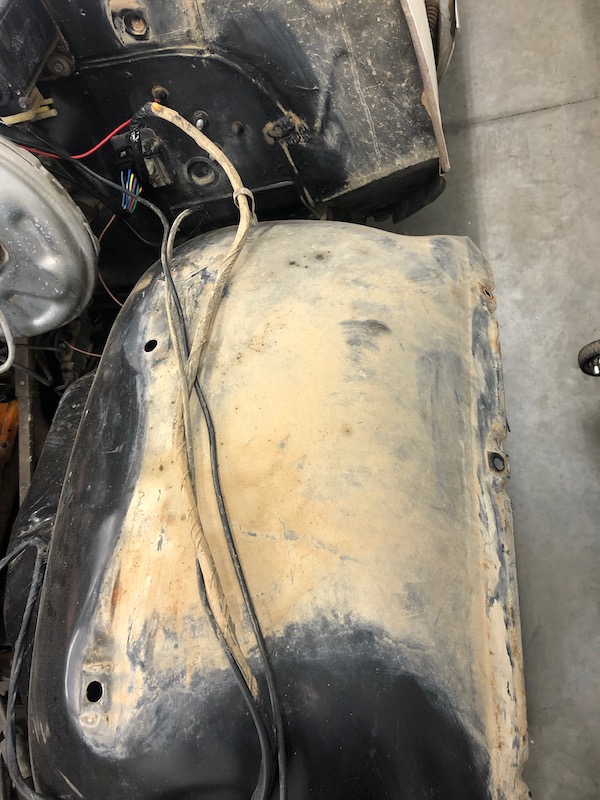

At the rear, as rough as it is, I couldn't bear to scrap the original mat. Left it in place and covered it with this nice piece from R.E.M.

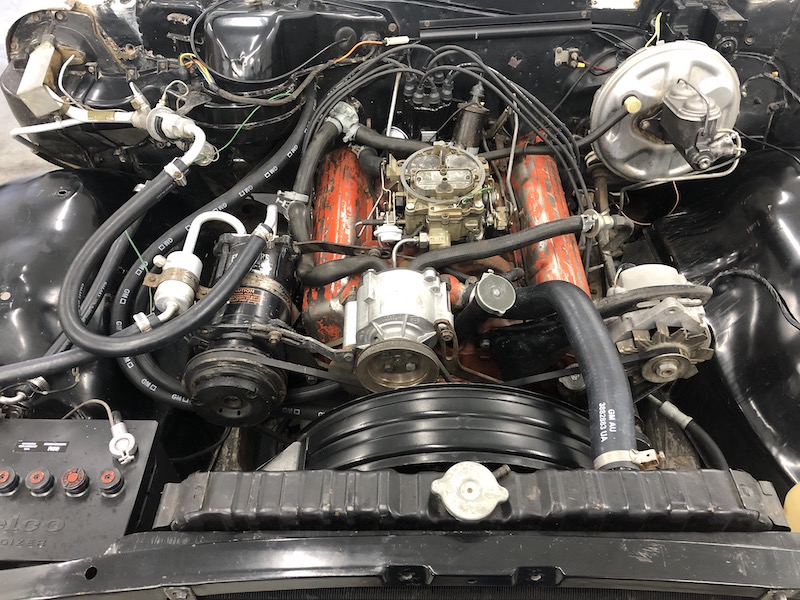

Moving forward...Pulling the front clip exposed more mess. With cleaning coming to a point of diminishing returns I am happy to have exposed some decent engine paint along with the other under hood finishes.

The last time this Chevelle ran was six years ago when I limped it the couple miles here from the old house. Time to get it purring again!!
The rad was cleaned and checked and reinstalled with fresh hoses. Along with the water pump the smog system was freshed, I blocked the smog tubes, removed the pump vanes and replaced the bearings.
The alternator received new bearings and brushes.
The carb was cleaned and kitted as well.
Pulled the distributor, cleaned and lubed, free up mech advance, new vac can and install a one wire module kit.
Now the 'ol L30 lights up and runs great! Starts with a touch of the key.

----I've never seen that center mount smog pump set-up. Hate to try to find formed hoses for that, Bill! The clean up is going pretty smoothly. Looks great....Bill S
