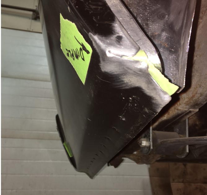

Many many trial fits and small tweaks to the panel. Repeated small trimming on edges to sneak up on the fit. Working alone it was a challenge to wrestle this piece on and off. I honestly don't think I would be exaggerating if I guessed at close to 50 times. I made myself lots of tape notes so as not to forget anything when I came back to the project.
You can also see some areas where I did some metal work while the panel was off to have easy access to both sides. The panels had been stored unboxed for many years.
You can see the faux spot weld dimples along the bottom of the panel. These were actually aligned to the pre drilled holes in the trunk drop for plug welds.

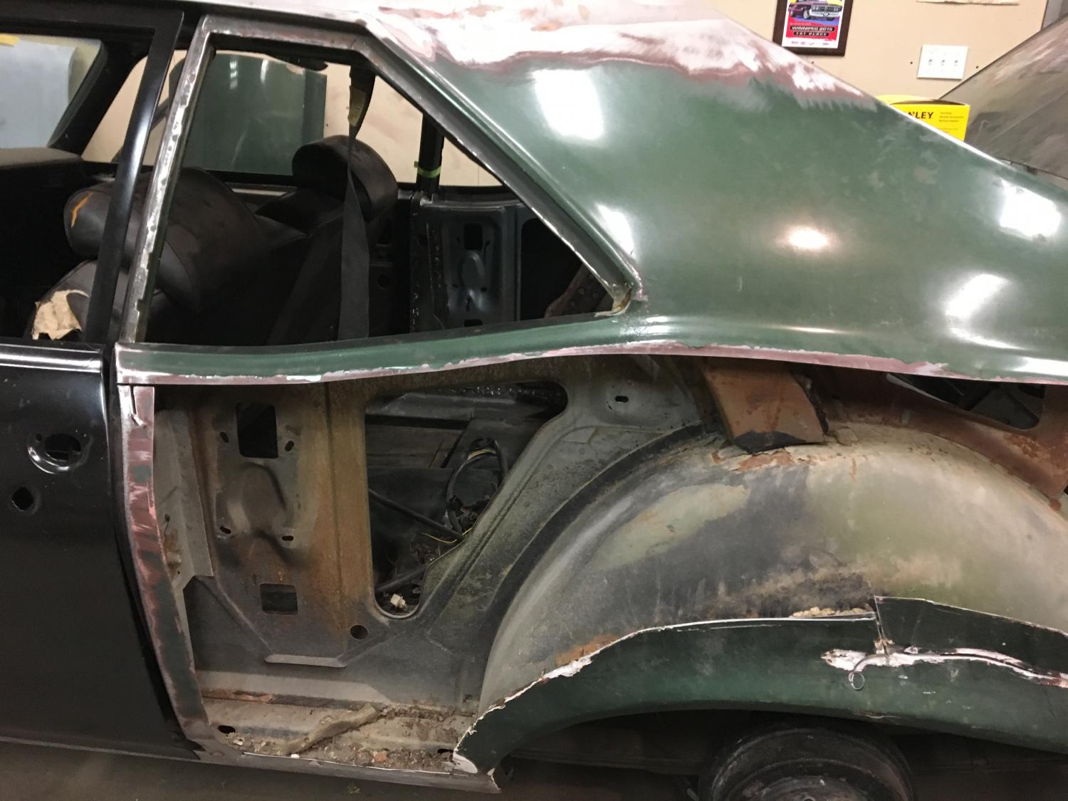

We're now into late 2018. Recall, I only bring the project car home for winter. Getting started into the LH Quarter.
Doors were home for the summer, stripped, rough body worked and Epoxy primed DP90. Everything was stripped to bare using 8" orbital 36 grit (slow RPM) where it would fit, 6" 36 Grit (slow RPM) where it would fit and a wire wheel on a drill for the tough spots... which was most of the jambs. Slow agonizing work. Doors were VERY solid replacements I had bought many years earlier. A couple small patches on the outer corners but the inners and skin seams were beautiful.
Hinges rebuilt, Door hung and aligned, happy with the rear fit and away we go. Front gap was a little tight but that front corner had evidence of a little bump so we'll fix that with the fenders when I get there.
So.. unlike the RH side, no ugly surprises.

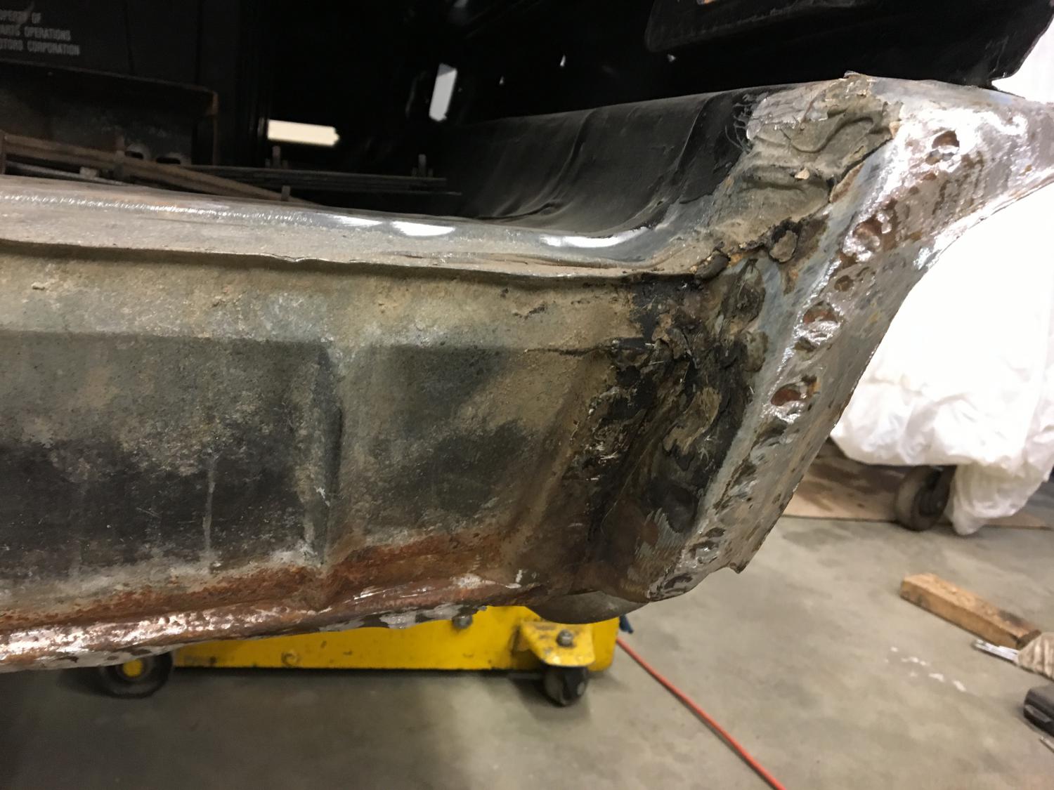

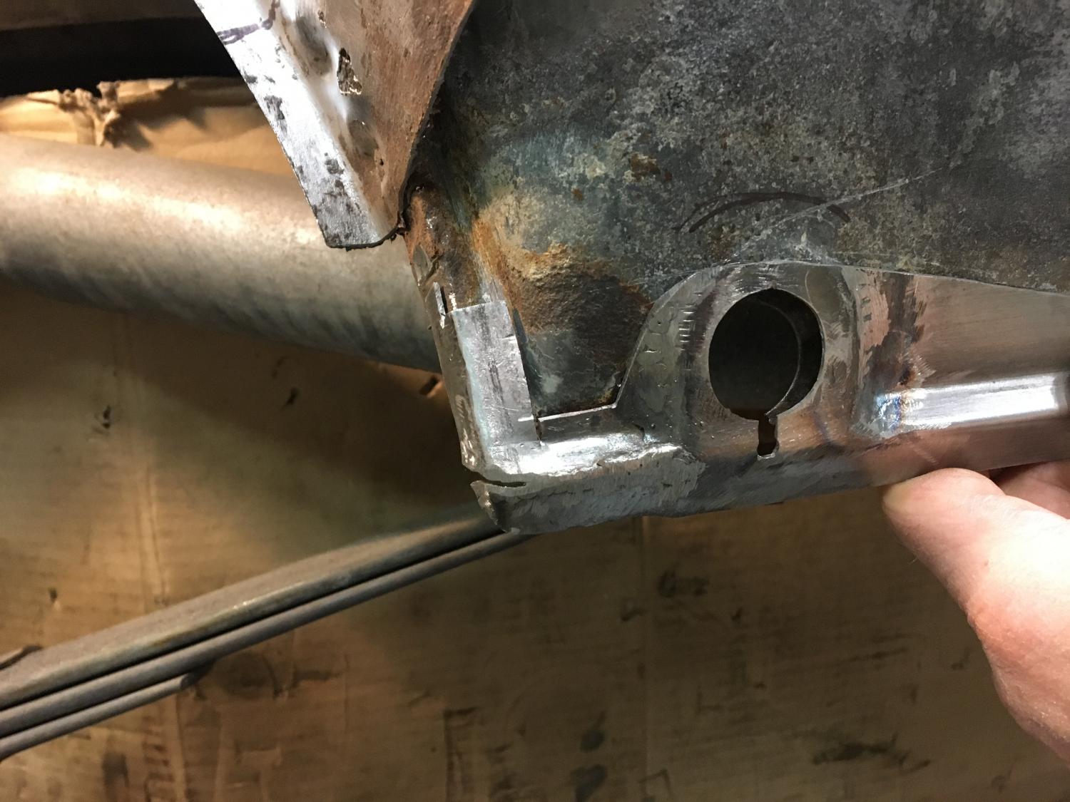

While the rear portion of this LH trunk drop was a little better than the RH was;

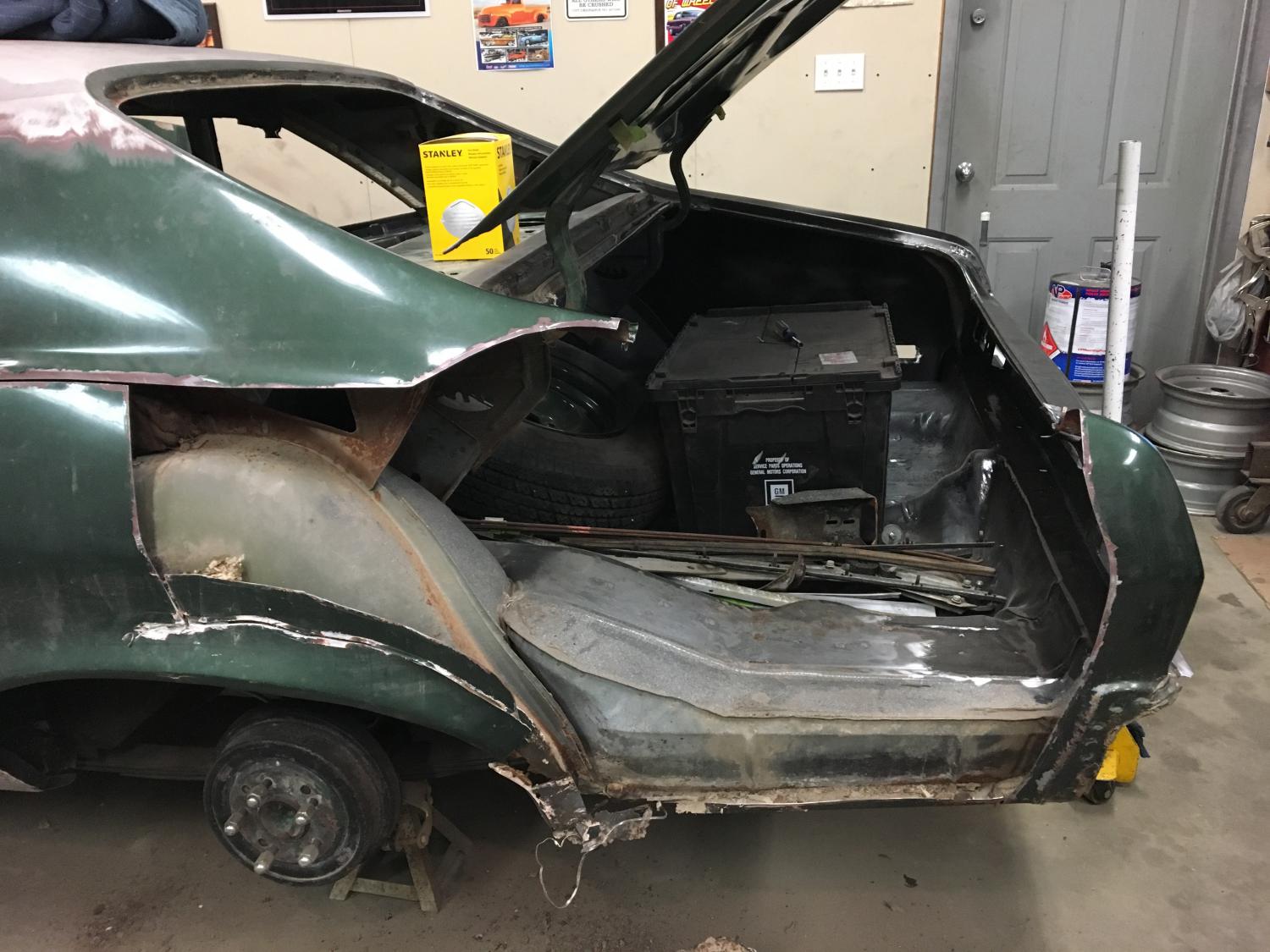

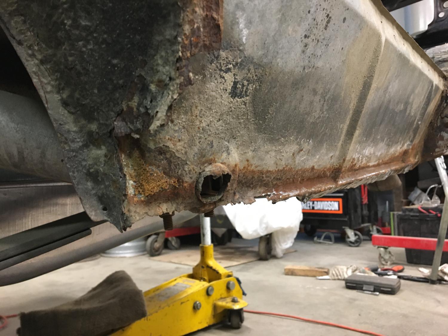

The front portion was a little worse;

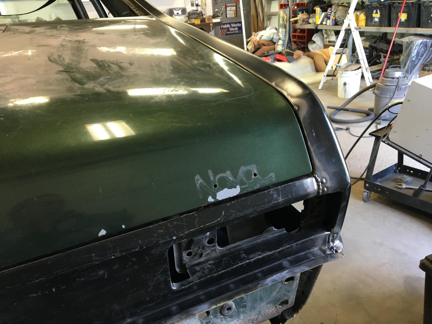

This patch was a little more challenging. I was able to find a piece in my scrap pile with a portion of the round raised shape to begin from. Drilled and slotted it out to match the plug then welded it in to the piece of replacement flange (similar to RH side).
Quite a bit of cutting welding and grinding for such a small patch but I wanted to copy the original shape as closely as possible. I was happy with the result. finished from the underside you cannot tell from factory.
