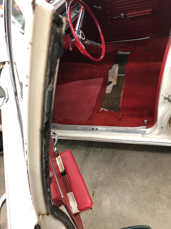

Additional cleaning of door jambs and new seals from Metro Super Soft, note the interior red overspray onto the door shell. I love old oil change stickers, and the pinch welds are rather nice, don't you think?
The plastic trim surrounding the rear opening was dry rotted and crumbling away, no replacement available. Using some red door jamb windlass from my stash it actually is trimmed out nicer than the original.

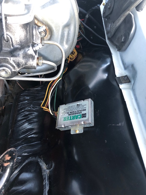

This rat's nest "CARTER Emission Reduction Kit" was attached to the left inner fender, and since the holes were there I opted to clean it and put it back, tidying up the wiring and tucking behind the booster. Note how it instructs to set base timing at 4 degrees less than spec, that would be TDC !!
Conversation piece if nothing else.
I've seen these on other SoCal cars, was it required in all of CA, or maybe just an LA County thing??

----My understanding on actual smog pumps mandated in California is that certain cars built after January 1 1966 had to have the set-up that is on this 67 COOL wagon! I could easily be wrong and it won't bother me a bit......Bill S

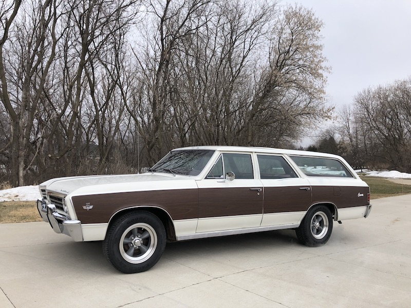

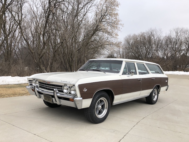

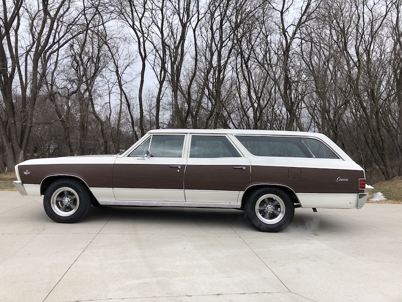

We went from single digits to almost 60 here, so let's get some outdoor pix!
First up, original wheels and poverty caps, as built. The stance might be a smidge high, but I like it this way.

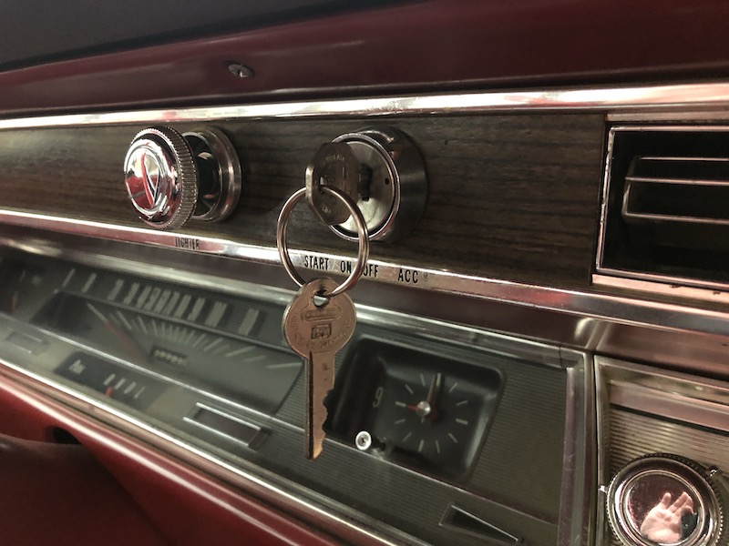

Couldn't resist another shot of the dash, I love 60's red interiors!!

Neglected to mention earlier, I have original keys and POP also.
Here's TT's for comparison.

Bill, I would be curious to know what kind of motivation for adding that Carter kit beyond the factory installed K19 smog stuff, mandated for smog check?? Hoping the CA guys here can offer some insight.
