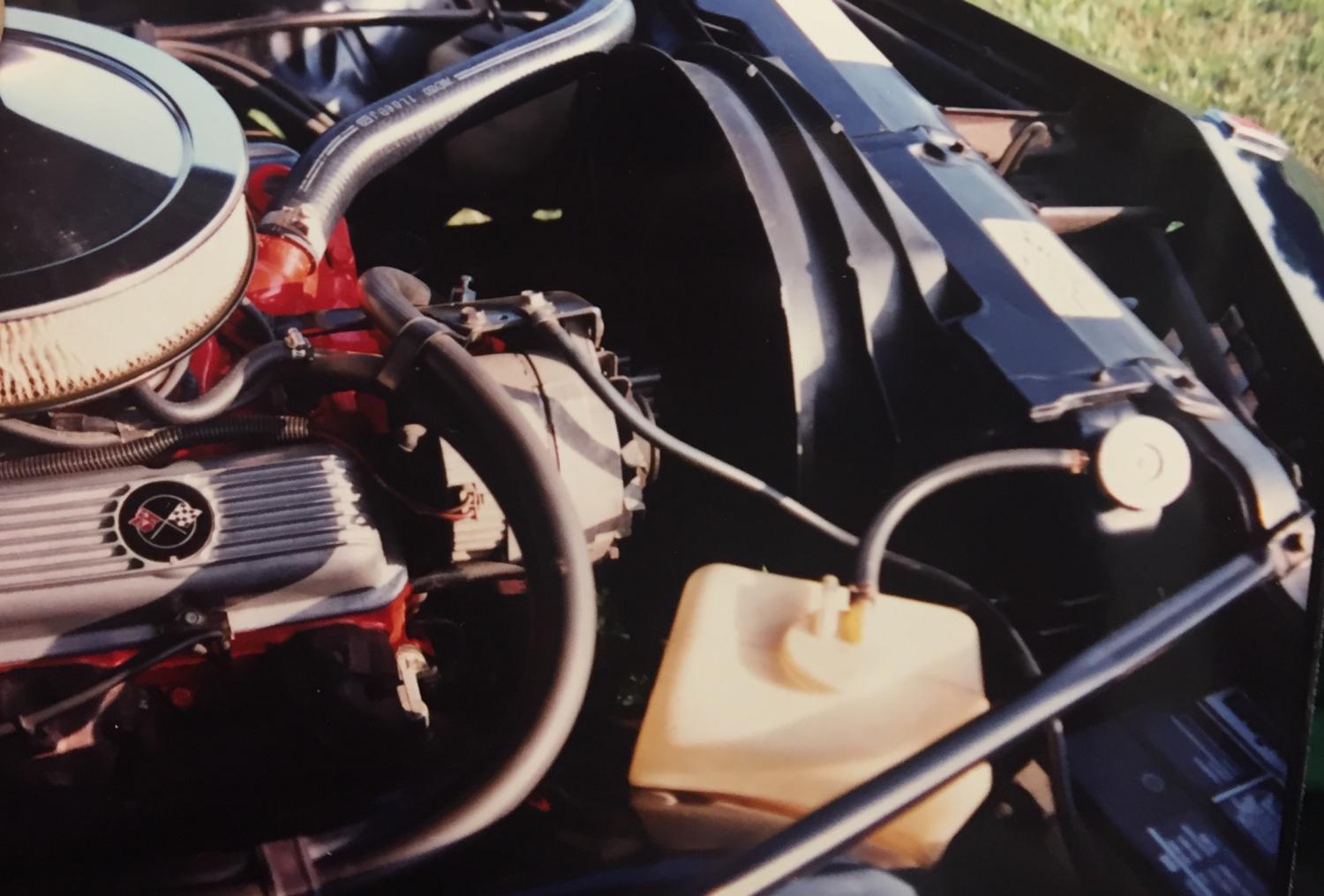

Originally Posted by L72copocamaro View Post
How does the RS not require front bumper guards yet the non RS has them?
On the RS, they added several additional reinforcement bars that were not there in 1972 to meet the new crash requirements. The bars from the radiator support to the front fenders were also longer so the engineers did their diligence and testing.

These bars:
Left and right fender to the core support.
Left and right core support to the reinforced hood latch which was connected to the header panel.
With these 11 unique support bars found on only the 73 RS. Very hard to find if you are missing them.

Yes the remaining bars are core support to the header along with the reinforcement plate.

Originally Posted by 70 copo View Post
These bars:
Not sure when the photo was taken but this also seems like a great color photo example of the factory finish on valve covers...

I believe the extra bars started in the beginning of production as they are in the assembly manual. 73 changed from a bow style headliner to a board style by the 3rd week of Feb.
I refinished mine and think they are close.
