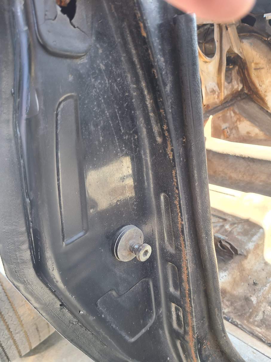

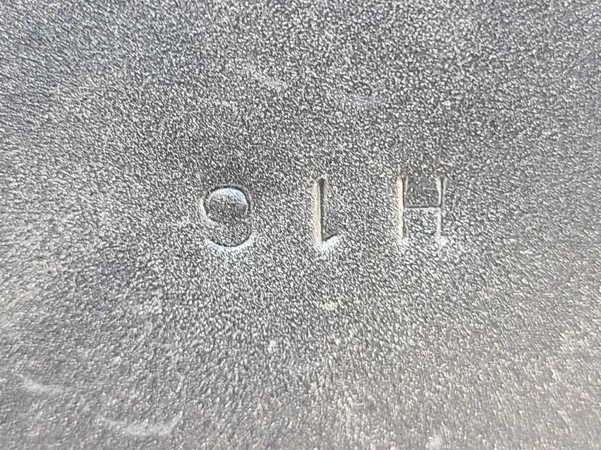

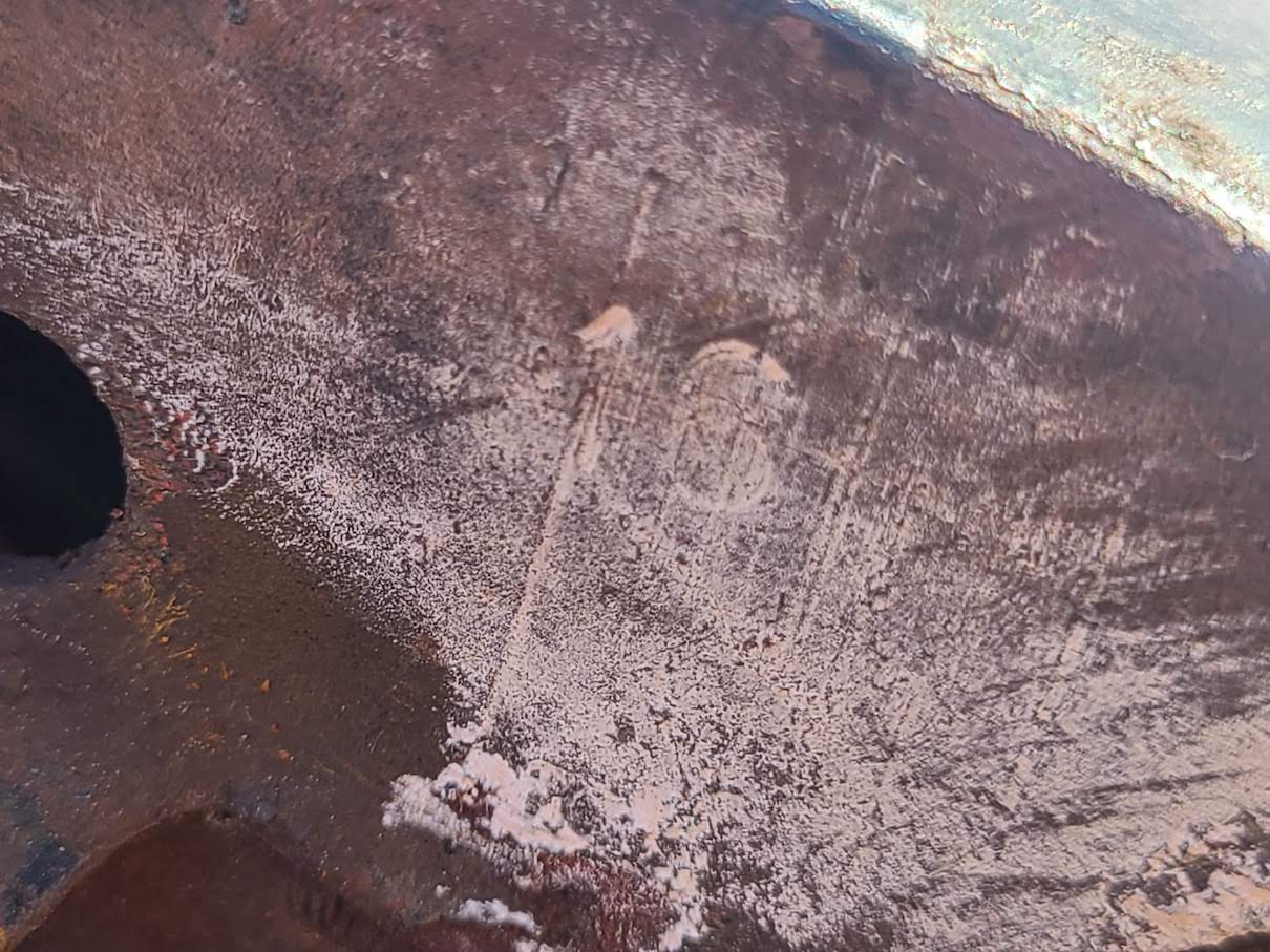

Here are the dates on the sheetmetal. It appears as if the tailpan was replaced. The decklid is a '69 repop. I believe the front valence and header panel are original but I can't seem to find the stamps. I'll ad those to this post once I locate the stamping. The quarters have been patched but thankfully are savable.
The RH fender stamp was so light and very difficult to capture a photo. I've flipped the image to make it easier to spot but it's definitely a 14. Next post will document the glass dates.
Tailpan LH 9, RH 52
Quarters LH 14, RH 16
Doors LH 15, RH 16
Doorframe LH 14, RH 16
Fenders LH 16, RH 14

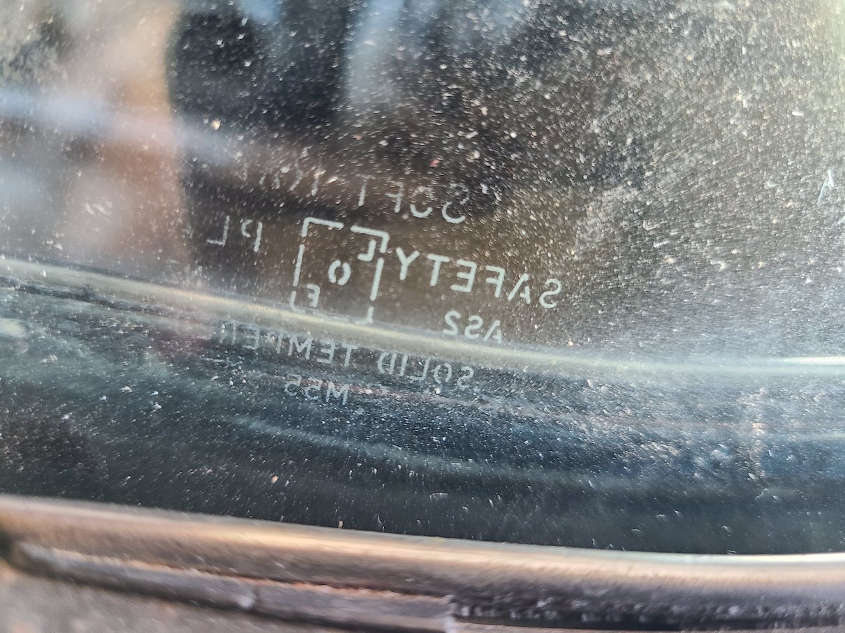

Here are the photos of the glass codes. All photos were taken from outside the car. I've decoded the dates and the windshield has clearly been replaced. Anyone want to take a stab at dating the windshield? Next I'll post dates found of other items on the car.
Back Glass NZ January 1967
LH Quarter NZ January 1967
LH Door XZ February 1967
LH Vent 126 December 1966
RH Quarter NZ January 1967
RH Door XZ February 1967
RH Vent 86 August 1966
Windshield REPLACED

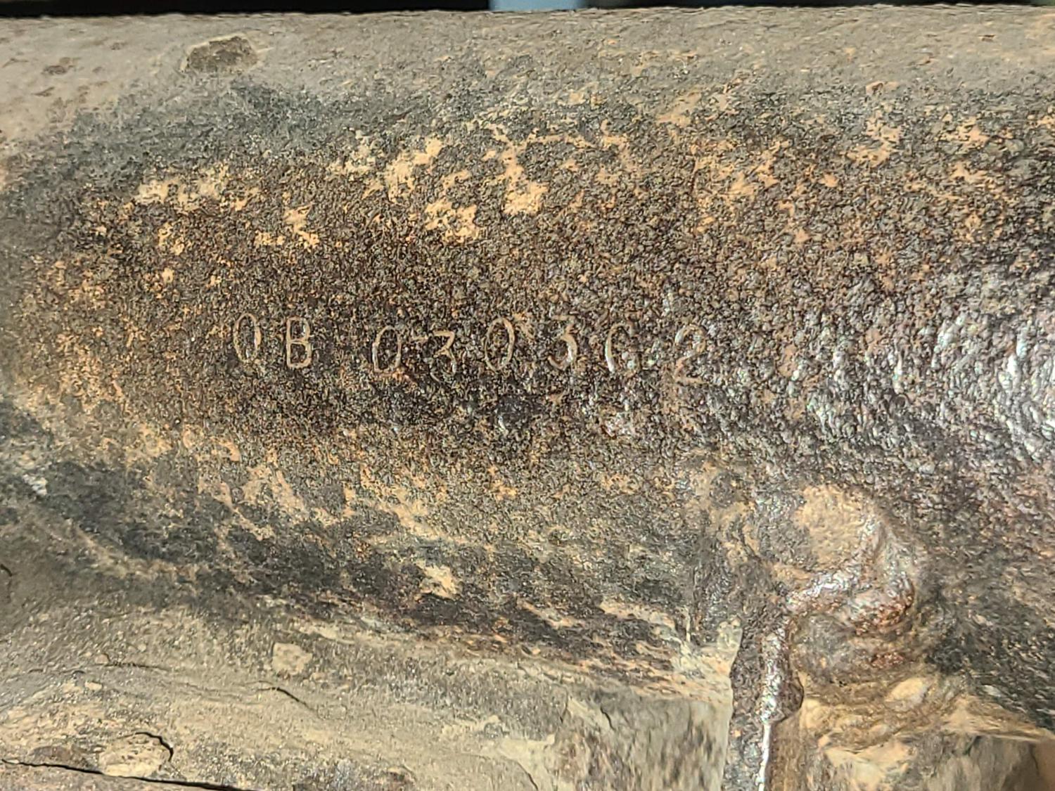

Here are other dates found on the car. This area along with others will be expanded as new parts are dated. Please PM or comment if you can help identify dates/information.
I found multiple burned wires and foil wrapped fuses. You can also see where the circuit is burned on the back of the cluster. I'm assuming this is what took the car off the road years ago. It's a miracle this car didn't catch on fire.
Console Gauges April 18? 1967
Cluster April 7, 1967
Hold Off Valve 75-7 (Thursday March 16, 1967)
8515 Booster 82 (Thursday March 23, 1967)
Rear End Casting L296 (December 29, 1966)
Axle Stamp 0303 (March 3rd, 1967)
Vin Plate 557 9 I need help with this one. I'm guessing dealer delivery of May 5, 1967? Not sure what the 9 means?
