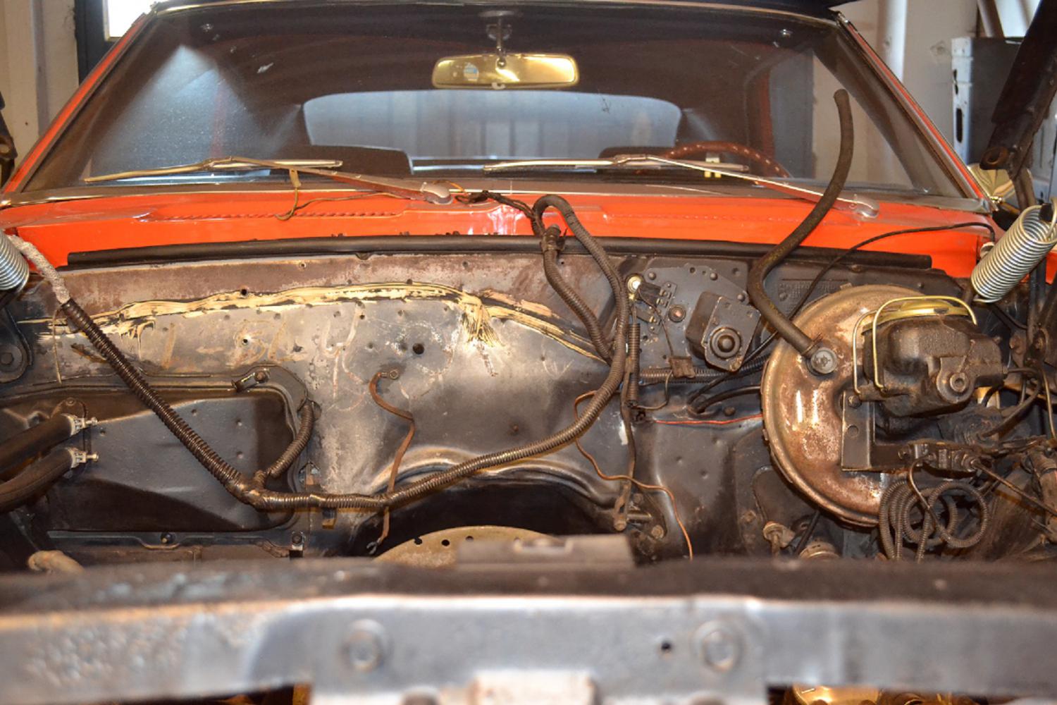

Written on Firewall
427 425 Special Order 427
427 425 L BLU S SYC
M22

Sorry but all I’m seeing is GL-BLU & RS. Also it doesn’t appear to be a cowl induction car originally at least from that photo.

First week of 9561 production, Baldwin didn't know about COPO's yet, neither did Motion. And the body # is normal production, as noted above by Dave, DW31S.
I have a document that states this car was sold by Brahms Chev in NJ and they installed a 427. Not sure of the validity of the doc.
Firewall - L BLU = light blue
Kurt S - CRG

Okay its not a COPO.
And its not BM Demo.
And its not Heavys Camaro
Good thing you pointed out that L BLU means Light Blue had never figured it out myself

You never thought that the Yenko cars had the COPO 9737 and that they had to wait for special parts before they could assemble them. Other dealers who only ordered COPO 9561 went through the process a little faster

Heavy told Dan it was a COPO

If no cowl induction from factory, then not a COPO and a BE coded rear dated to the car would also be helpful to see. As I mentioned, it was most likely a X22 L-78 equipped car and then had a 427 transplant.
If it was the same orange SS RS car in the Super Car magazine article that Marty wrote, then Motion did the transplant. If shipping records show it was delivered to Baldwin, then good chance it is a BM car, but more history and research is needed.
