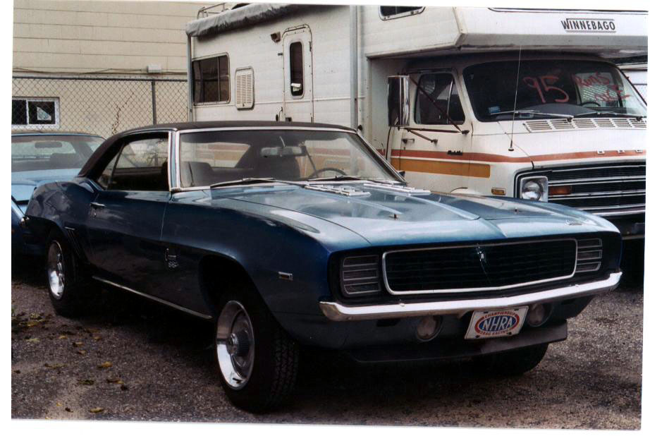

GotGrunt's Avatar
GotGrunt GotGrunt is offline
Join Date: Apr 2014
Location: LI, NY
Posts: 1,173
Thanks: 548
Here is a picture of Carleen’s car when it was still blue. I’m not sure what year it was taken but that appears to be a late 1970s dodge camper next to it.

It was I who gave that story in 2006 to Kurt Sonen based on what they thought about the car. Im the one who posted most of the pictures of her. The picture when she is Blue is from -94.
