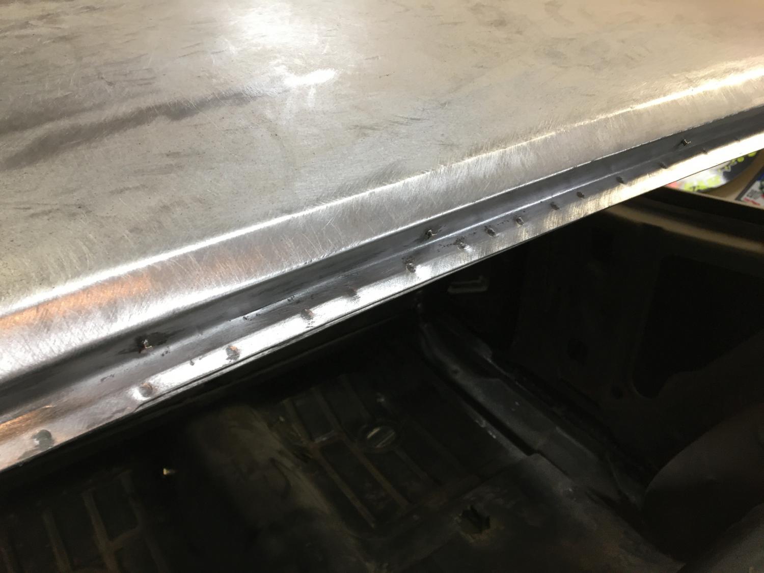

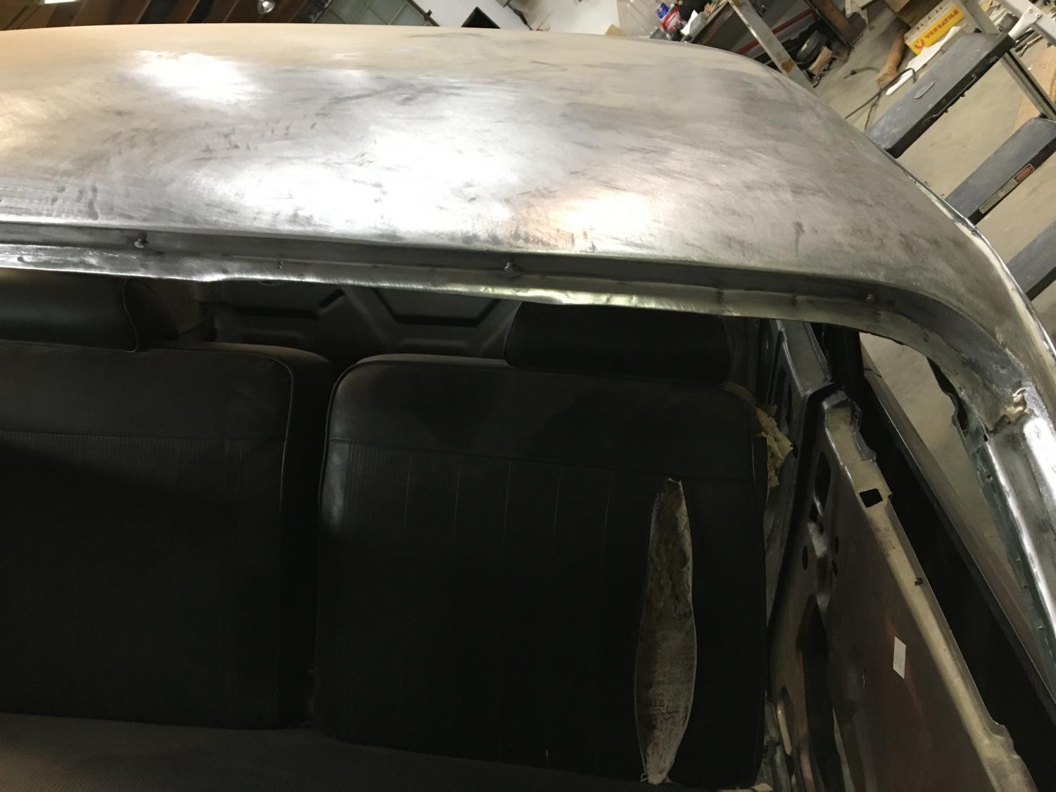

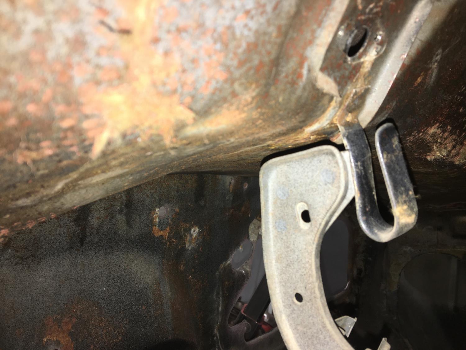

Well I suppose all those clutch dumps over the years cause a little stress here and there.
The brace from the firewall to the lower middle dash was fatigued and torn away. There was actually a small piece missing which I fabbed a replacement piece and welded in.
Top of this brace is broken loose and had been machine wired in place.

A little easier to see from this side

I did have to grind it a little afterwards to clear the defrost duct.

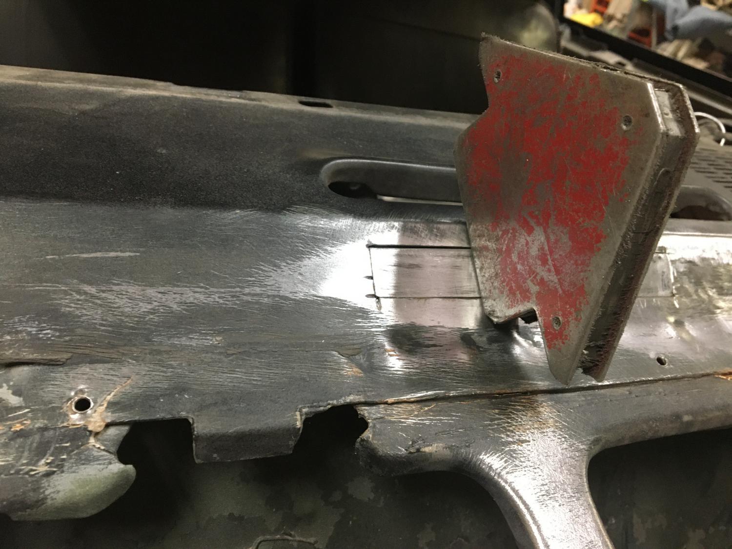

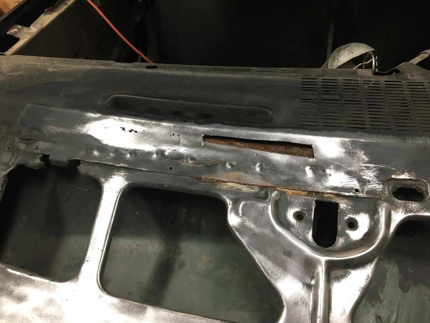

As the wire wheel stripping continued a few not-surprising pinholes were found along the lower Windshield flange. This is after picking at it pretty aggressively to find any soft spots.

Repaired this in two sections using patch pieces with a 90 degree break along the upper edge (trimmed to about 3.32" deep) to help minimize distortion (from welding) along the leading edge of the dash.
If you look closely at the top edge you can see the radius where the patch panel was bent inward.

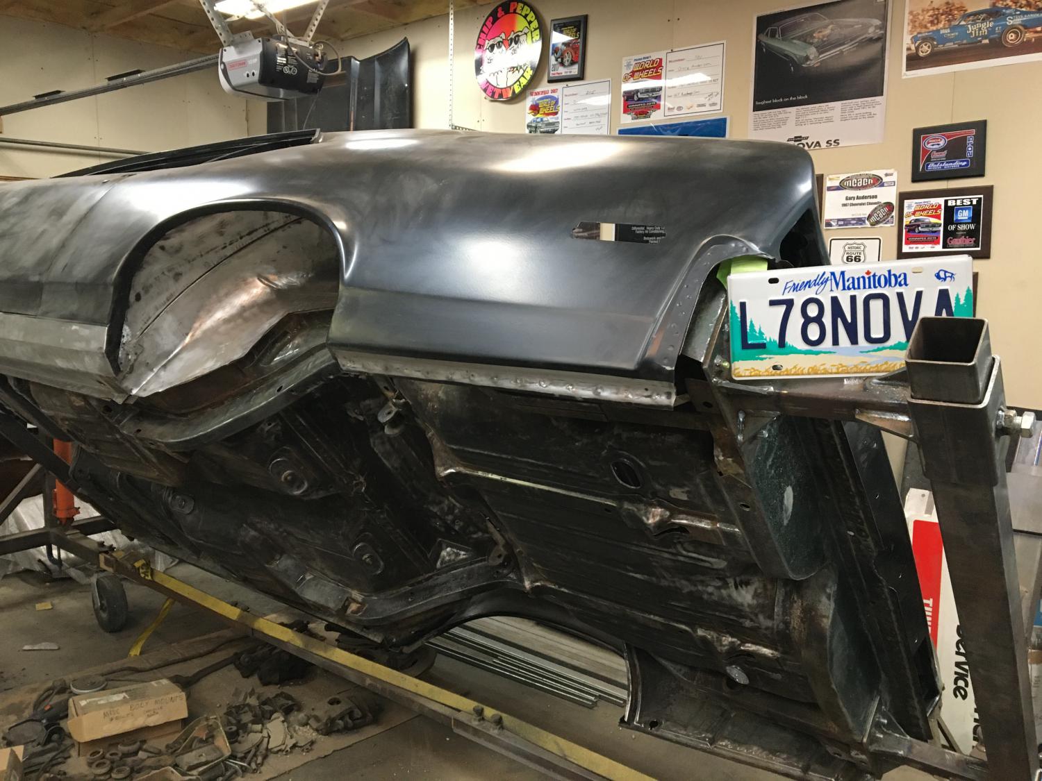

While on the subject of stripping... A few photos of continued cleanup of the window channels.
Also continued cleanup of the underbody
