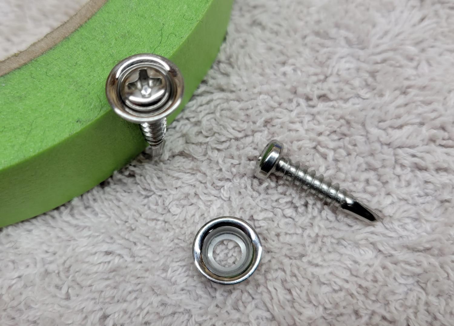

Im fortunate to have a dad that comes from a tool maker career. We both learned as we both started working on our 66 chevelles that the door panel screws are pretty unique. Its a very large washer that is used. Im assuming earlier years like 64 and 65 used them as well. I sent my originals off for chrome plating and thus to date they got lost. My dad set out to make a die and machine down SS screws to recreate the originals. Seen here is the outcome of his work efforts. They came REALLY nice. First picture is an original off my car when I took it apart.

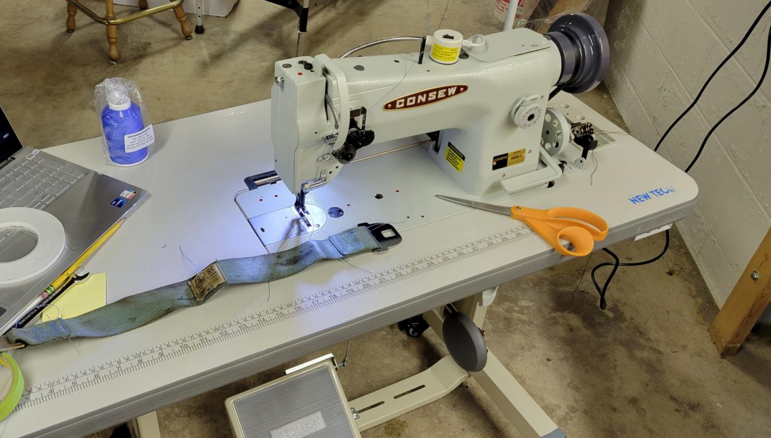

This project I really went out on a limb and decided to purchase a Consew 206RB-5 sewing machine. There commonly found in upholstery shops. My first task for the new shop tool was to resew the 66 Deluxe seat belts. I had a few hours of trial and error with the correct box and straight stitch that GM used on there original belts. Seen here below is the process I finally worked out where you used sewing grade double stick tape to hold the fold over together before you lay down the stitching. Final picture is a finished Buckle assembly with box stitch.

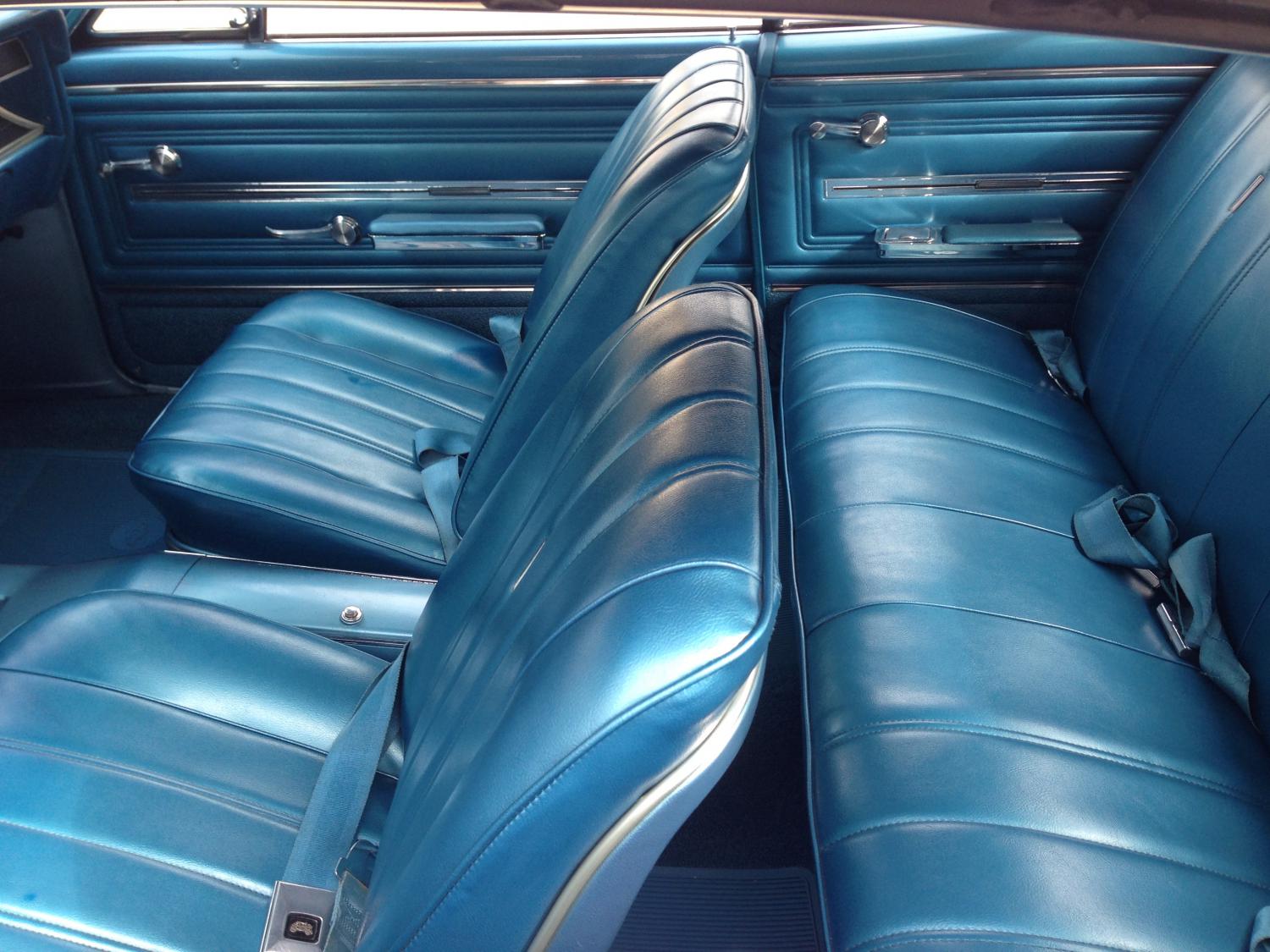

I have observed an ATL '66 L78 with the straight covers, don't recall the TT date.
Attached is my 10C ATL '66, far too early to be L78. Early '66's have several unique features. - Bill W

Thanks Bill. I think dads car is a mid to late April build. So it sounds like the tear drop style vs the straight may have been more of an early vs late? BTW I love the picture of the seat bottom highlighting the seat colored pipping. I have to wonder sometimes if the knowledge has been lost that they are suppose to be color and not chrome.

My Marina Blue 66 SS L-78 04C Atlanta with Deluxe Belts
