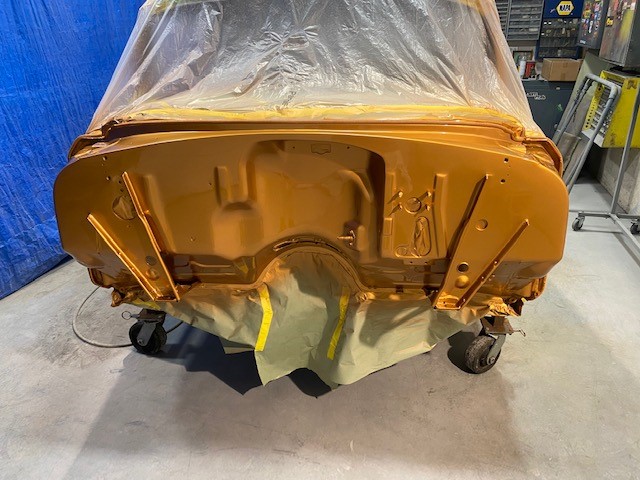

Cant wait to see this color on the outside of the car! This is with the semi-gloss clear!

WOW, I would be tempted to paint the top with gloss clear from seeing that. It would look like a polished brick of gold...

Spent all weekend painting. The car is eating base coat. Already down 3 quarts and will most likely need another gallon to finish the car. Inner doors and door jams all painted along with the firewall. You can really see the difference between the satin and the gloss clear on firewall. Really changes the color. The satin clear almost leaves a pearl like appearance.
