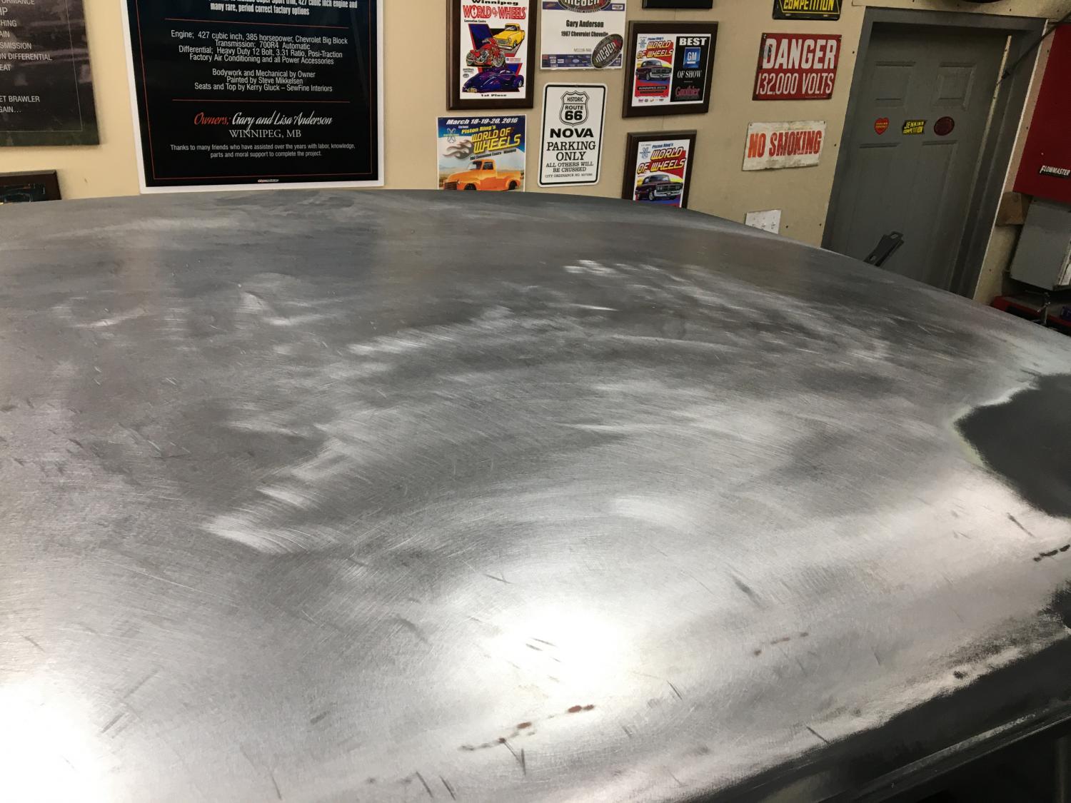

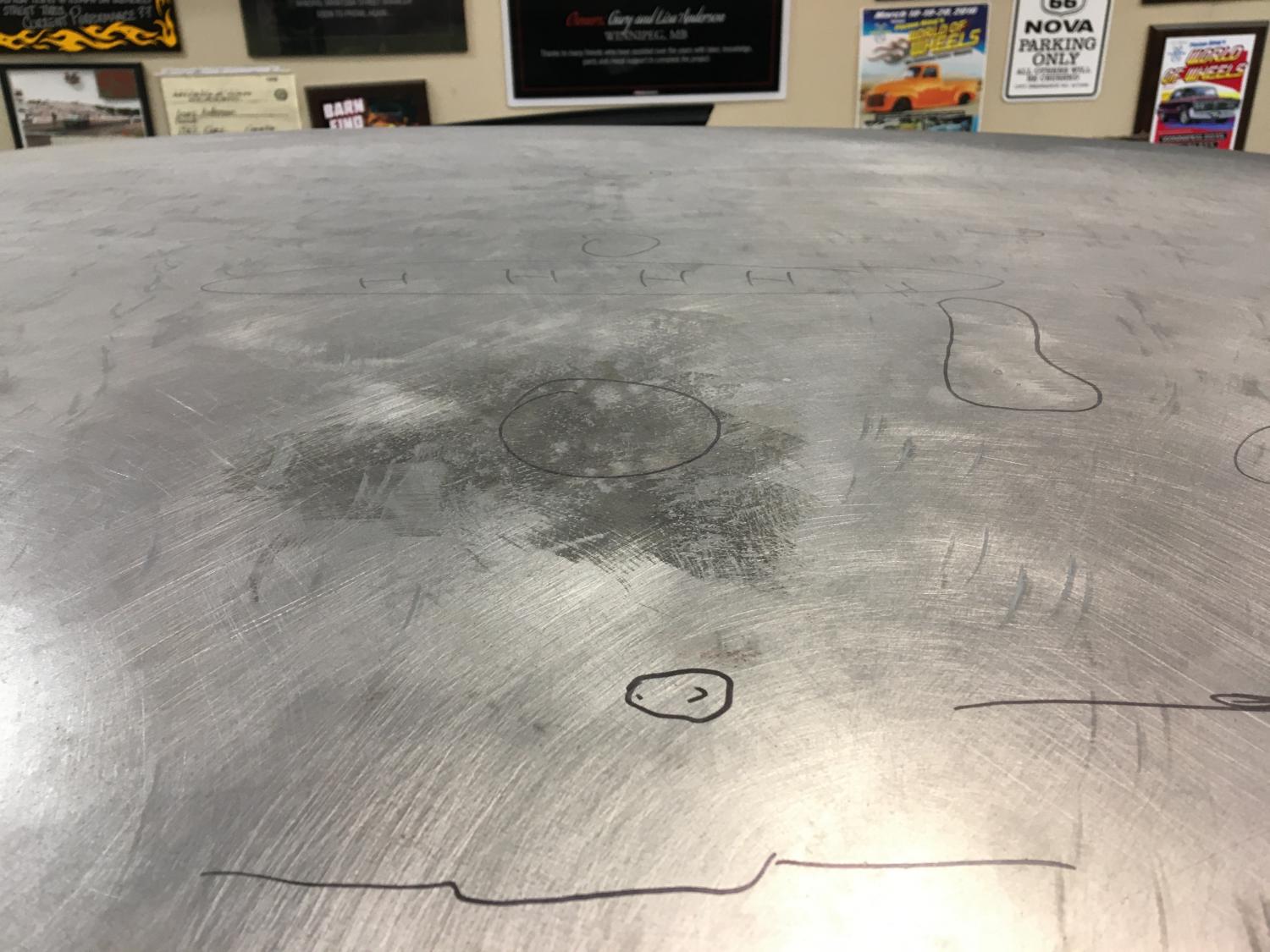

Well the Green bastard rears it's ugly head once again. Stripping the roof revealed some significant previous repair / damage. There are many quite rough gouges from a previous strip job and an area of Very heavy filler.
I suspect the aggressive stripping caused some heat and stretching of the metal resulting in oil canning. Apparently the cure was three HEAVY blows with a soft pointed body hammer which probably tightened up the panel but then required the heavy filler.
I worked out the hammer blow dents and did my best attempt at shrinking the panel but... I realized my limits here and reached out to a professional.

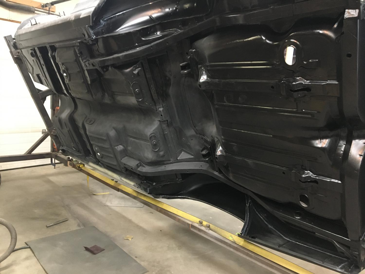

Around this time (June July 2020) having been recently separated and with the Covid restrictions in place... There was A LOT of activity happening in the garage !
Couple shots of the BEFORE in epoxy primer
And preparations begin for a semi-gloss finish coating (two coats DTM Urethane)
And once again... as Skee Low would say "I wish I was a little bit taller".

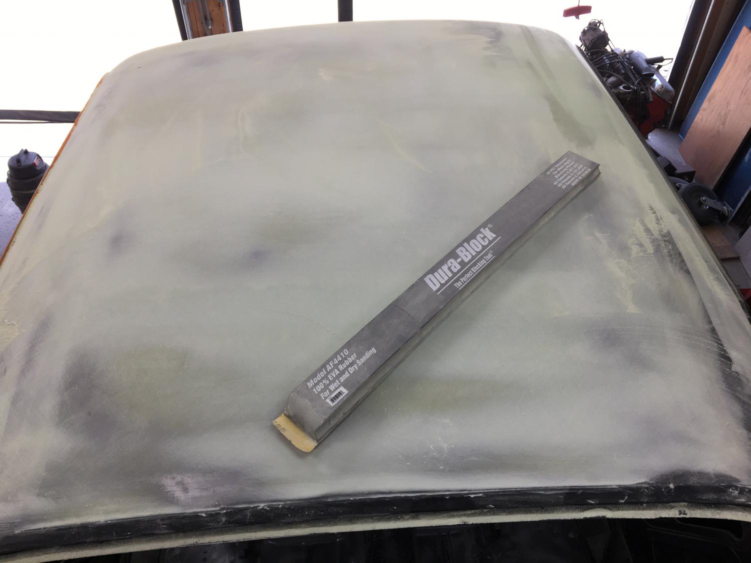

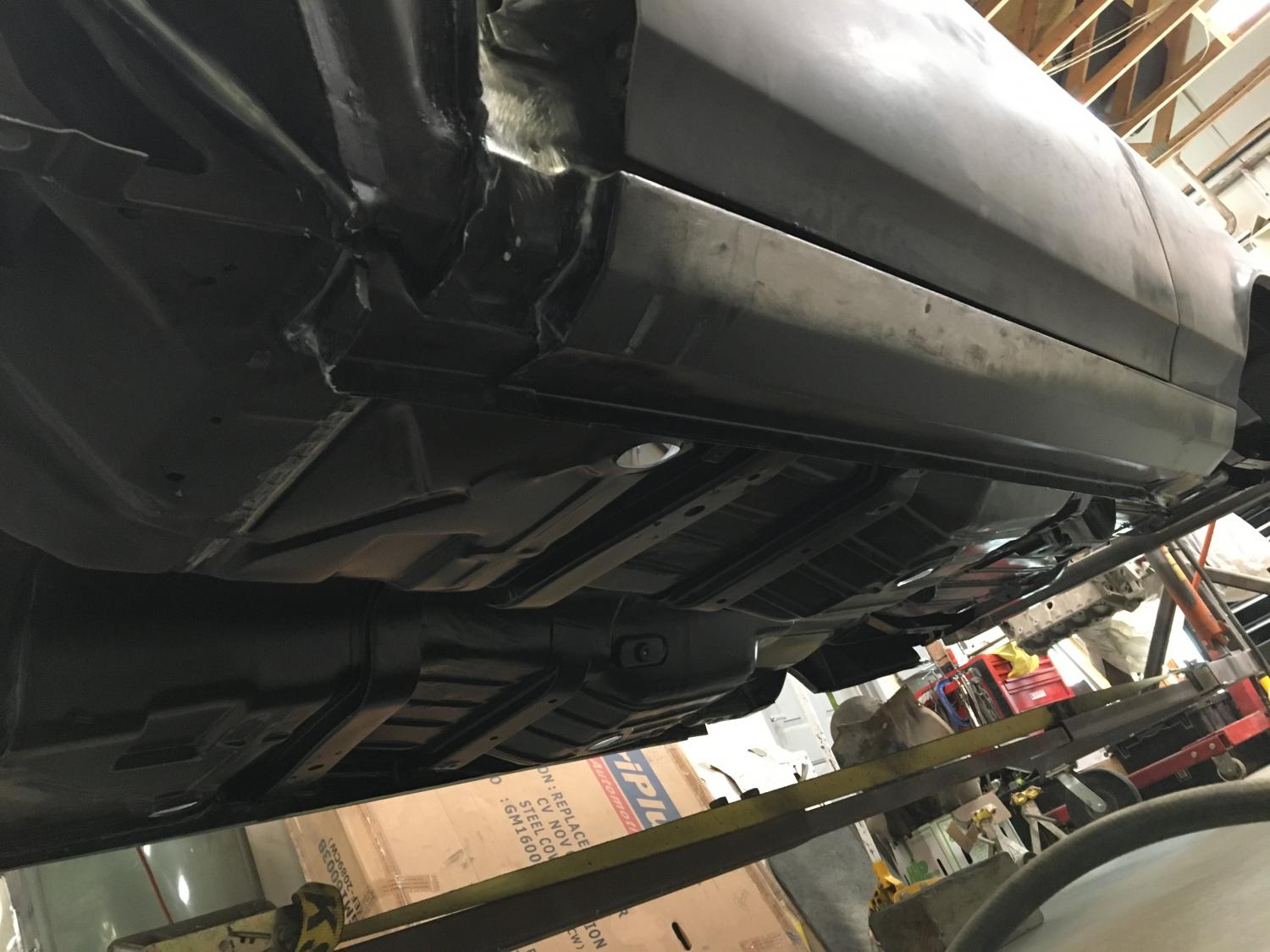

Now back to Bodywork on the Roof.... A week of holidays was a full week of 12 hour days bodyworking the roof.. never said I was fast ! The weather cooperated with high temps well in the 90's every day. It was Gruelling !! (I will foreshadow that it turned out beautifully after paint)
Reinstalled inner structure
Full skin coat of Bondo (couple rounds)... followed by a full skin coat of polyester glaze (couple rounds)
Looooooots of blocking and repeats
Once I was happy with the base work it was all sealed with DP90 (a little pebbly shooting it in the heat)
Some more spot repairs and DP90 sealing...
Then a full cover with high build primer and another round of blocking

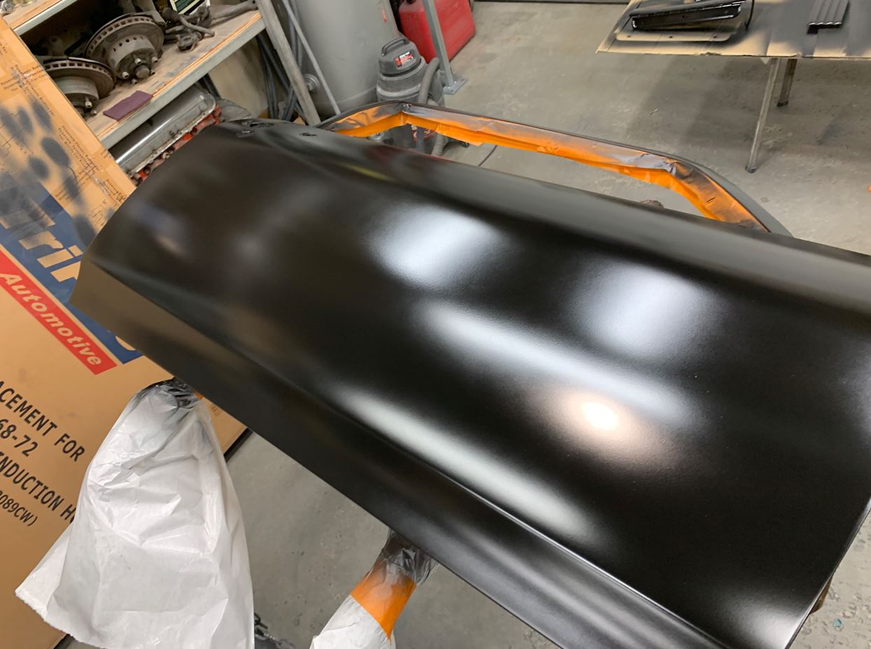

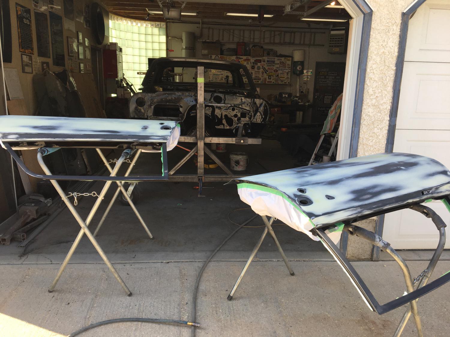

Doors had previously been stripped hung and aligned and epoxied.
Now onto the finishing work
Several rounds of bondo, blocking, glaze, blocking
Another sealing coat of DP90 Epoxy
