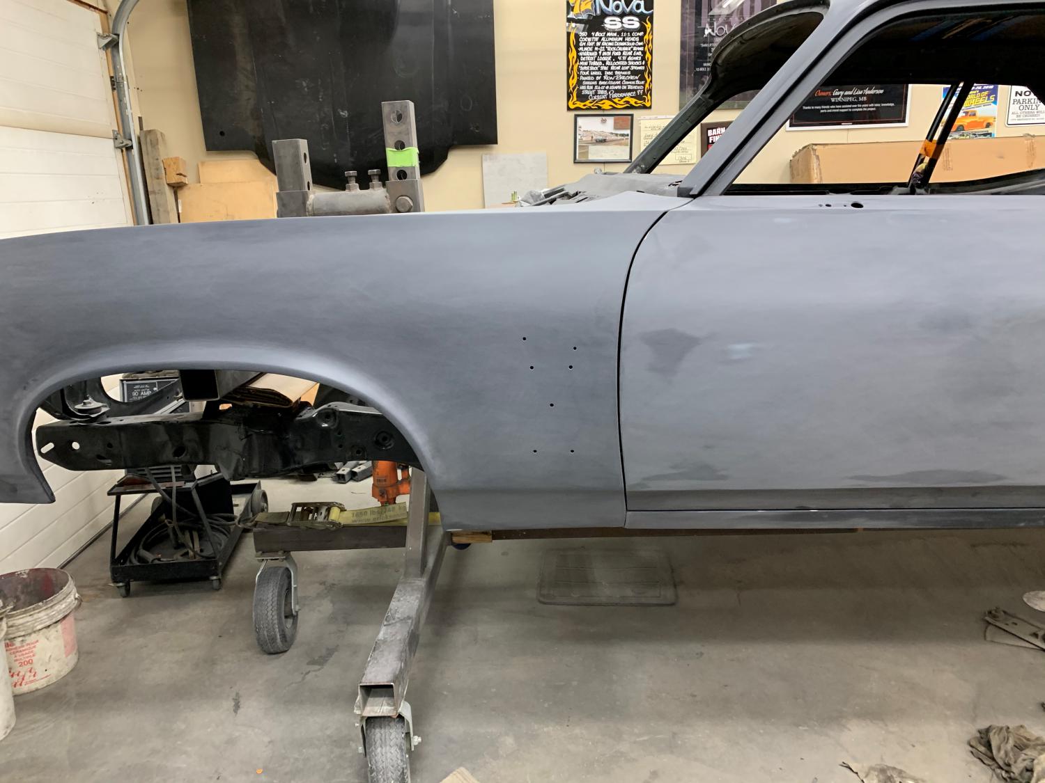

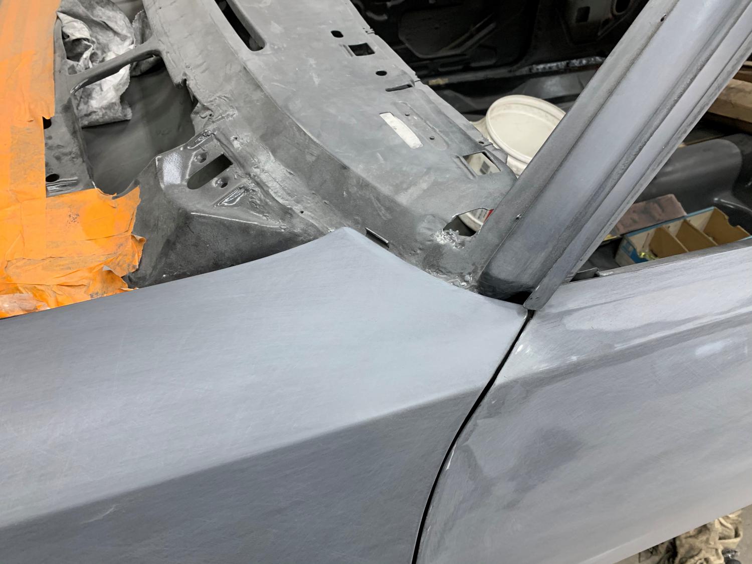

Rough hanging Left front fender...
Some bumping and filing of some dents. (and a little bit of shrinking)
Lower reinforcement behind wheel was welded in crooked on the NOS fender and there was some very rough formed metal at the opening.
Cutting it loose to reweld correctly and repair.

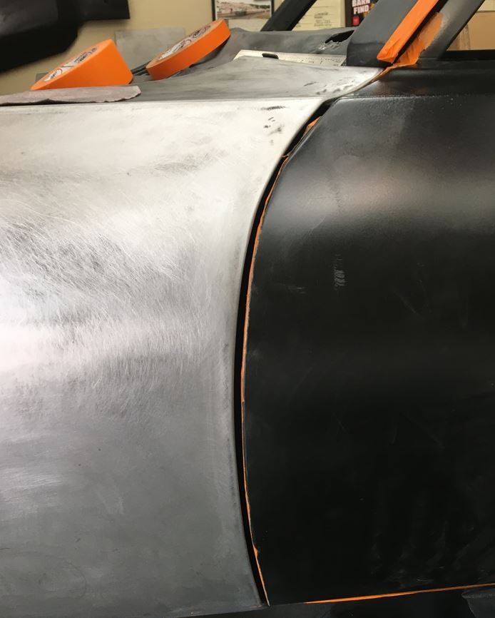

rough alignment and shimming done
This will clearly need some work on both the fender and door
(this was found before the prior post of the door work)

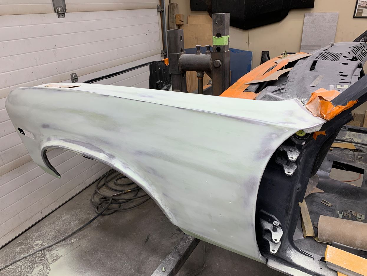

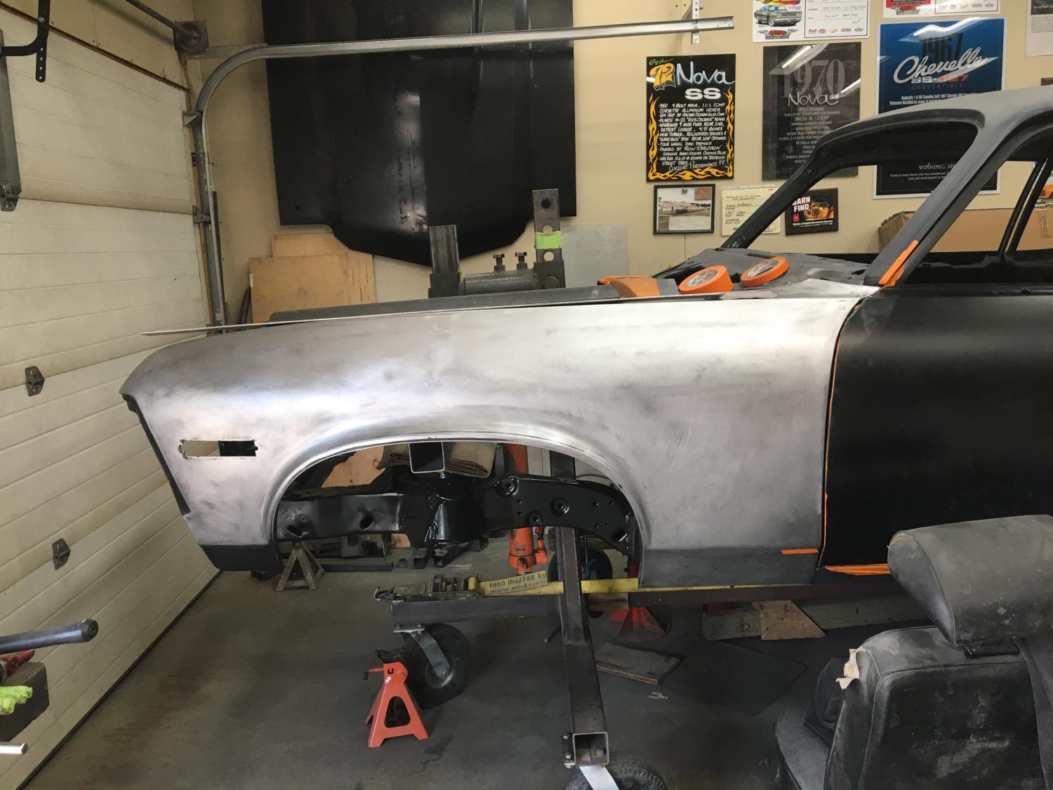

Another extended hiatus... Sorry Guys. Work has continued... time to catch this up as these photos are from late 2020.
Found a couple lost pics of the Right fender work (getting better at extracting from the icloud).
Rough fit up. Need to work some high spots forward of the rear edge.

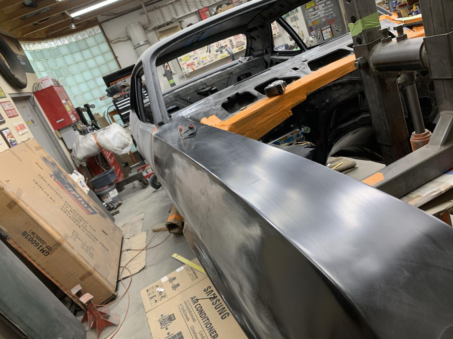

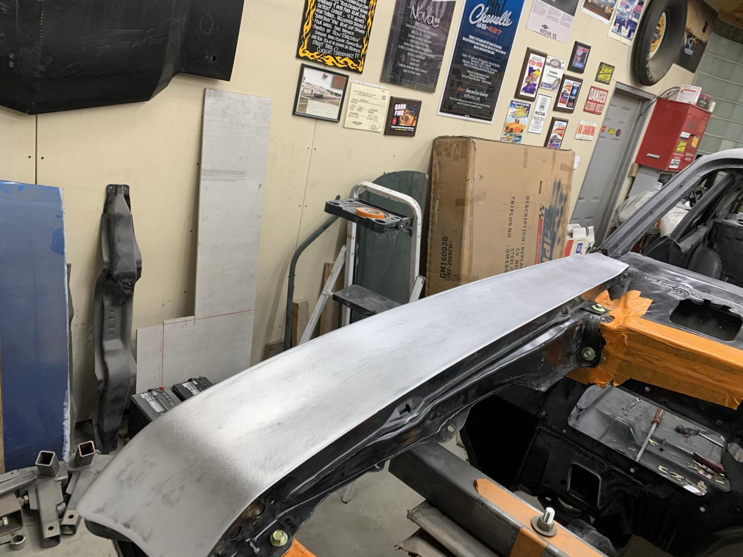

Original hood on the car was rusted along the front edge. A friend had a California Nova on which he had installed a cowl hood so... with some persuasion and cash I had a solid California hood. Good news and bad... "It is ready to block and paint" Umm, well looks like someone may have been a little aggressive when originally stripped so some extra work was definitely required.
As purchased
First hit with the blocking
In the mud work. Hoods are difficult, large flimsy areas require a huge spread of filler and it takes forever to block off with minimal pressure and lots of fresh paper.
Sealed up in epoxy
Underside re-sprayed in satin black
Later shot of final prepping the hood and trunk lid

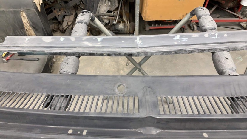

Stripping about 4 coats of paint from my best candidate cowl fller
Underside... yes each fin was carefully sanded, scraped, prepped and straightened.
