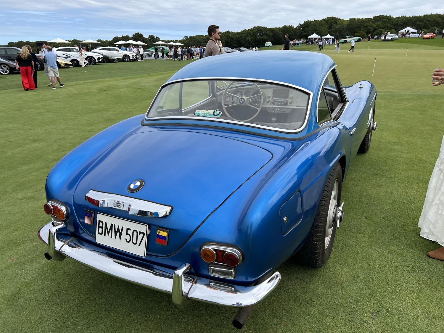

Dave, had the pleasure of seeing the elusive 507 just pulled from the garage in Philly. It was actually the second 507 I saw this past weekend but I’m not able to post pics of the first one. Enjoy! This is a 1 repaint survivor type.

That's my friend Albert's car. I'm headed up to Philly next week to see the one he owns being restored at a shop. I already went up there last year to take pictures of it. Him and his brother own three: a black one that sold at Hershey two years ago, the one being restored, and this blue one. Among other things, they have a bunch of 507 stuff too that I'll be browsing over.
He's intrigued by my project and loves the project updates I send him. Can't wait to get up there next week and get the more detailed photos I need of the door jambs and such for my car. The one being restored is in bare metal which makes for perfect structure photos.
