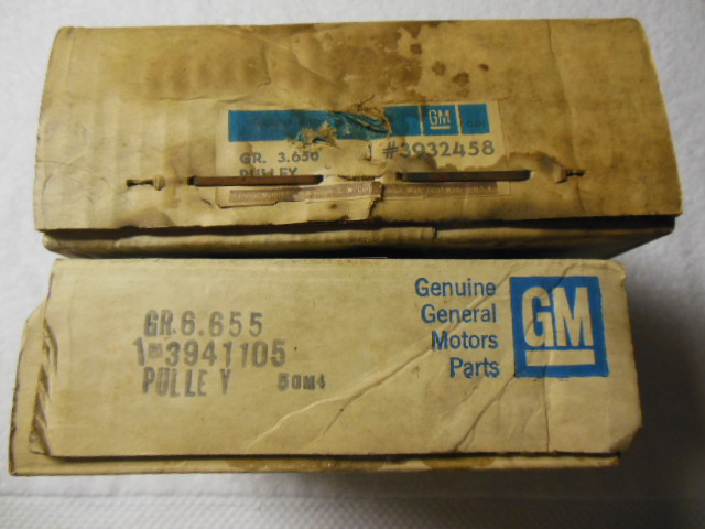

I am out of town at a garage sale and the guy was a car guy they will not let me open the boxes

The 3932458 is smog for 302 & 375hp. The other is power steering for the same application....Joe

3932458 pulley also fits 72-74 Camaro w/sp h/per 350 & 3941105 pulley also fits 73-74 Camaro w/sp h/per 350 hope this helps…….Denis Guenzel

Pretty sure the '458 pulley changed around 73 or so from a metal stamped number to an ink stamped number.
