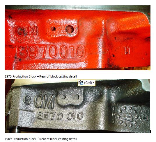

The Story as we know it:
Nickel was used to harden the bore surfaces so the ring seal is better. Tin was used to make the block heat and cool more evenly. Tin and Nickel are shown as percentages in numbers cast into the block under the timing chain cover.
A "high nickel" block will have either "010" or "020", which indicates 10% and 20% nickel, accordingly.
The best blocks have both tin and nickel, and show two numbers: 010 and 020, which means the block has 10% tin and 20% nickel.
Some of the the early 400 SBC were also 010 and 020 cast and quickly became the go to choice for the circle track racers because they held up and dominated the track conditions the aftermarket followed and that motor became the go to engine for that kind of racing.
  #36
Old 12-05-2022, 12:58 PM
70 copo 70 copo is offline
Posts: 3,834
Thanks: 219
When I say 302 and LT-1 I am specifically referring to the 010 casting of both and 010 castings produced in Michigan.
FORD had the Windsor then they had the Cleveland These were technically different block designs and as we will soon see GM did the same thing with the 010 changing the design at least 3 times while keeping the same casting number.
I asked about this. I was told that these subtle changes were accomplished to at first to transition the engine from a high compression centric design then later again to adapt the block to better meet durability and emissions as GM moved to a corporiate engine usage format. These later 010's are the two bolt variants and are easily recognizable by the small pad where the usage designation was stamped which was shared by the 305 also.

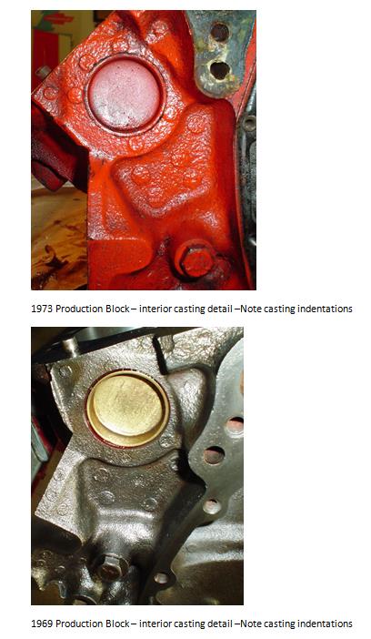

The evidence:
  #38
Old 12-05-2022, 01:03 PM
Posts: 3,834
Thanks: 219
Look at the design. Casting is different.
  #39
Old 12-05-2022, 01:06 PM
Posts: 3,834
Thanks: 219
More:
  #40
Old 12-05-2022, 01:10 PM
Posts: 3,834
Thanks: 219
Another:
