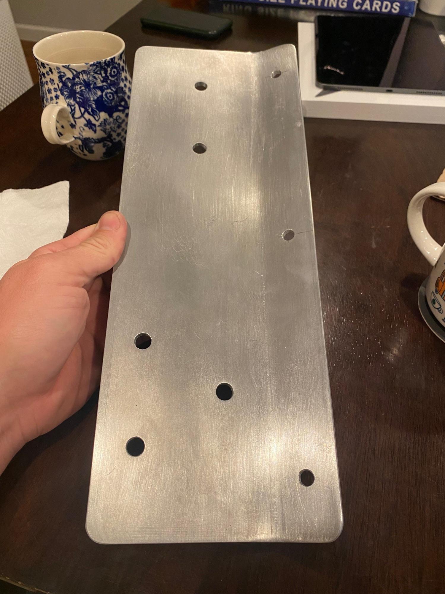

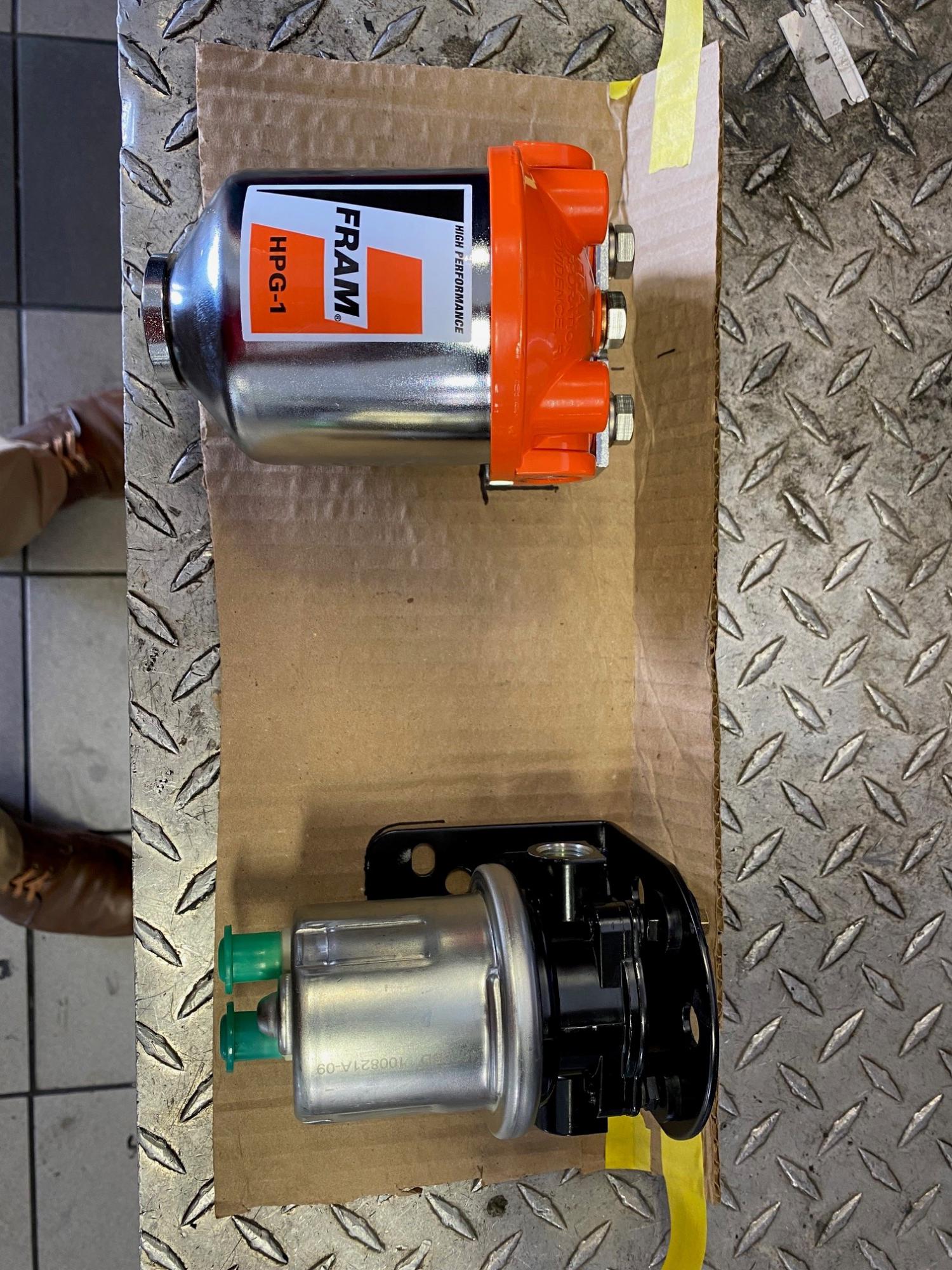

Here's the goods Tim... I made cardboard template then got some scrap aluminum and put it in my father in laws brake. Bent it at a 65* angle and drilled some holes for the filter and the pump. I will mostly hardline this to make for a cleaner install. I think it will most likely be a straight old school draw through system meaning the fuel will always be drawn through the pump whether it's on or off. The pump is a Carter 4600HP rated at 50 gallons/hour and 4.5-8psi.
