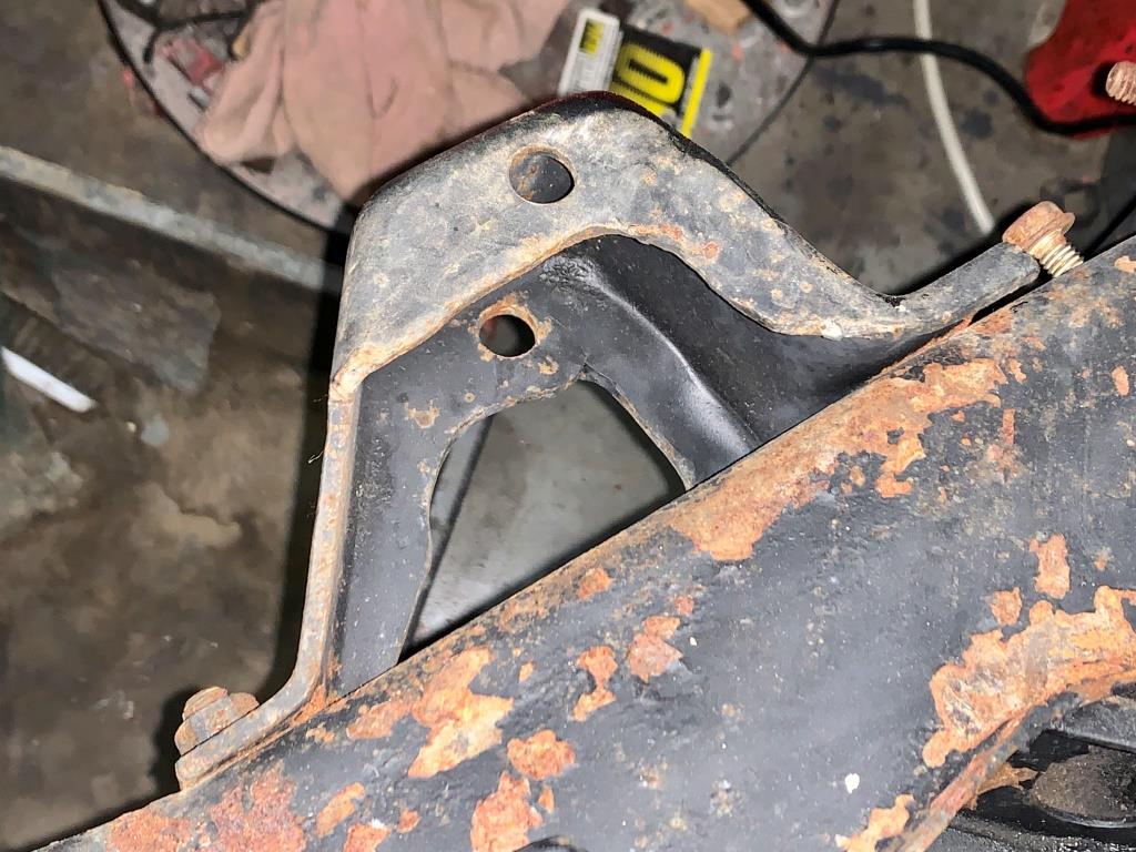

I have a 67 and 68 Z28 with the same style Engine Frame Mounts or Stands
(The ones that bolt to the Subframe).
They are definitely original to the cars and don't have any part numbers stamped on them. They also don't have the reinforcement on the bottom, where the bolts goes through.
I have acquired a pair of NOS #3955183(L) and 3980938(R) with the part # stamped on them and they both have the reinforcement bracket. These are supposed to be the correct part numbers being documented by David Pozzi Racing Suspension.
However, CRG indicates as the correct # 3892733, 3892734. I wonder if mine are these??
My question is should the leave the born with or replace with the NOS, which are considered correct and or the norm. I don't want to have point reductions when I get the car judged.
Thanxs Dave

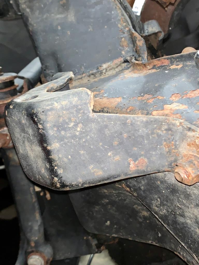

What is the build date of your car? IDK if it'll matter but curious is there might have been a change over point? Maybe not. My 12D LOS is has the sub off so I snagged some photos last night.

I looked at mine & they're just like Darrell's. NOS doesn't always mean assm line correct even if the judges approve of it. I'll find a better one to restore first.
Another thing I won't do is to modify a known original car to appease a judge....Joe

My originals are in perfect condition and look just like what Darrell provided, so I guess there're 3892733-34.
I thought mine were wrong because of not having the reinforcement. Glad to know mine are correct and thank you guys!
