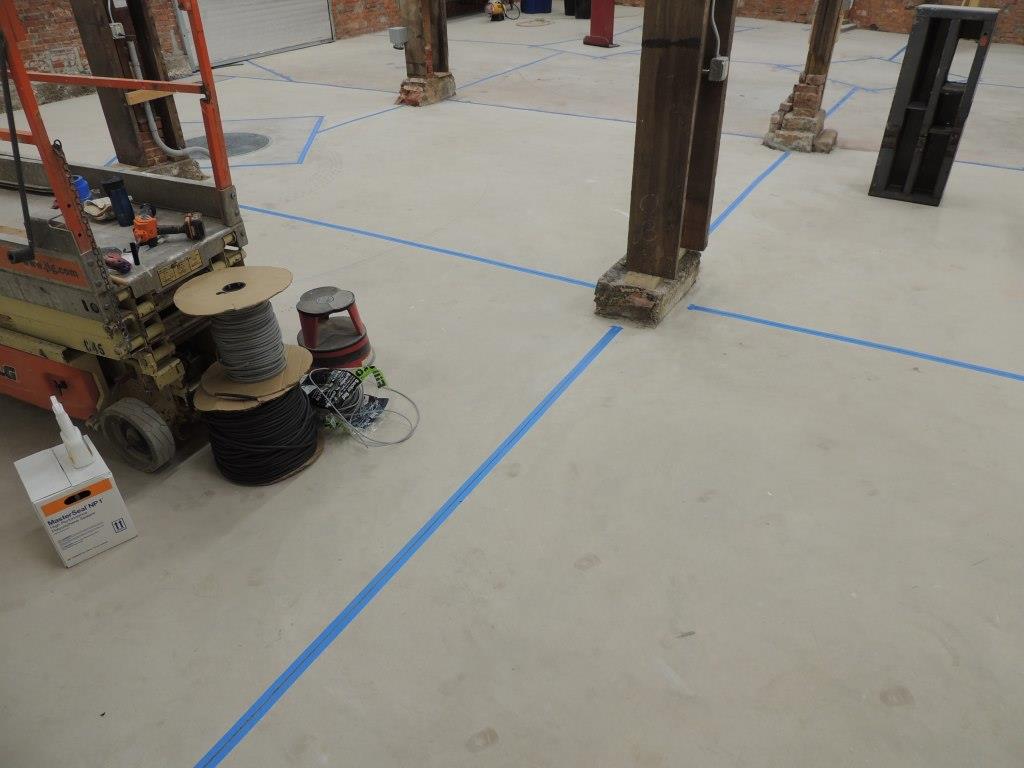

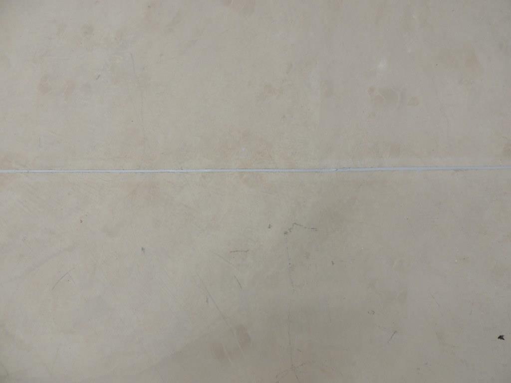

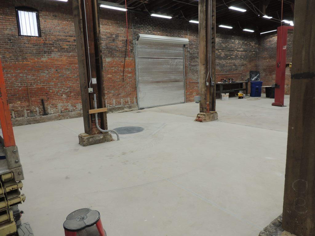

Getting close now. Devil is in the details, right?
Caulking all the saw cuts and other concrete joints. No glamour here, that's for sure. As with paint work on a car, the prep is as important as the application.
I spent Wed. and Thursday evening digging out all the joints and vacuuming. Last night (Friday) my angel of a wife helped me mask both sides of every joint in the joint. I don't care how good you are with a caulk gun, if you are not a pro, you have to mask these joints or they won't look good when you are done.
Here is what the floor in the shop end looked like when we were done. The pics probably won't all fit on one post, so I will follow this up.
dykstra (12-11-2022)

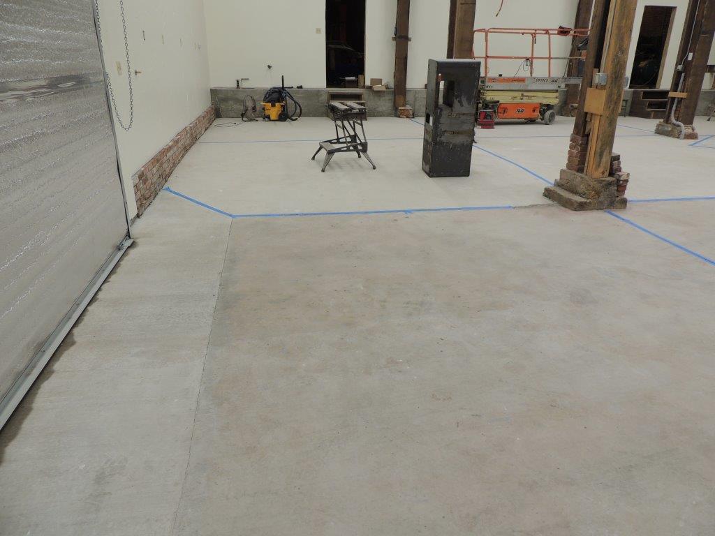

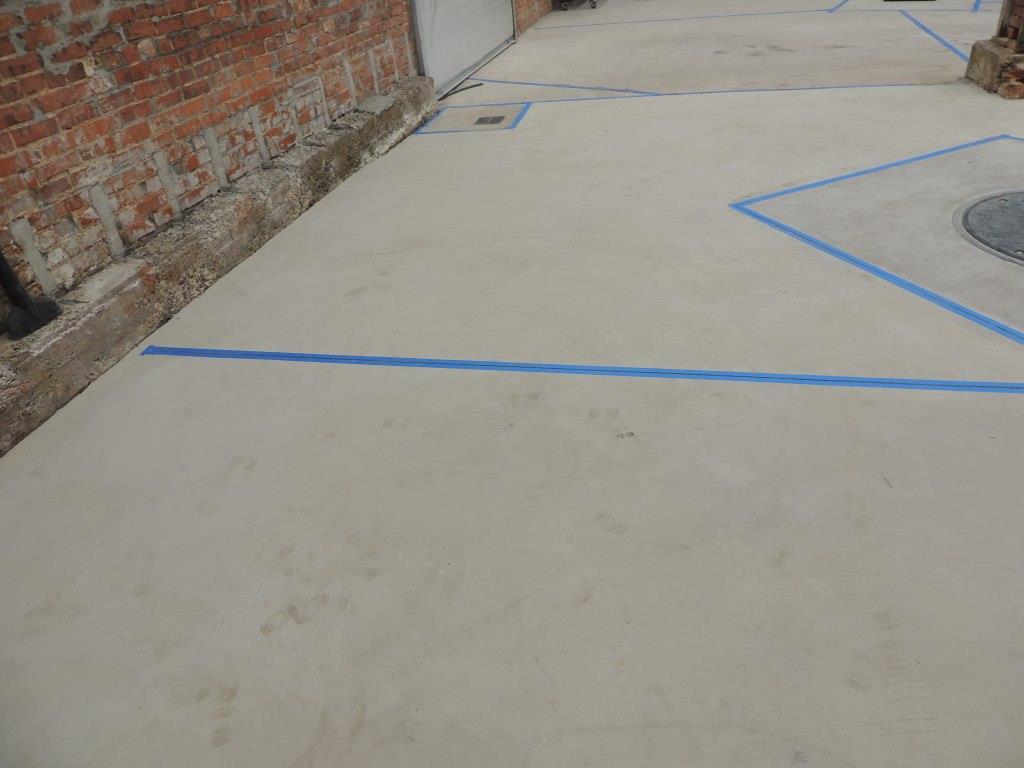

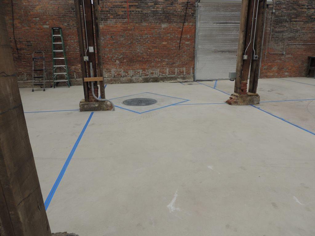

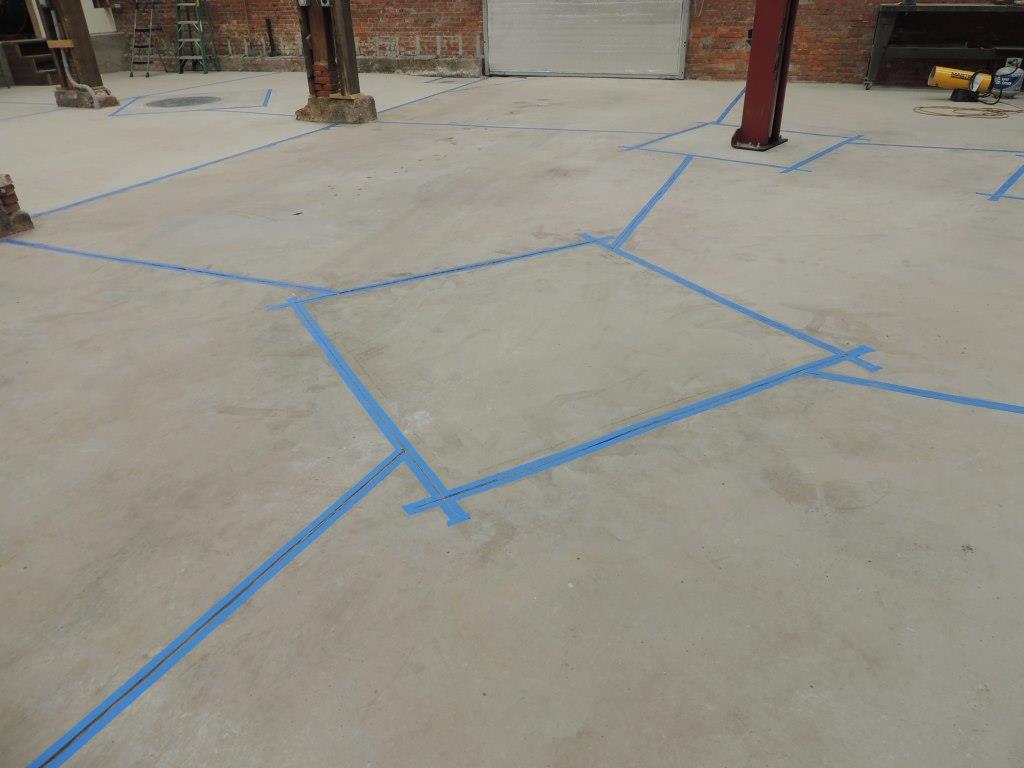

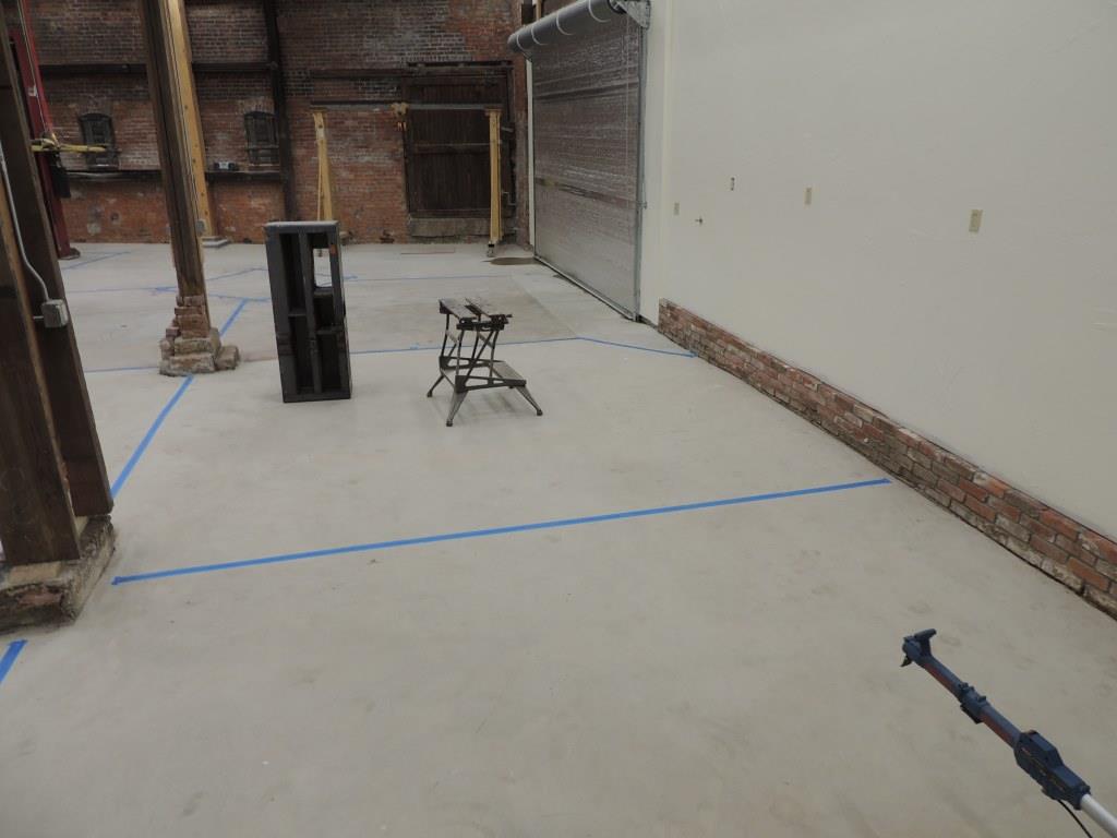

Rest of prep photos.

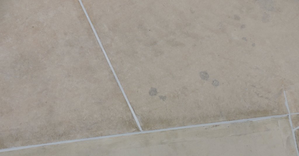

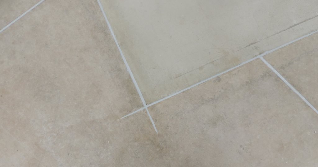

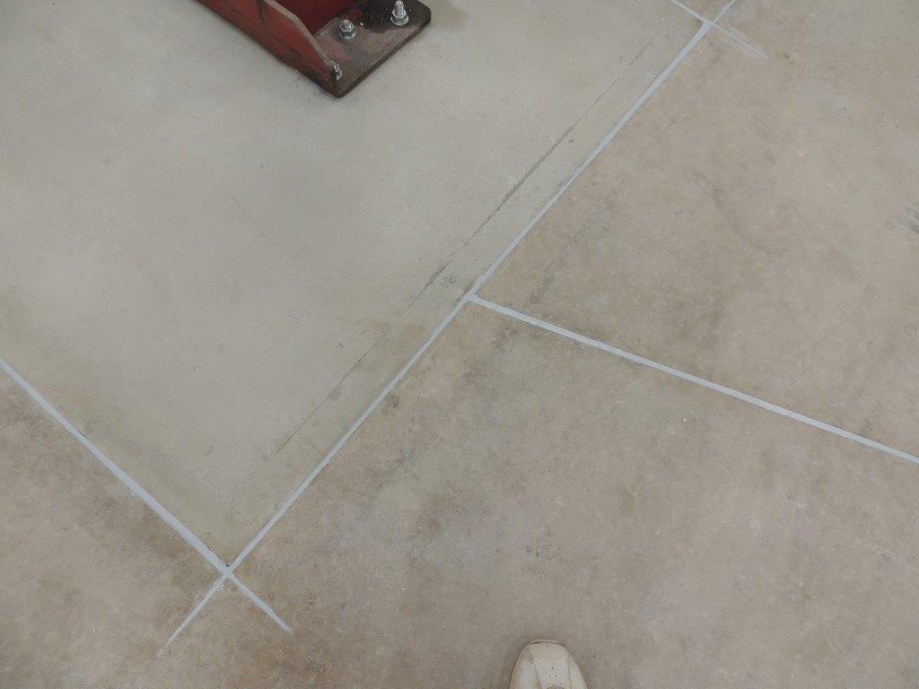

Here are some pics of the finished joints. Hard to see them in most pics; which I guess is the goal, right?

Lynn, did you use a self leveling caulk

No. My buddy the floor expert recommended NP-1.
I followed this guys procedure with a couple of changes. https://www.youtube.com/watch?v=lBc2SXiEtd8&t=1058s
1. I did not use any fine sand to cover it. I don't care to have it sanded. I will be using a floor scrubber to keep the floor clean, so skipped the sand.
2. I had a hard time getting the exact amount of caulk in the joints, so slightly overfilled; then dry tooled with a plastic putty knife (NOT a curved caulking tool), wiping off the excess as I went along.
After dry tooling I DID go back over it using the 409 as a lubricant, and it REALLY smooths it nicely.
