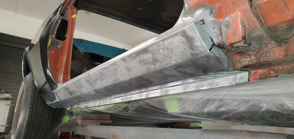

Old 02-15-2023, 03:56 PM
Canuck's Avatar
Canuck Canuck is offline
Join Date: Jun 2005
Location: Vancouver BC
Posts: 1,918
Thanks: 242
Thanked 745 Times in 248 Posts
Work continues,nothing to get excited about. High spot near back of roof reworked.
Rocker panels had a few bruises, all metal worked back to straight.
Former lead seams now done in Fiberglass.
Let’s see what tomorrow brings.

  #80
Old 02-17-2023, 03:42 PM
Too Many Projects's Avatar
Too Many Projects Too Many Projects is online now
Join Date: Oct 2020
Location: Town of Troy, WI
Posts: 5,010
Thanks: 2,620
Thanked 3,849 Times in 1,741 Posts
Nothing to get excited about ??!! Who are you kidding, the metal work alone is perfection. I WISH I had a person to do that, instead of all the filler work most throw on and call good. I have a bodyman working on my Camaro and he filled the lead seam with the same, short strand, fiberglass. Unfortunately, as a production person, he doesn't see the need to do perfect metal finishing and uses too much filler, in my opinion, to get everything blocked out.
