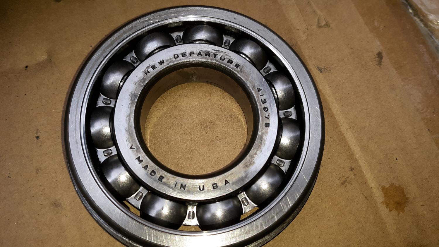

Trans inside super nice showing alot of factory markings. Original front input bearing cleaned and re-installed. Lock washers for safety, you'll never see them. One thread repair only. Original header panel HAMMERED! D

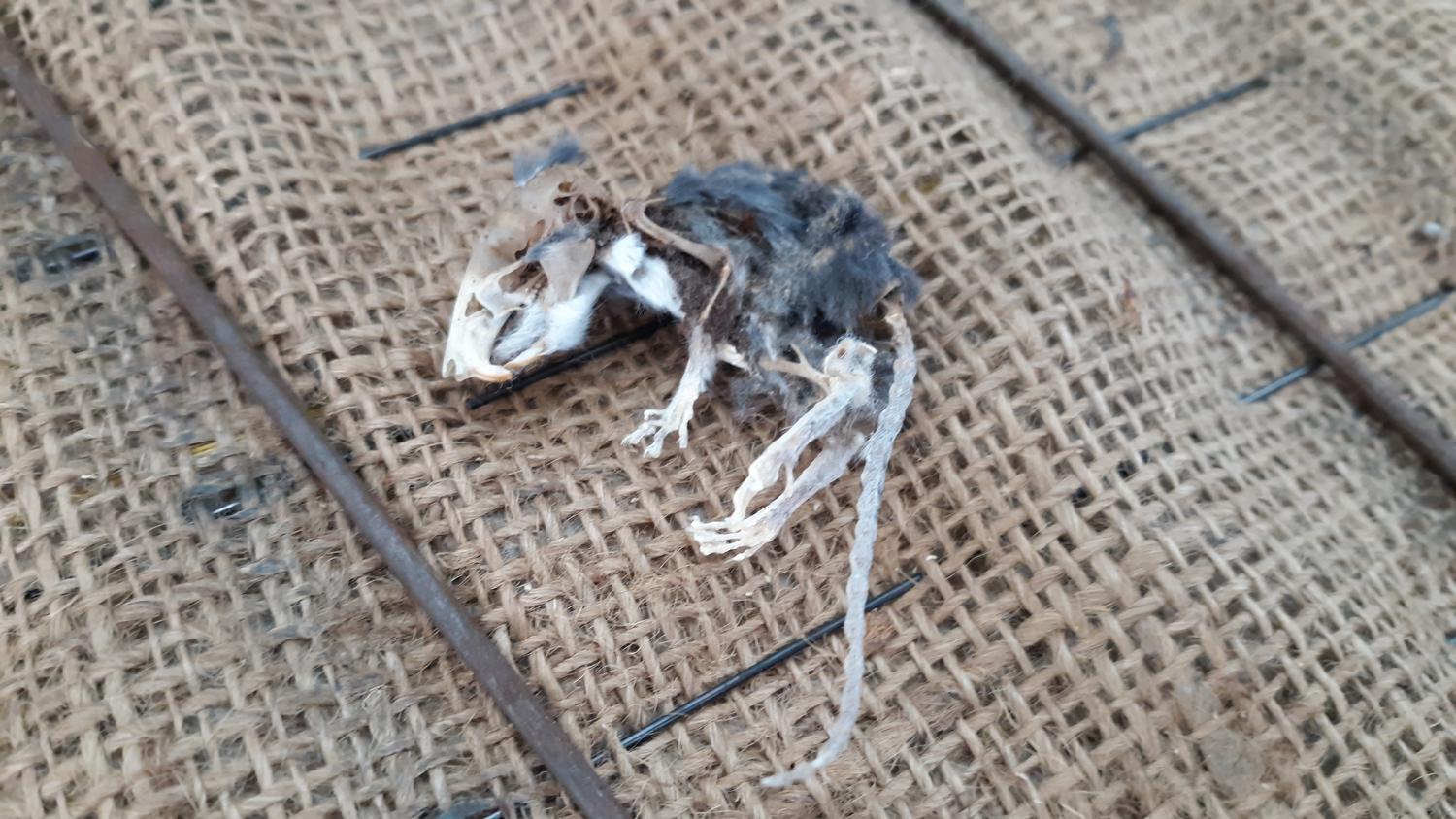

Fan dated July of '68 ...Little creature had a snack. Plastic fan blades. He ate too much, he looks sleepy. SSHHH don't wake him D
