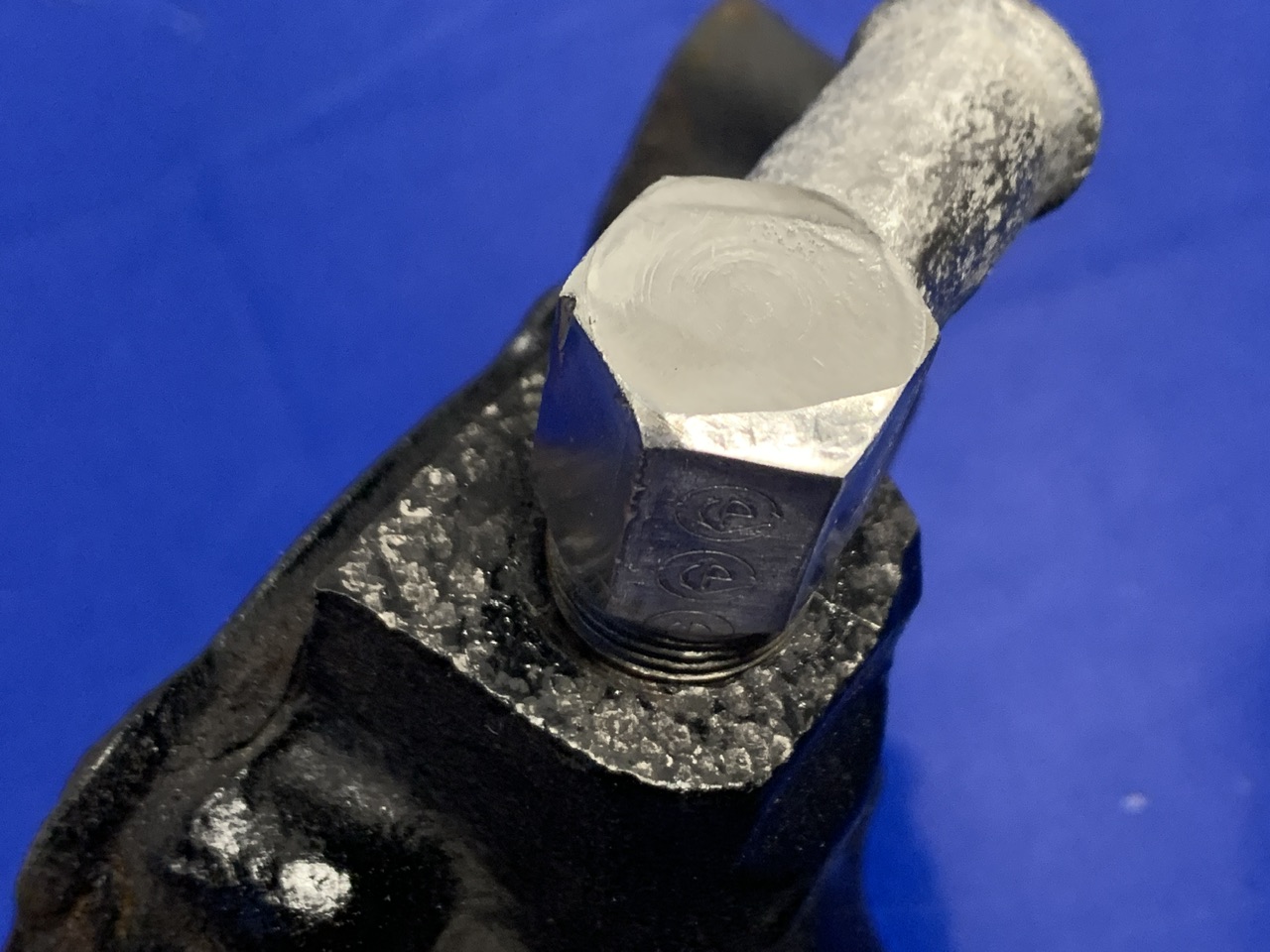

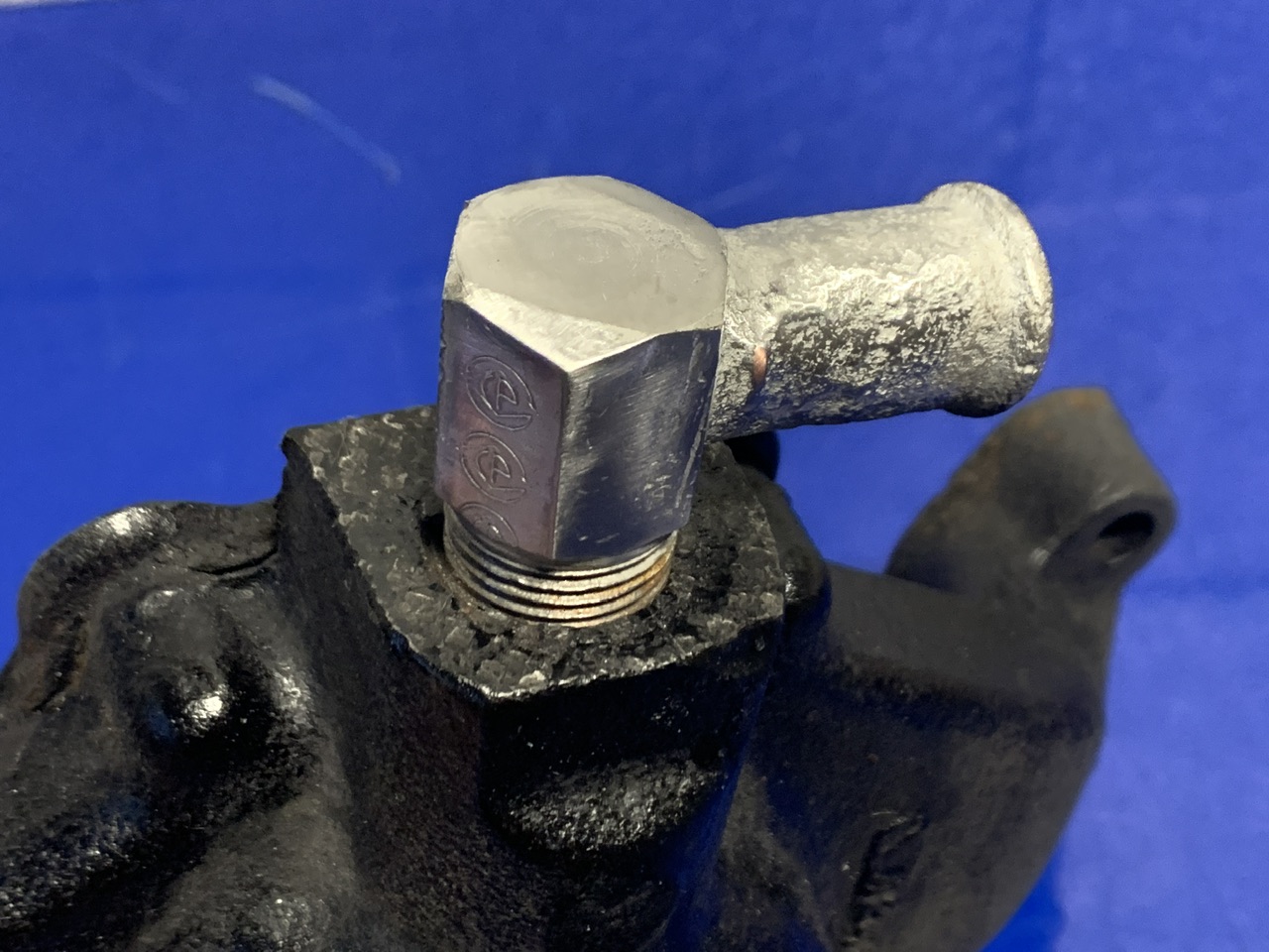

Photos 472 - 474 - Snagged a hex head fitting off ebay and it arrived the other day.

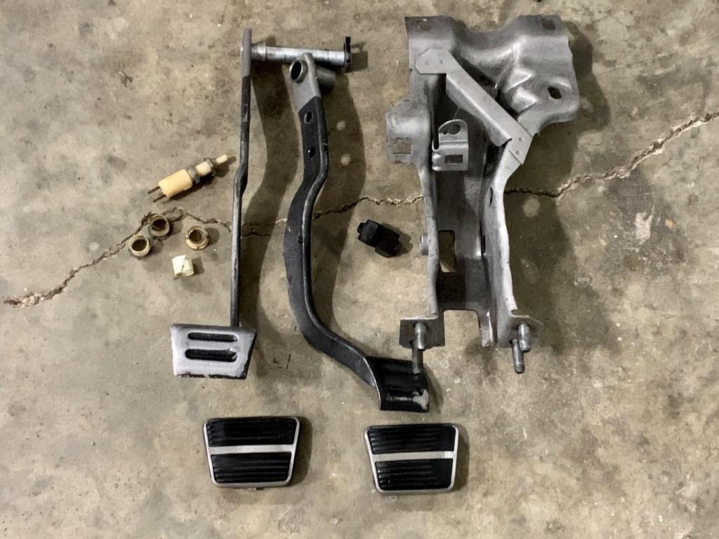

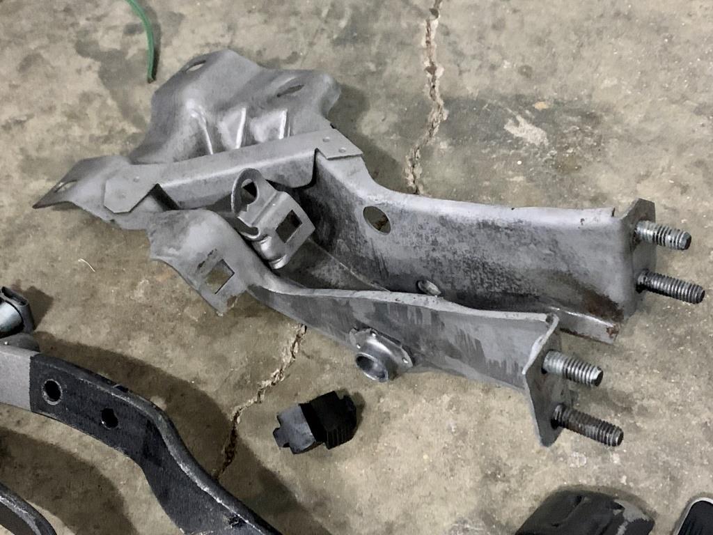

Couple more items off the to-do list. Clutch & brake pedal assembly and main interior harness.
Photos 489 - 490 - Before soaking in Evaporust and after cleaning with citrus degreaser and scotchbrite pad.
Photos 491 - 494 - After Evapo but before treating with RPM (Rust Prevention Magic)

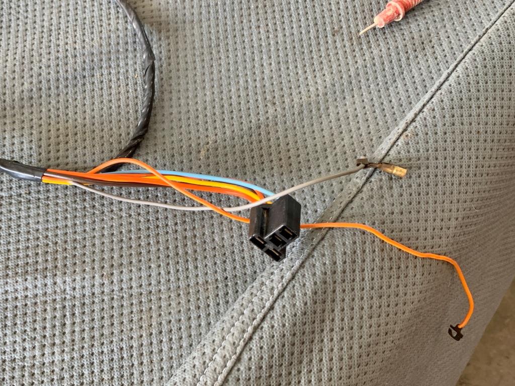

Photos 495 - 496 - Wiring harness after cleaning

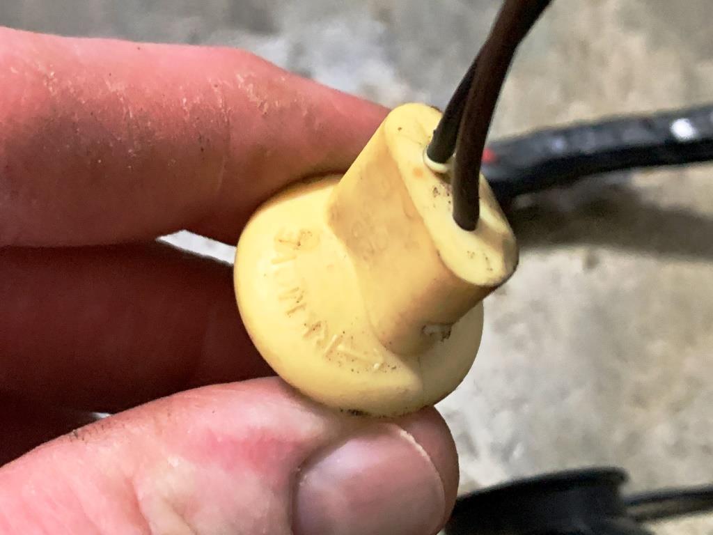

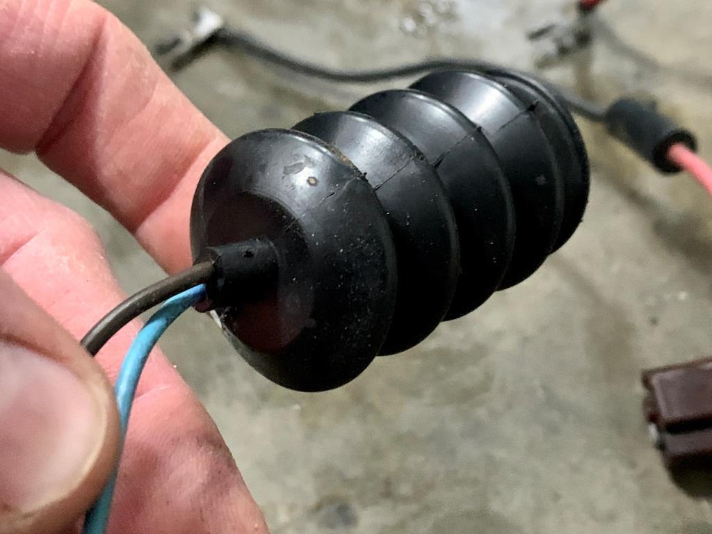

Photos 497 - 498 - Here's something interesting. The pass side door jamb switch.

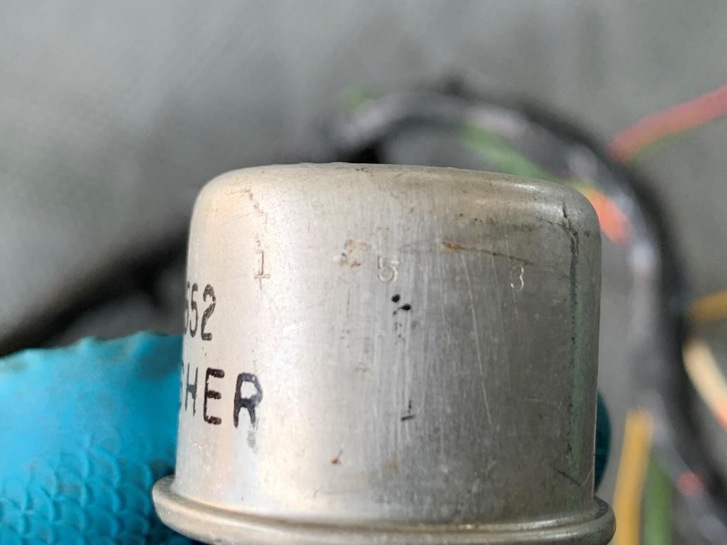

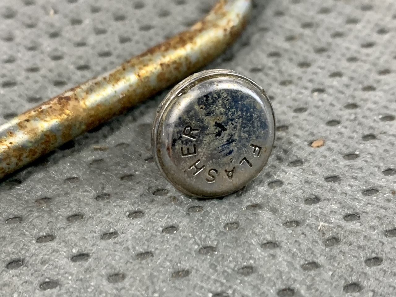

Photos 499 - 502 - Last of the wiring harness. I still need to clean the fuse box itself but the harness itself is ready to go. Anyone cracked the coding on the sides of the flashers? One is 7 4 5 and the other is 1 5 3. If I were guessing it'd be 67 - 45th day and 71 53rd day.?. But I hate assuming.

To round out the clutch/brake pedal assembly are the master cylinder pushrod, clevis & return spring.
Photos 503 - 506 - after soaking. Note the manufacturer’s crest and the stamp.

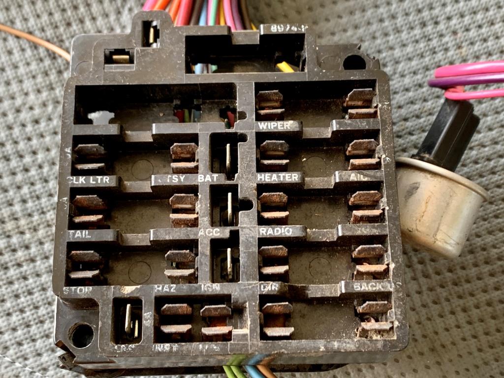

Small updates. Cleaned the fuse box and reinstalled what fuses were in it when pulled from car. Replaced the starter wire from a spare harness I had. Repair was done with interlocking the wire ends and soldering the connection then covering with heat shrink followed by wrapping the wires back with original style tape. The ends were crimped and heat shrinked as well. Also applied a healthy coat of RPM (Rust Prevention Magic) to the pedal assembly and reassembled.
Photo - 503 - Fuse box before
Photo - 504 - Fuse box after with fuses installed
Photos 505 - 506 - starter wires repaired and a comparison to original.

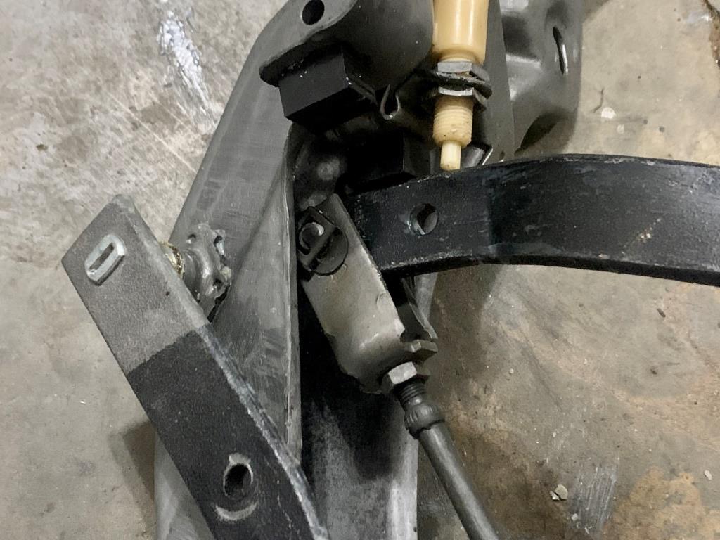

Photos 507 - 509 - Pedal assembly protected and assembled. Note the pedal never had the bracket that goes on the pedal for the brake light switch which I believe was a later addition into production.

Darrell, what was your method for cleaning the fuse block? You've brought that back nicely! - Bill W
  #150
Old 02-22-2023, 02:50 PM
cook_dw's Avatar
cook_dw cook_dw is offline
Join Date: Oct 2003
Posts: 4,383
Thanks: 671
Q-tips and rubbing alcohol. Just be careful around the ink printing on the face. As you can see I lost some of it on mine. Then Meguiars rubber & vinyl protectant.
