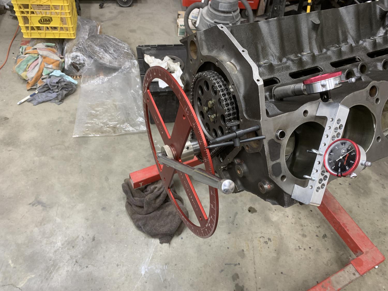

Dereck Degreed the Cam.
I always use Cloyes "Hex Adjust" chains in my engines. You can dial the cam in exactly. This is a Crane solid 396 425HP spec cam (I think its exactly the same specs as the 375HP). I Reused the cam that was in the engine as it all inspected perfectly and I had marked the original position for each of the lifters. Plus no break in drama or worry about a bad core. Some of Dereck's fancy tools !
