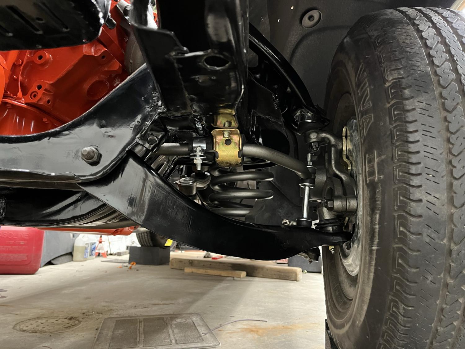

Funny story... How long does it take an Aviation Field Service Technician and a Mechanical Engineering Technologist to install a Nova front sway bar.
All my years of playing with Novas and a few Camaros and I didn't know you have to put the bar in place BEFORE putting in the coils.
Had to split the lower ball joint on one side and remove the caliper rotor and backing plate on the other side.
Now I know !!

Just Awesome! Plus the lower control arm bolts are installed correctly too! I often see them facing the wrong way.

Should have installed the sway bar before you dropped the engine in place. I'm sure it would have gone right in. Doing a great job!! Can't wait to see it done.

Curious if you had the car sitting on those risers when you attempted to install the bar. I have swapped bars in first gen Camaro's with the suspension hanging free and they are tight, but do go in.
