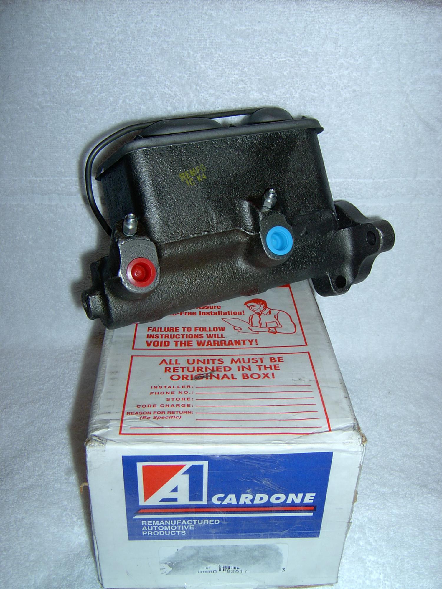

Now looking for 1970 MC Rebuild KIt that contains BOTH Pistons and Rubbers...
Measures 1 1/8" Bore
All kits Ive looked at Dont list 1970 application ????

I could not find MC Rebuild Kits at RockAuto.com......I saw several brands of Aftermarket
Complete MC's....
Am I to buy a complete unit and xfer the guts into my 1970 "409" casting, EB stamped Housing ?????
