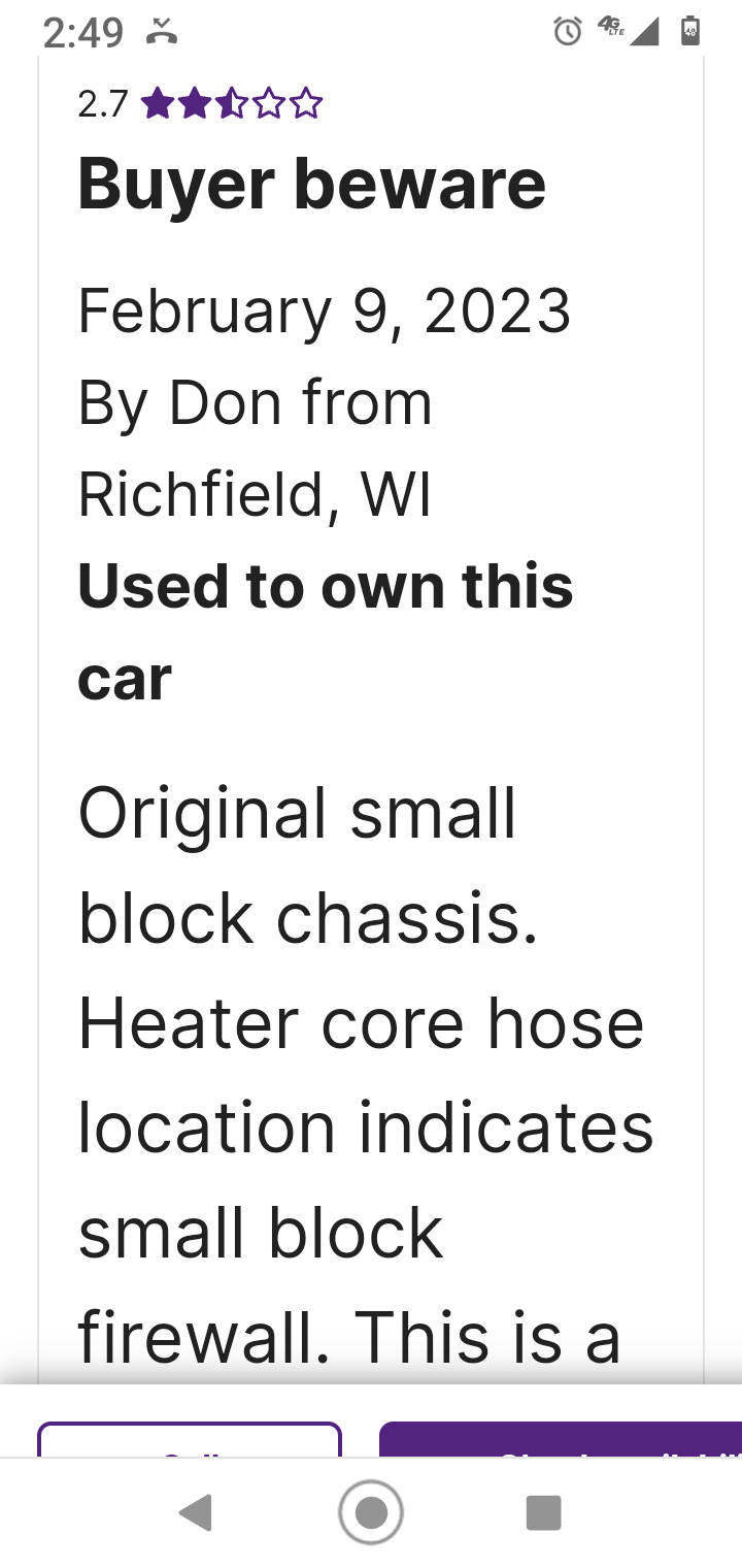

Hello
Does anyone have any historical info on this car?
This car is for sale but I cannot find anything searching the VIN.
If it is in fact a Berger COPO I would assume someone would know about this car.
124379N648976
Daytona Yellow 711 interior.
Thank you!

124379N648976
The above VIN is included in the registry and the VIN and trim tag fit the sequence of other Berger built COPO Camaros.

Default 124379n648976
Haven't seen the trim tag, but the vin# is a Berger car that belonged to Mike Riley for years. Contact me if you have a picture of the trim tag. This definitely looks like Mike's car

Anything look odd about the rivets ??
And all those pics and claims that it's a 427 car and not ONE pic under the hood ??? Isn't that what all the attention should be directed too ?

The rivets look trimmed down or they’re just wrong. I’d be sleuthing.
That dash pad looks to be an repo from the early 90s, like the one in my 68. A used original core is obviously longer on the top and would cover the rivets.

Is that a replacement dash panel with the square corners around the vin?

Yes it is. That would explain the rivets being replaced. As long as the vin matches the hidden partial(s) that really isn't that big a deal. Many 69's needed the dash panel replaced.
