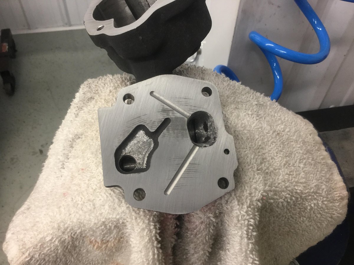

Those pictures were taken while it was being assembled but do not show the changes that were made after the fact. What was seen and taken in that shot was a stock Moroso 24350 deep pickup that was purchased with a Moroso 22111 pump and was planned for use with a Moroso deep pan. We didn't like that Moroso pickup or the pan so it was changed for a Milodon kick out Pan and Milodon deep pickup that I had kept aside for another build. We then changed out the pickup and the pan for the Milodon parts and it was all clay modeled and clearance fit to the new pan after this picture was taken. I kept the Moroso 22111 HV pump and which was previously disassembled and blueprinted before being mocked up.
Here are a couple of pictures of the Moroso pump taken apart for blueprinting and prior to installation. Also shown below are a couple of pictures of the Milodon pan used after the fact. I still have this motor and it is now going into my current 69 Z build.
