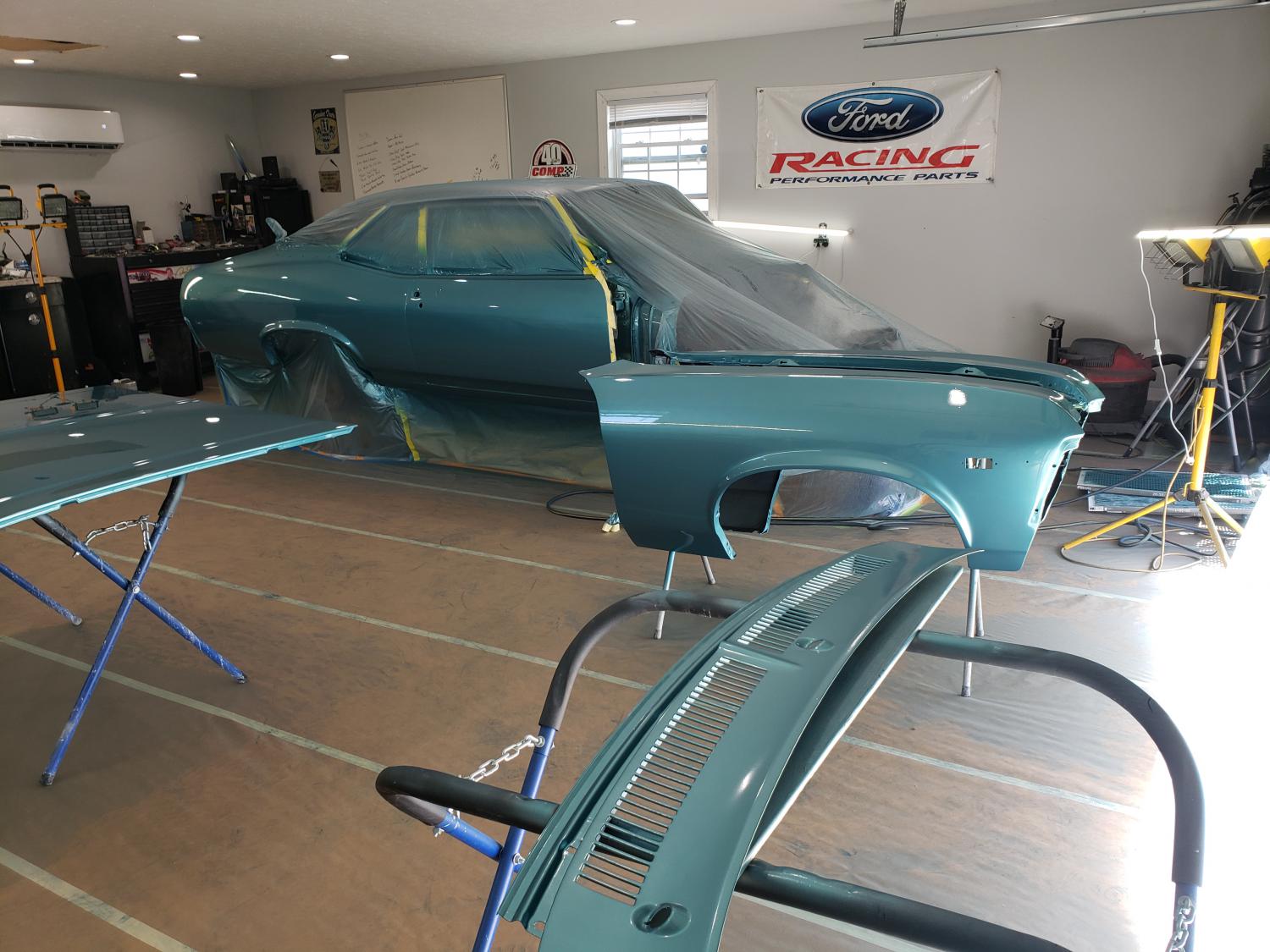

Ok , so pushed the car out side and cleaned the garage again and added new paper to the floor . Re-masked the car again as the time had finally come for some more color to be applied .

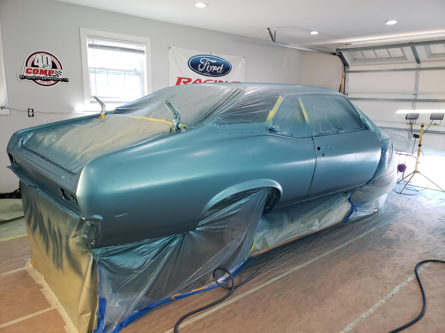

  #83
Old 06-20-2023, 07:14 PM
Crossbreed383 Crossbreed383 is offline
Join Date: Jan 2015
Location: KY
Posts: 188
Thanked 330 Times in 89 Posts
Base coat applied . Sherwin Williams K code Tripoli Turquoise

  #84
Old 06-20-2023, 07:18 PM
Join Date: Jan 2015
Location: KY
Posts: 188

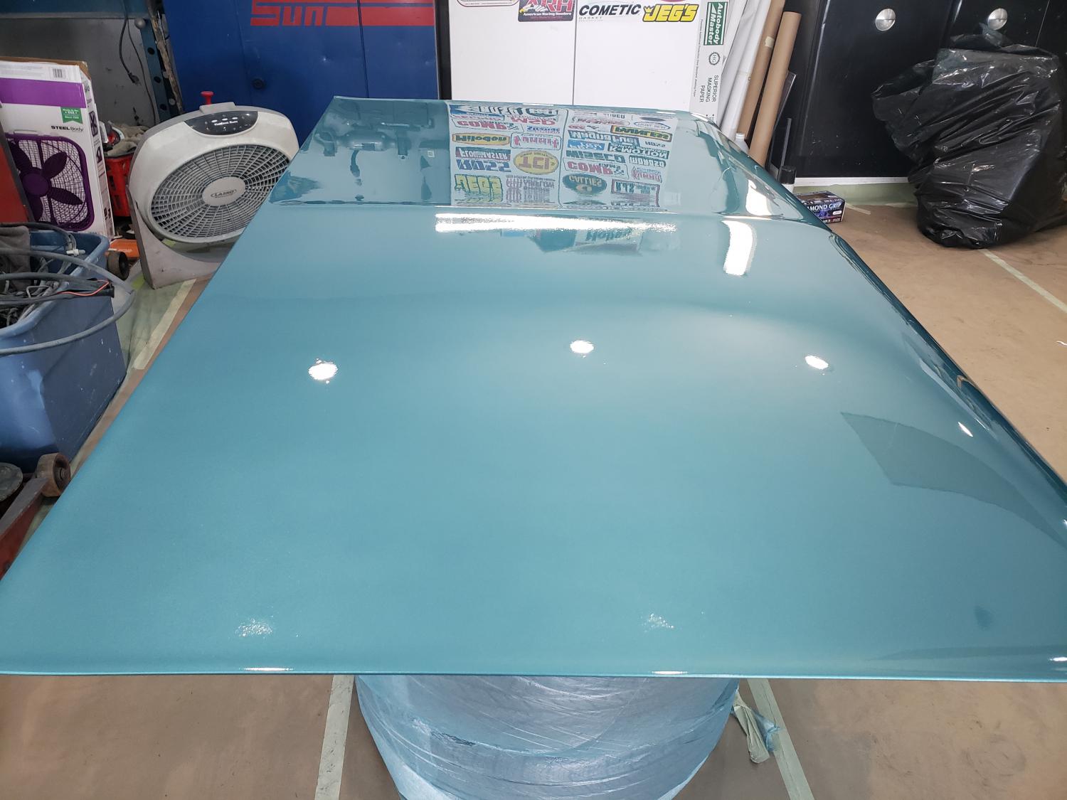

Clear coat now sprayed before any cutting and polishing.

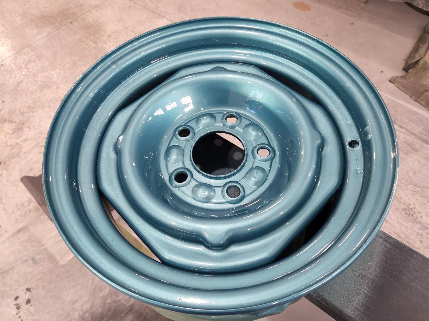

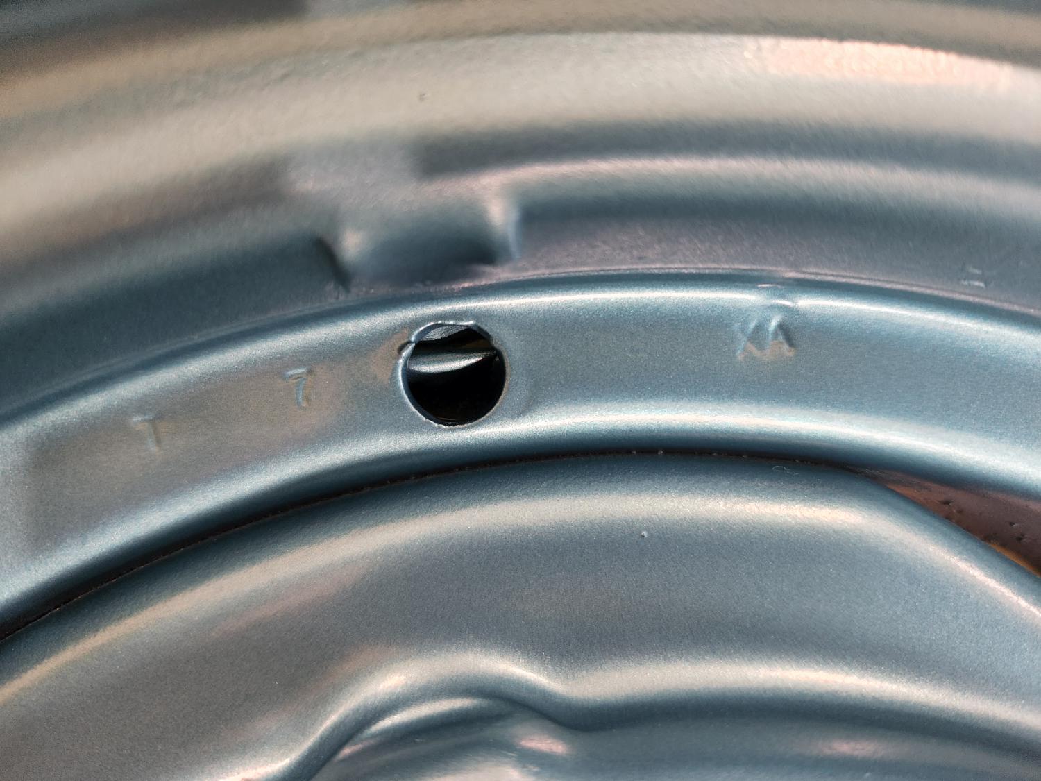

Old 06-20-2023, 08:19 PM
Join Date: Jan 2015
Location: KY
Posts: 188

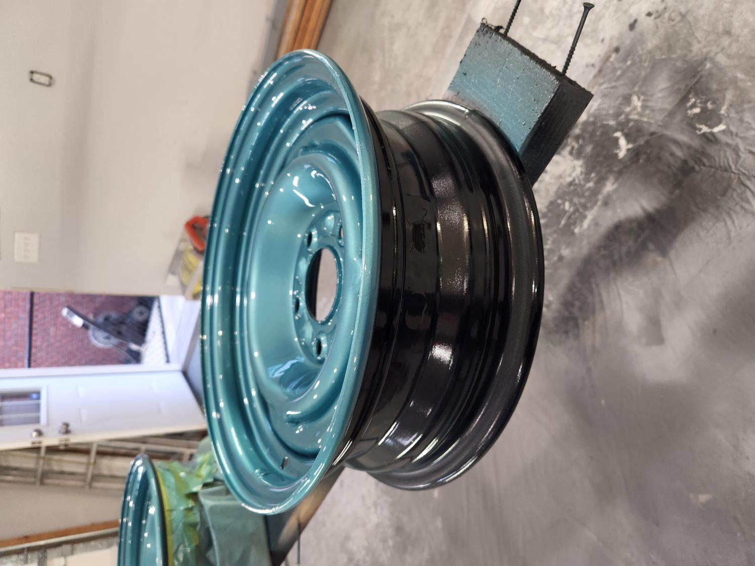

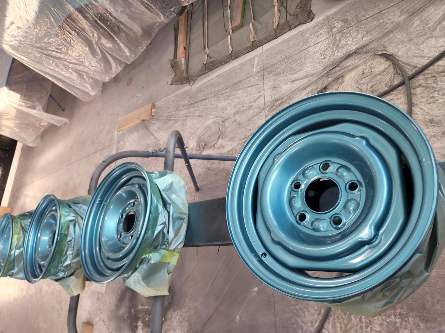

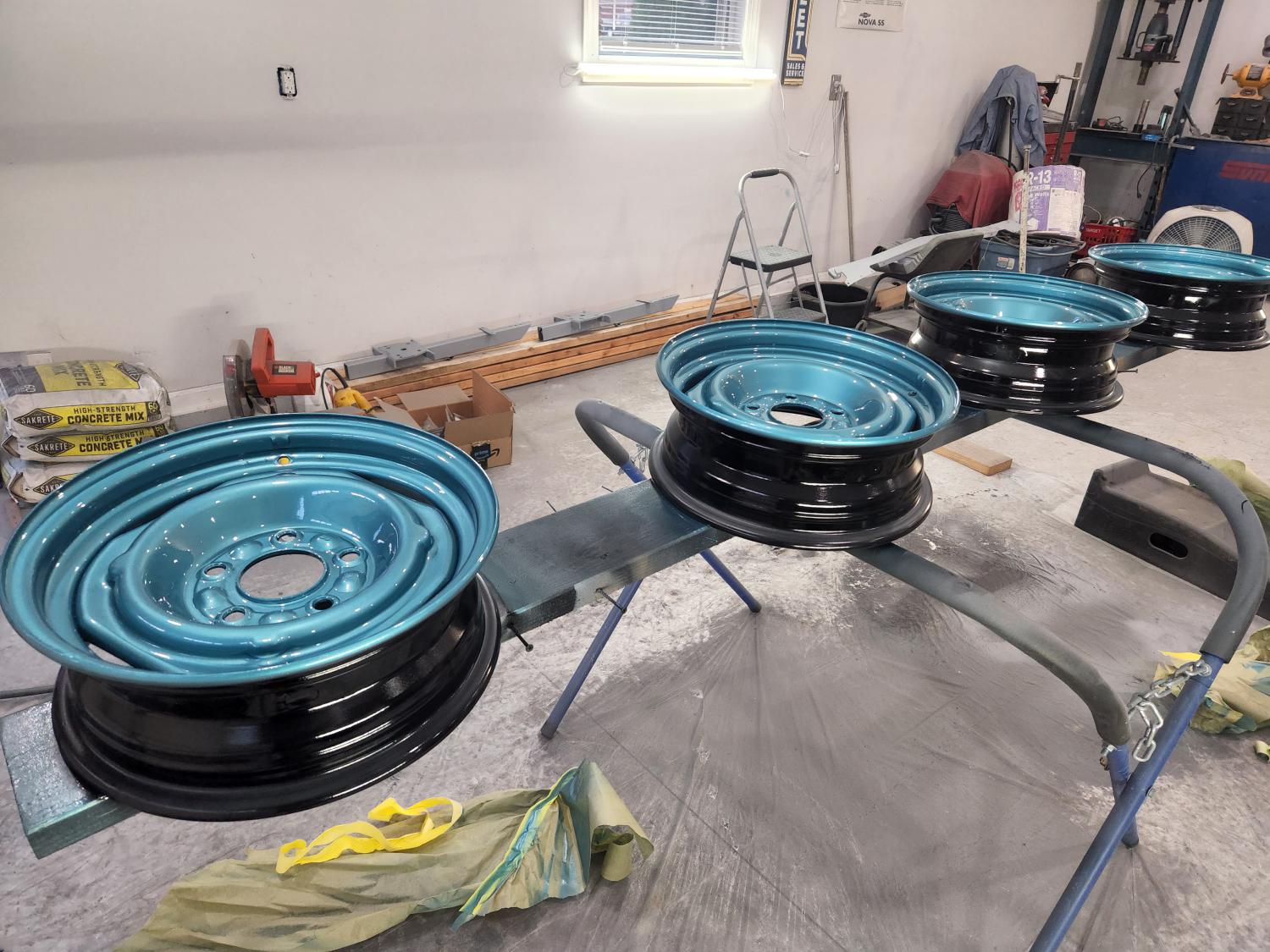

While the paint was curing I changed my attention to getting the wheels restored .
After blasting the original wheels were epoxy primed, then the rear inside and center of the wheels were painted Black. Then the front sides painted body color .

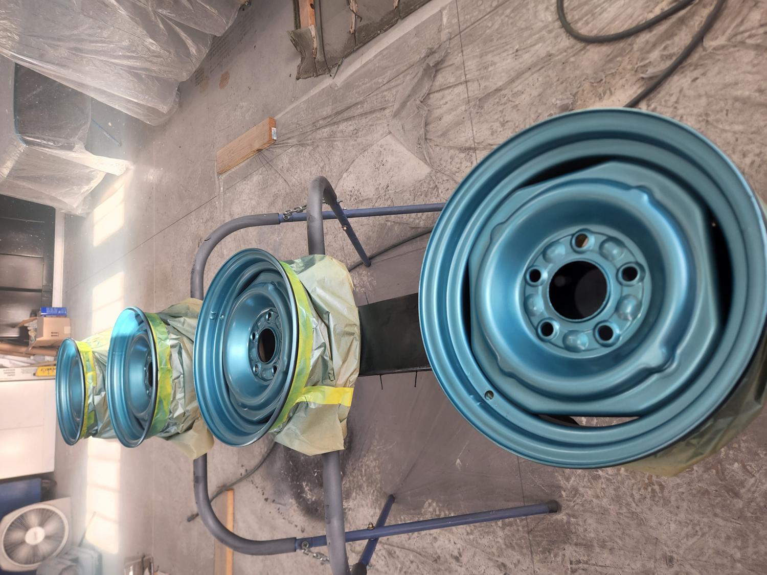

  #87
Old 06-20-2023, 08:23 PM
Join Date: Jan 2015
Location: KY
Posts: 188
Body color on fronts up next, base coat and then clearcoat just like the main body .

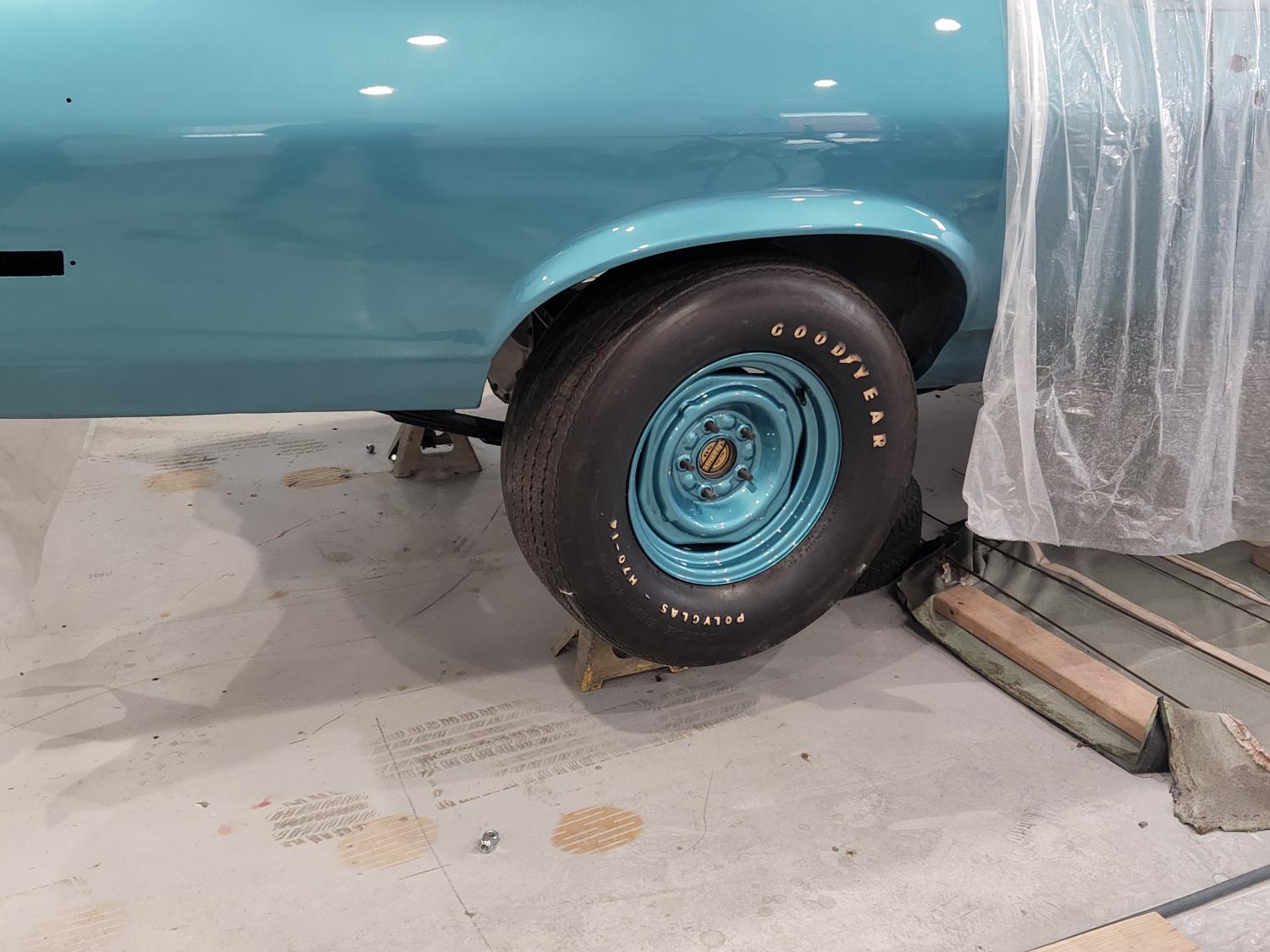

Dykstra Motorsports
  #90
Old 06-21-2023, 01:20 PM
Join Date: Jan 2015
Location: KY
Posts: 188

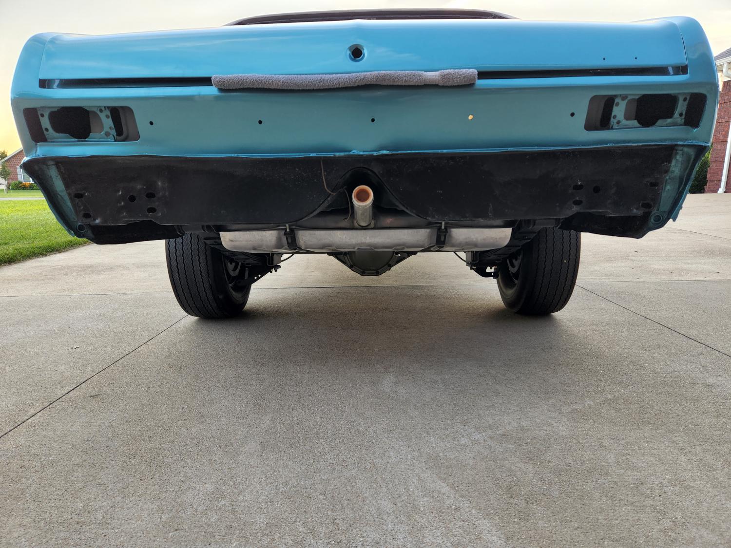

Needed to clean up the garage some, so rolled it out for some evening sun and pics ..
