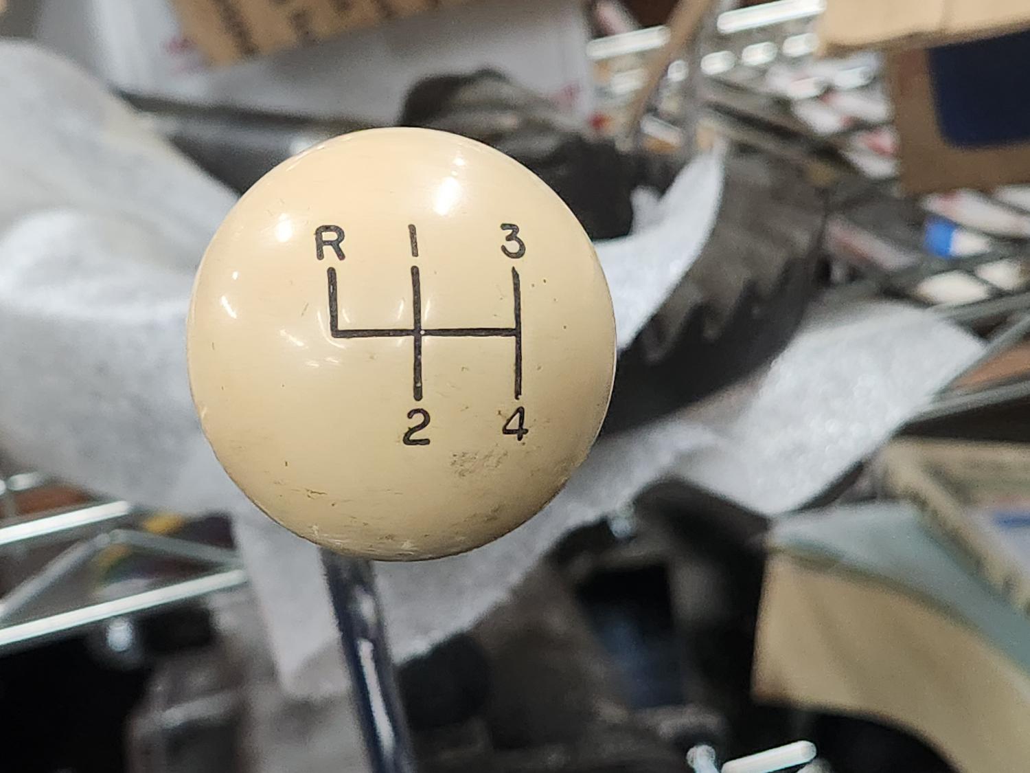

I'm using Crash's custom shifter mount that will allow the shifter to pivot into correct position and accommodate the offset of the big block crossmember. The shifter is a first generation hurst setup with the early fat letter stick. I will need to gently grind off a portion of the reverse lockout for it to fully disengage as it interferes with the shifter mount, so for now I'll go without it.

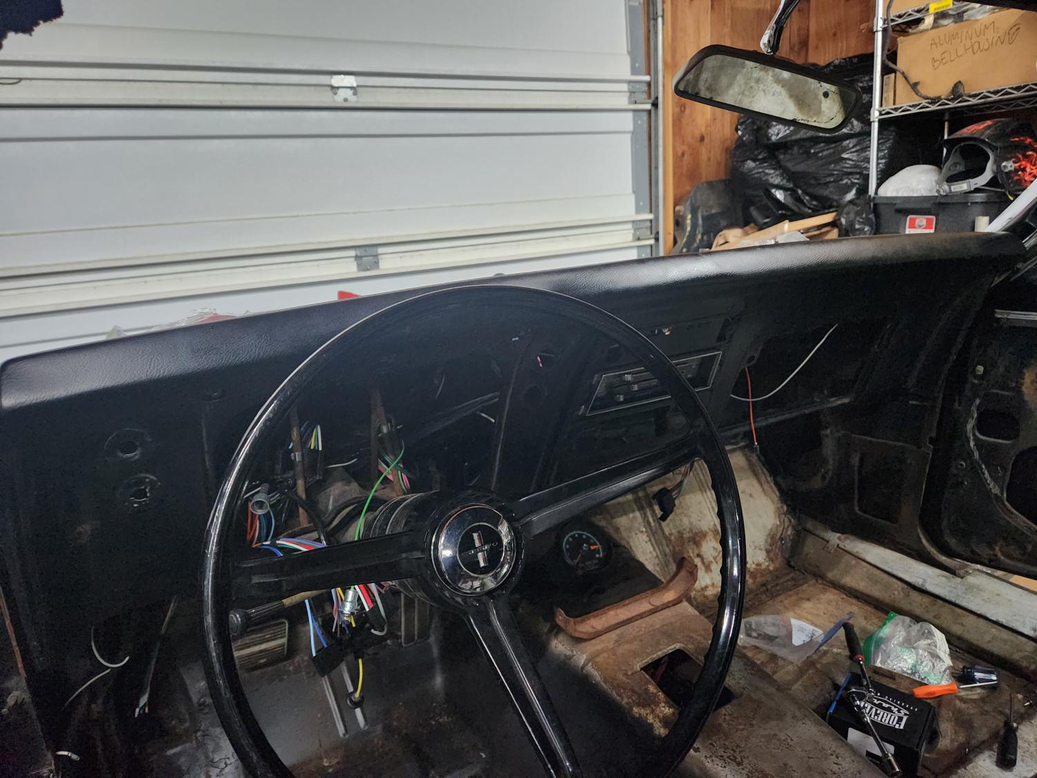

I was able to find an excellent condition original black dash pad and got it installed. Unfortunately, I found a factory flaw where the dash was installed about a 1/4" higher up on the LH A pillar vs the RH side so I'm fighting to get the LH a pillar molding fitted.

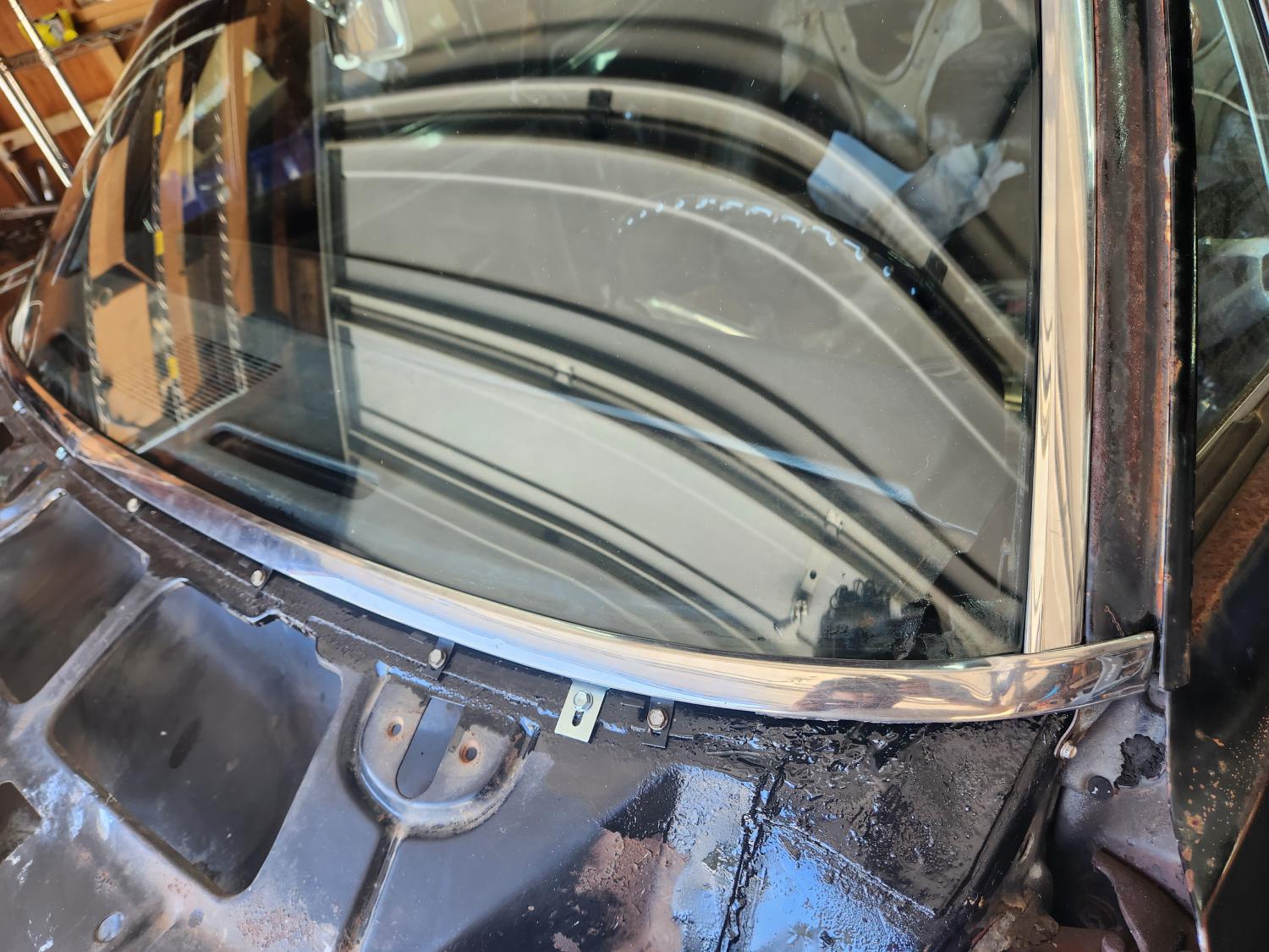

I prepped the windshield channel for glass and had a local installer get it done. I decided to go with urethane as I feel it helps improve the integrity of the body. The install is guaranteed leak free for life. I bought tinted glass with date NZ (January 1967) This matches the date of the back glass. All glass on the car is original with exception of the windshield.

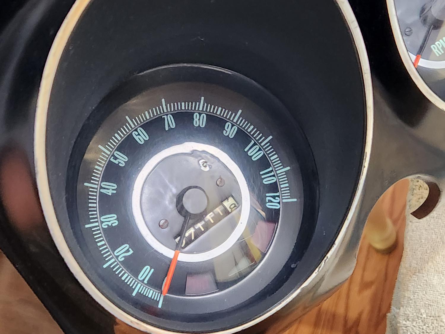

Disassembled, cleaned, and reassembled the original cluster assembly. A little over 97K original miles.
I swapped the black housing to a better condition spare original gm one I had on the shelf. I also swapped the circuit board as the original was fried. I installed all new bulbs and can't wait to see it lit up.
