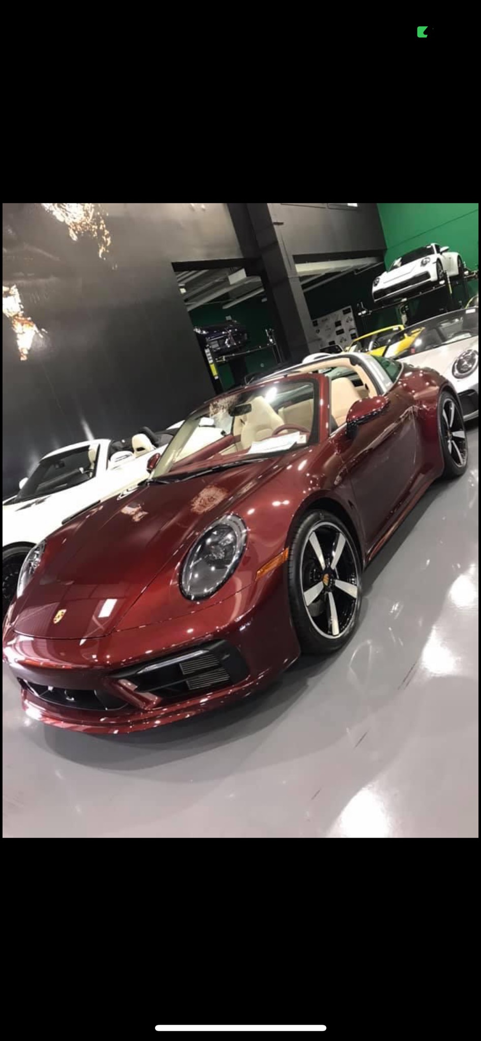

Just to muddy the waters further for you Dave, I had a 944 like the one below and Sapphir Blau was a great color, and since Charley put up that 911 with the red interior, I thought I'd add that as well, and for the finale, the Special Edition 911 in burgundy and tan interior is just an extra possibility.
