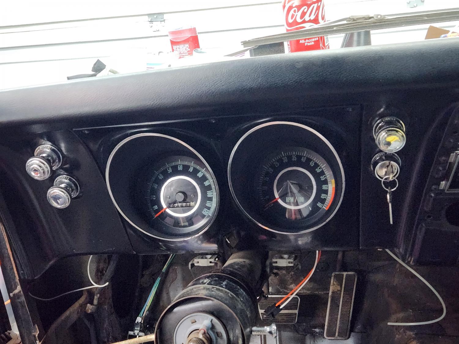

Gauges are in.
In 67 the low fuel lamp socket needs to be installed below the circuit board as the fuel module sends a positive signal. I believe a previous owner didn't realize this and fried the board. This also explains the fried wire coming from the original console harness.

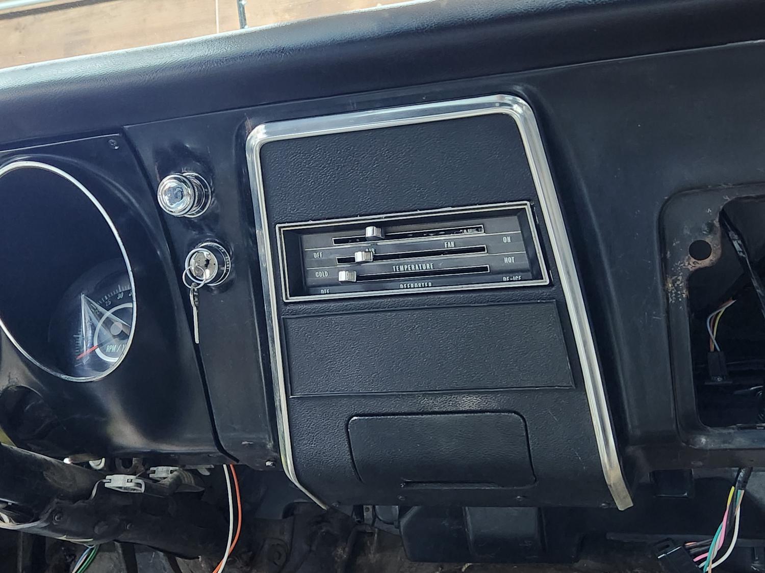

Trim plate, radio cover plate, ash tray assembly installed. All used original GM parts cleaned with soap and water before install.
