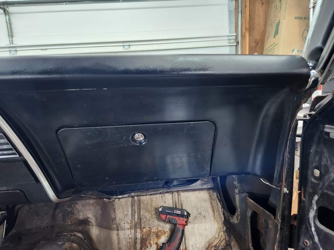

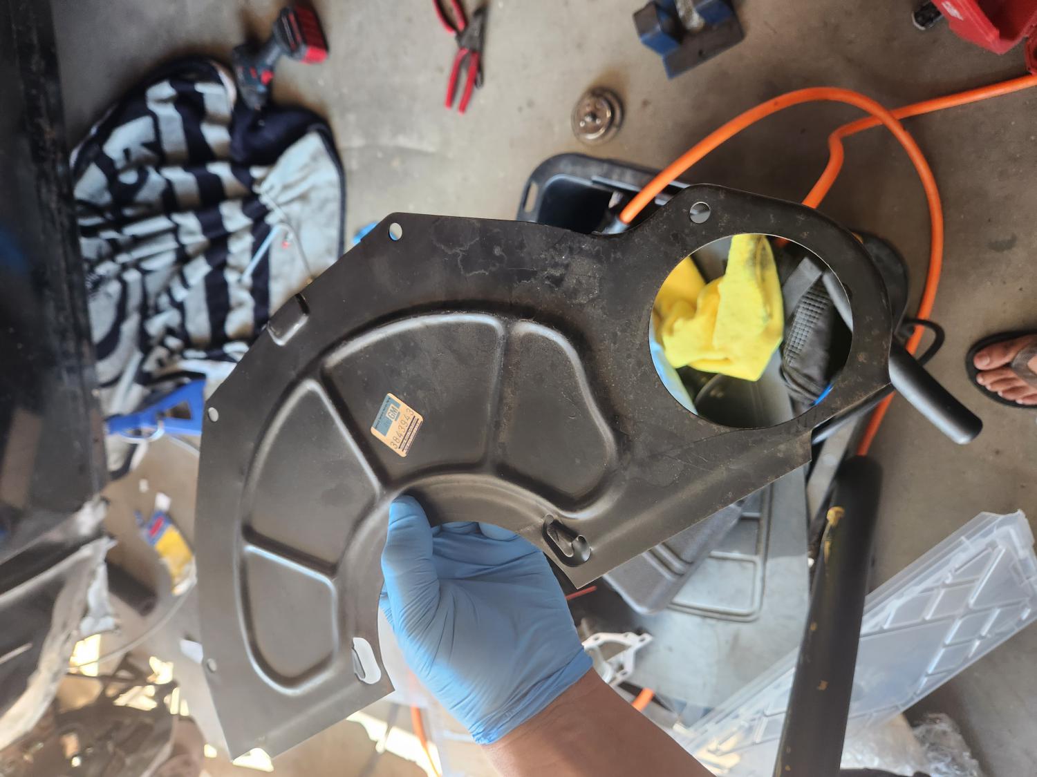

A while back I found the perfect glovebox door to replace the damaged door on my car. I'm going to repair the original down the road.
There was a screw holding my original glove box closed but thank goodness the screw actually went through the hole for the glove box bumper so there was no damage done to the dash.
Part of the fun of putting this car together is finding the right parts and I've been very fortunate. The replacement door came from an Ohio 04C 4N car that was sold as a shell. The buyer didn't care to buy all the loose parts from the car so the seller sold the loose parts separately. I was able to buy a few parts from the car.

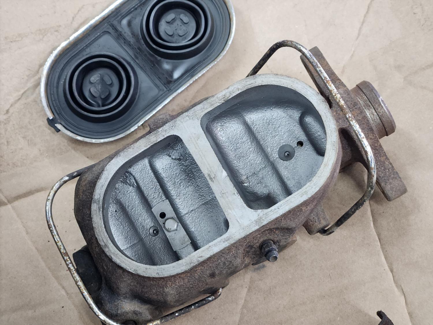

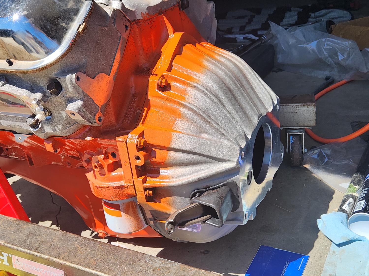

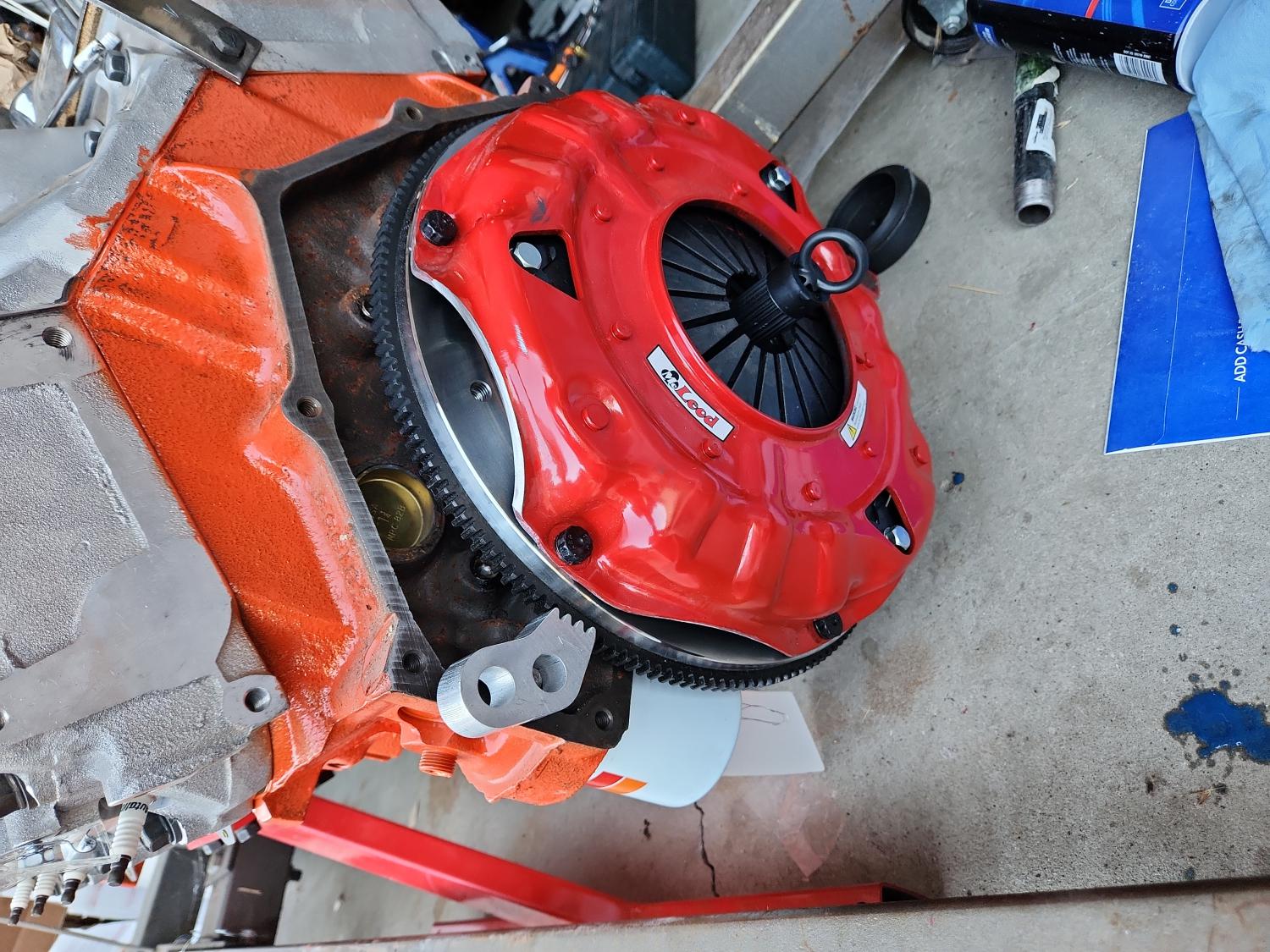

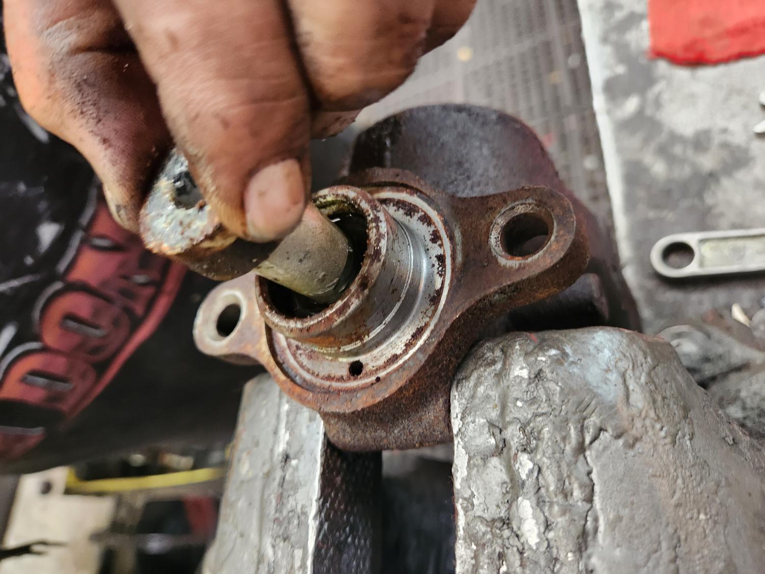

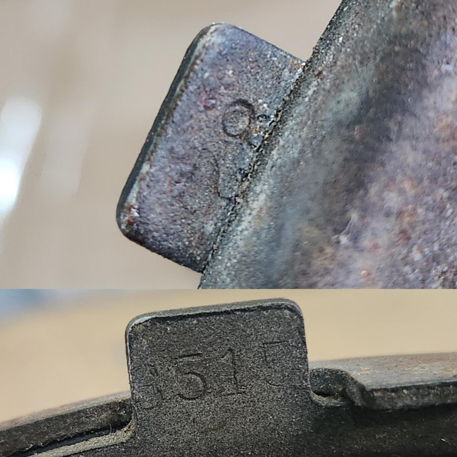

More progress. 621 is a repop I bought a few years ago machined very well. Inspection cover is GM NOS along with clutch fork.

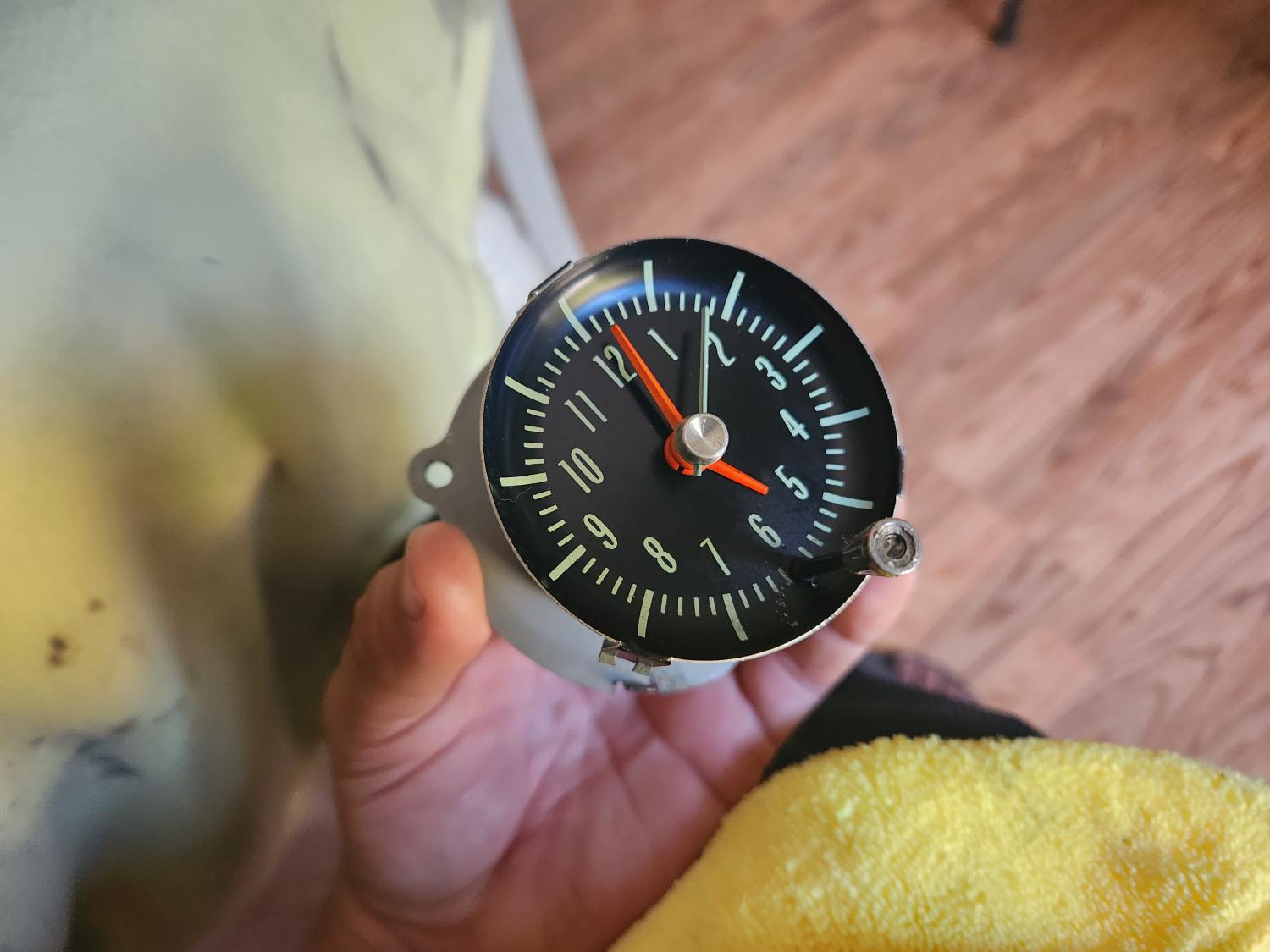

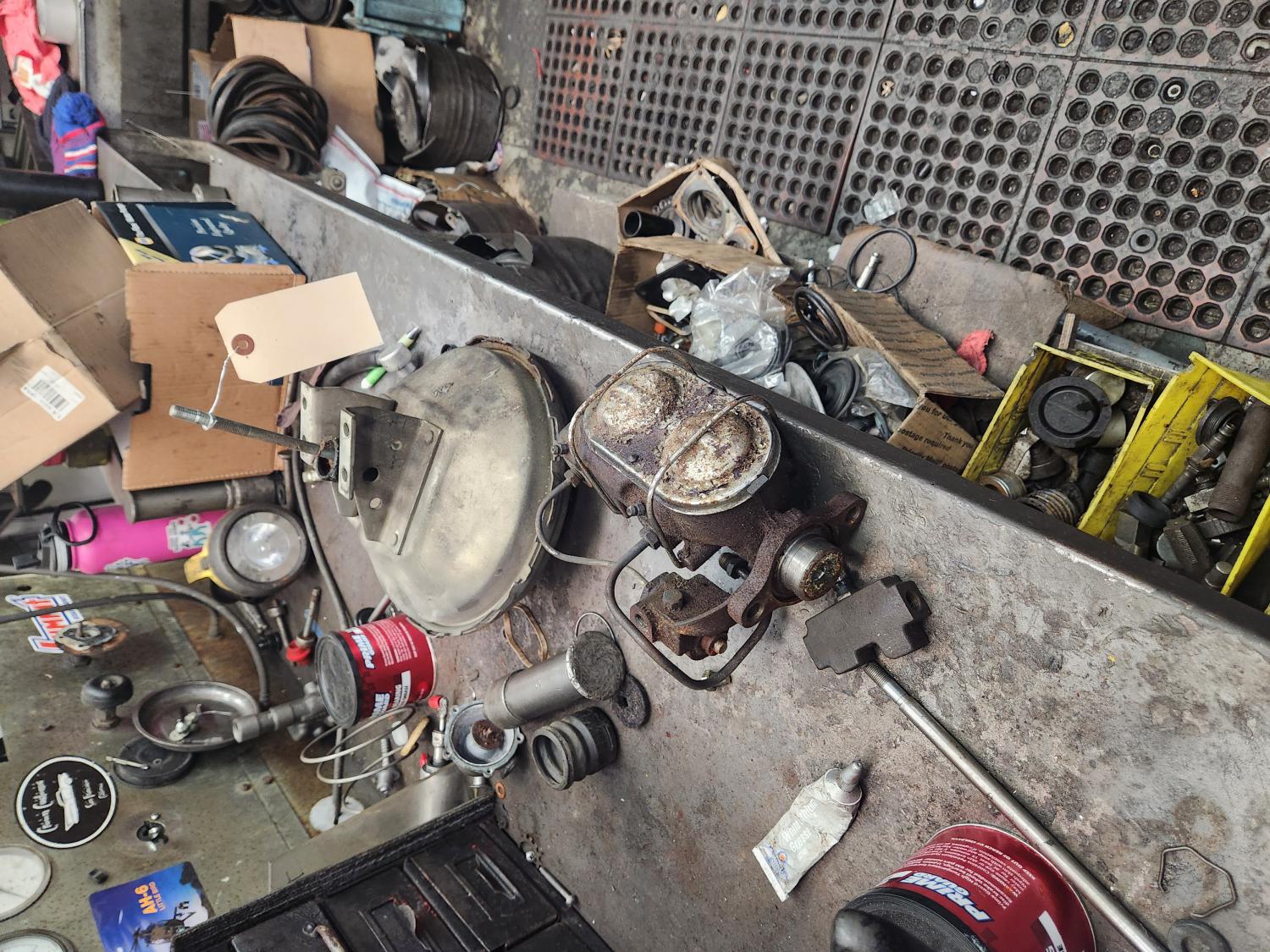

Cleaned up original gauge housing and replaced fried gauges with a set from a spare. Clock being sent out to tick once again. I pick up original brake parts tomorrow from being rebuilt internally. This included 82 date booster, wt master, and both original valves. All brake parts removed from a very close date car, even booster is identical date. Going to drop off the calipers from the same donor car tomorrow as well to be rebuilt.

You may not notice a difference in the before and after photos but I assure you everything is cleaned and rebuilt internally per my request. I'm very happy with how everything turned out. Luckily the master cylinder wasn't pitted and did not need to be sleeved. Martin from Power Brake Exchange in San Jose performed the rebuild of the booster, master, and both valves. When I went to him with my odd request to leave everything crusty he said, "I've been doing this 36 years I know exactly what you are looking to do". He proceded to take everything apart, put it a bucket and it was ready for me to pickup within a few days. I'm considering cleaning the parts with a simple degreaser.

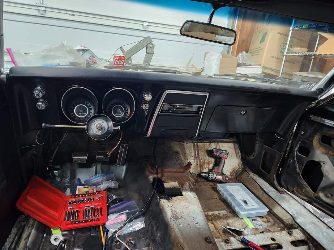

Dash is finally done! 97k original miles, original paint, original gm unrestored parts with exception of the glove box liner (repop) and lock cylinders (restored).
My car was ordered without accessory lighting thus no glove box light.

As said, fantastic job with original pieces..
Have you acquired a donor piece of a tunnel to repair the inline shifter butchery ? Or are you going to use a day 2 shifter in there ?
