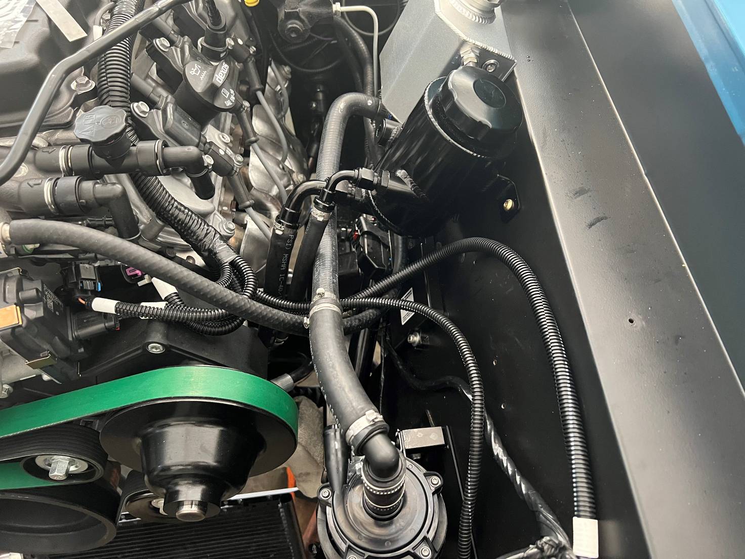

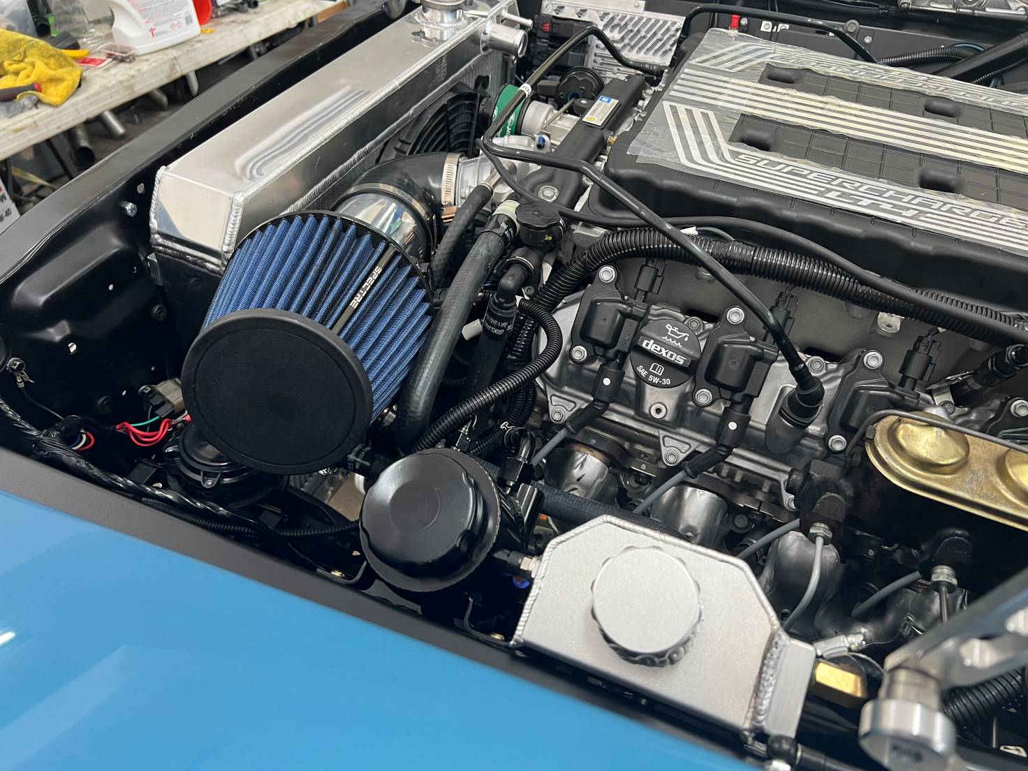

As you can see there isn't much room left for anything ........Just enough for things to fit....here's a pic of the drivers side showing the power steering reservoir and the coolant tank for the supercharger coolant system...
The Air Intake tube just clears the Radiator.........Everything just fits....
The ECM just fits also..... Still have to clean up the old wiring..
